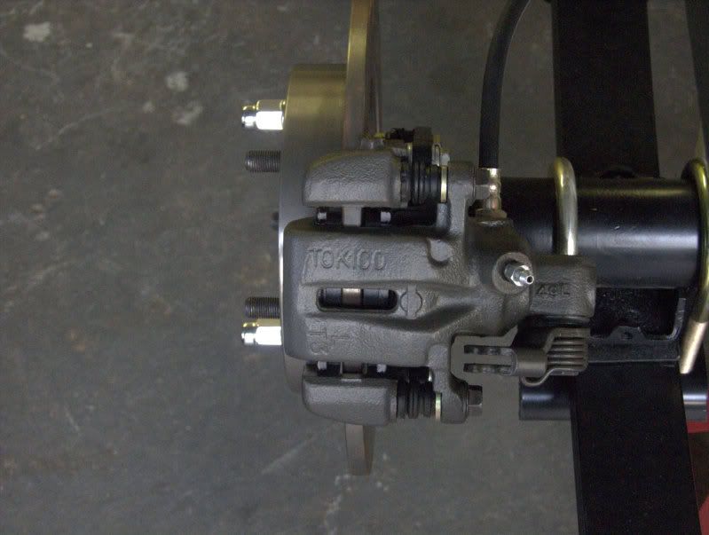

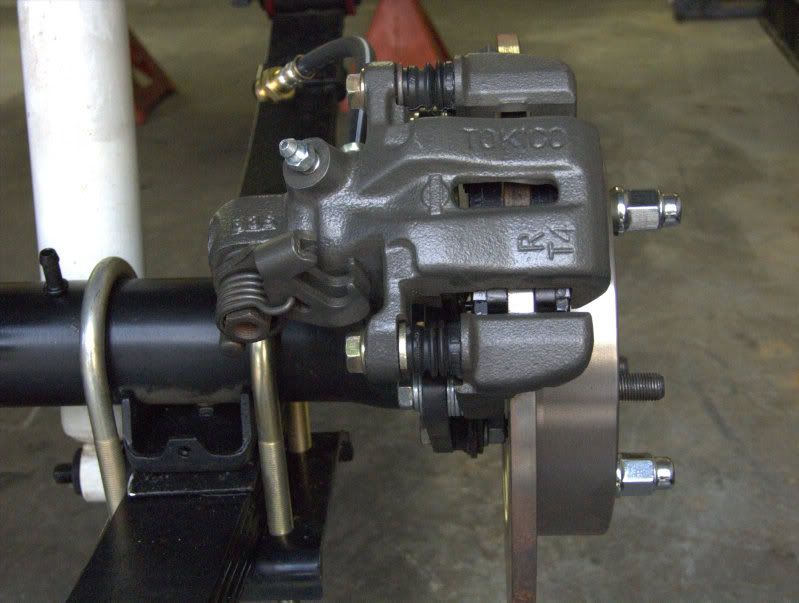

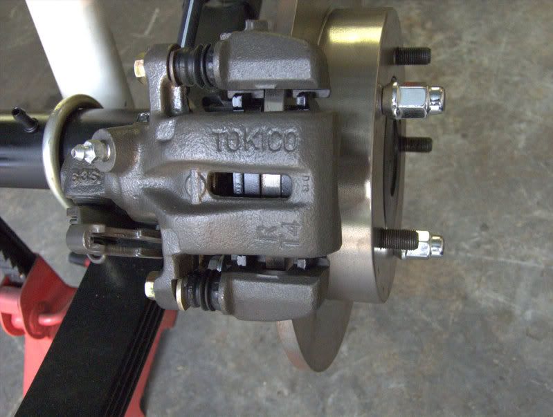

Can't really tell what you have from the pics.
I did this too. Didn't have any trouble getting them to fit over the rotors. The rotors are only 8mm/.315 thick.
The only thing I had to do was use washers(pic 2 & 5) to center the caliper over the rotor.
These have since been changed out with spacers of equal thicknesses.
Posting some pics.
Don't think they will help you. But, ya never know.
300 ZX calipers/Samauri rotors.
Good luck
Posting some pics.
Good luck
And that is one beautiful set up you have, kudos. Yea, i have spacers but i'm not even that far yet. I'm not worried about the spacing between the bracket and the rotor yet, the pads just wont fit around the caliper. Thanks for the replies.

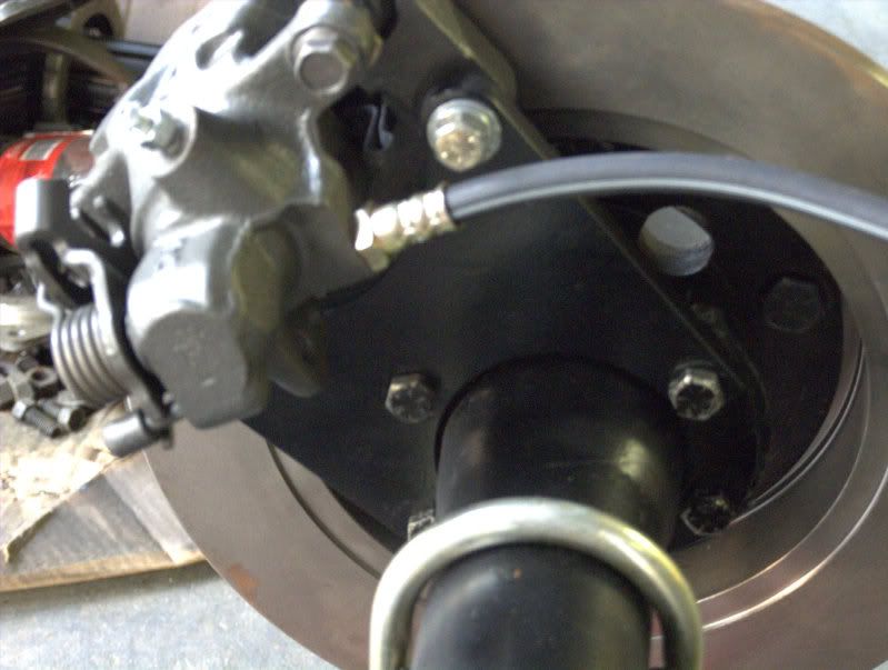

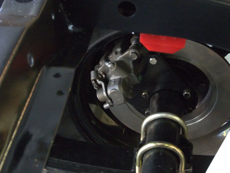

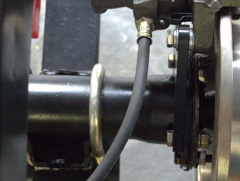

IDK if you can tell from this pic. but i'm not connected to the axle housing caliper bracket. I'm just dry fitting to see if the pads fit around the rotor.

HOLY CALAMITY JANE. I googled the piston caliper, found I could do it with a set of needle nose pliers, and SCHPLADOW. Thanks guys. I was thinking I bought the wrong rotors, turns out, I"M JUST AN IDIOT. FITS PERFECTLY NOW. (i snuck out to the garage while my wife was in bed ITS 11 PM, I could get my balls cut off for that!) Thanks again. I will sleep soundly tonight...... oh, yall know what i'm saying, trying to sleep, "Whats wrong with the jeeP"
