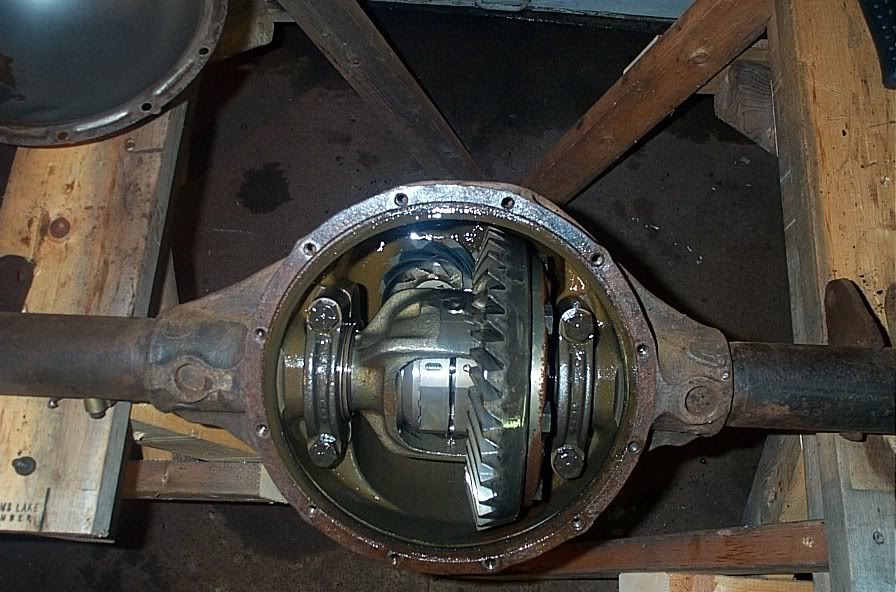

hey everybody. I started to work on my rear axle today. I cleaned it up good and opened up the pumpkin (this jeep was a mystery to me when I bought it ... no idea what was good or not) to inspect. this is what I found
all looks good to me, what do you guys think??
what kind of locker is this?

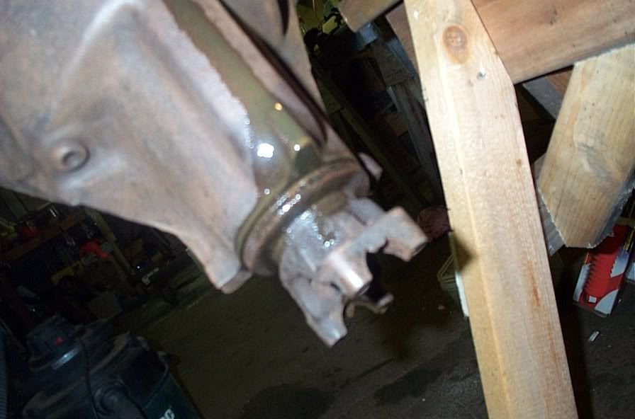

I think theres a leaky pinion seal, I dont know how much leak is too much. and I was wondering if these are changed from the pinion nut side?
I dont want to pull the axles to check seals and bearings at this point. would you recommend pulling them to see? It all seems smooth to me.

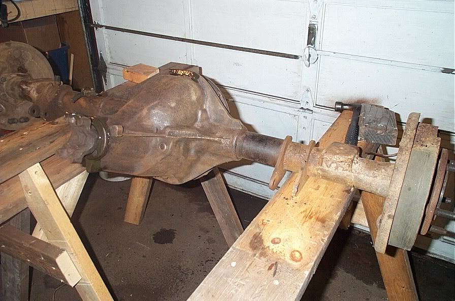

the previous owner had some sort of spring over axle going on in the rear only. shocks mounting to brackets welded to the axle tubes. the spring plates have been cut off and welded onto the top...

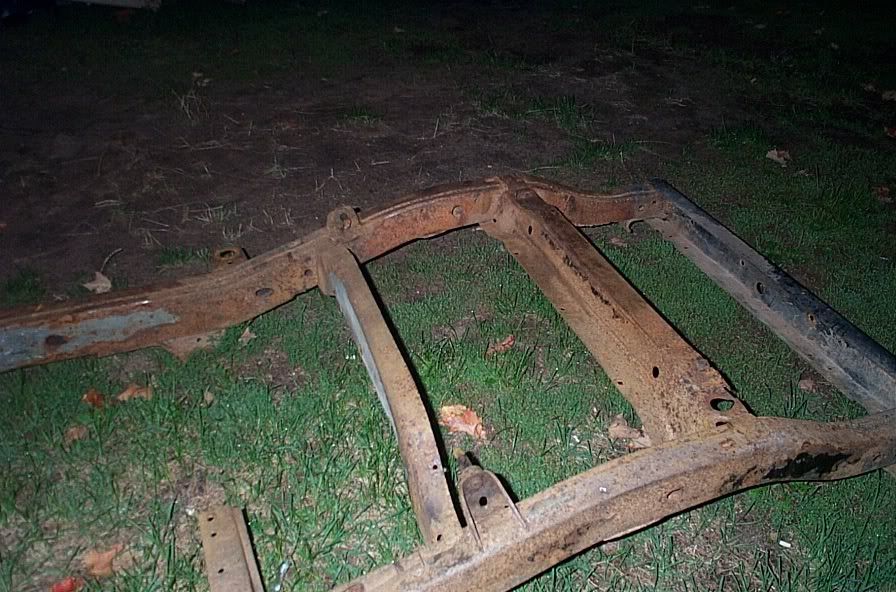

The frame has been set up like this;
what would you guys recommend I do with this??? my new springs are superride 2.5" lift spring and the shackles are 0" lift. my new shocks are skyjacker hydro 7000.

Not sure what you have but if my rear end was leaking like what I see in your pics and I had it out, I'd replace every seal in it. If you ride thru water or mud you don't want it getting into your rear end. From my experiance, water will get in faster than your gear oil will leak out if you ride trails where there's lots of mud and water.

My biggest question is about the spring plate, and putting it back on the right side of the axle (no idea what angle and such) , as well as the shock mounts welded to the tubes and if this a good idea for the amc 20 ?? or should I go back to shock mounts on the spring tie plate (mine have been cut off)

it looks like a lock right locker. they work great but can sometimes act funny while changing lanes.

looks to be a lockright or ussie locker..Both a very good..Also you have 1 peice axles..be sure to get the bearings and seals for 1 peice axles...ya cant go to napa and ask for them I believe..I just stripped my hub yesterday after about a year of wheeling with a welded diff..Have axles to install so I havent really messed with them other than checking them out when I got them and reading online..
Yup, can be changed from the outside, just did mine today. EZ cheezy...
