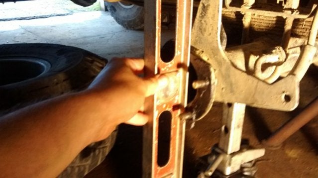

Originally Posted by turkish6 View Post
Thanks for the replies I will try to check the straightness as mentioned.
I wish I could junk it and switch to stronger axle but I currently live in Turkey and it's easier said than done. Finding a D44 is like hitting the lottery lol.
Mine was pretty easy to spot. Easy enough to straighten. Probably ended up straighter than it left the factory.
