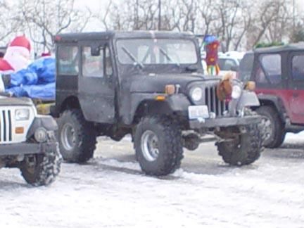

4 wheel drive in a postal is possible. I've been wheeling with a wicked postal. The roof line can get in the way in off camber trails and steep hills can get crazy but he had lots of fun with his postal.
Well, anything can be done with enough money. It would be no challenge at all to dump a pre-1972 CJ-5 drivetrain and axles into a Postal. The frames are just about identical.
But set up as it is, I know perfectly well he went with a different tranny or engine or both.
