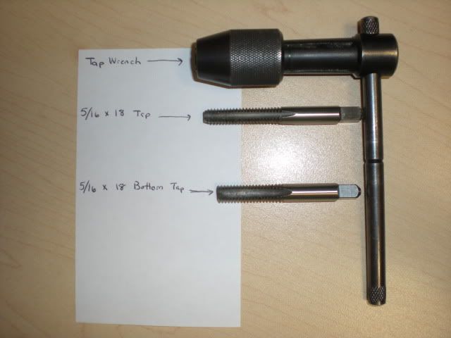

I luckily work for a company that has their own tooling/molding shop. So I went and asked for the tools I needed.
Here are the 5/16 X 18 Tap, bottom Tap, and Tap wrench.
After removing the old plastic cover I cleaned the head with a wire brush to remove all of the RTV I had previously used. When I thought I was done, I cleaned it one more time for good measures. I also used a bungy cord to hold my hose and electrical conduit out of my way. I even removed the fuel line from in front of the valve cover. Made things a lot easier to do.
I then started tapping my holes. I measured 1/2 inch on the bits and wrapped electrical tape there. I started with the regular beveled tap and then switched to the bottom tap. The bottom tap is just like a normal tap but with a flat tip. I had my brother holding my shop vac with a small nozzle next to the hole to suck up all the shavings.
