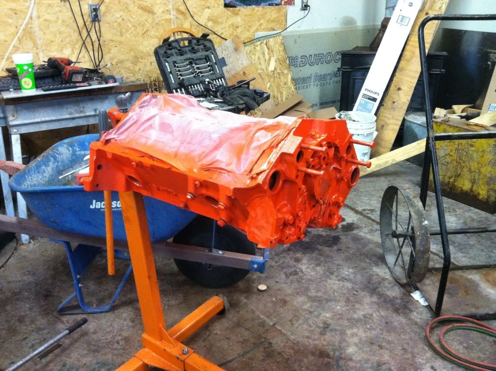

Originally Posted by 8pitcher
I gotta block all painted up and purdy
Pics man!
The crappy curve makes the motor feel smooth and happy. From 1800 to 2500 it actually feels really good. From 1000 to 1500 it dogs pretty hard, but the curve doesn't really get anywhere until 1800 so it's expected. It'll do until I can afford something better.
