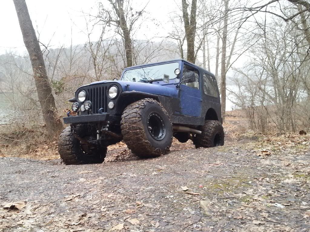

heres mine on a 4" procomp lift with 35x14.50's
heres a pic of it with 35x12.50's I had to trim just a touch at the back of the rear wheel well to keep from rubbing at full flex. you can see a slight radius where I trimmed
