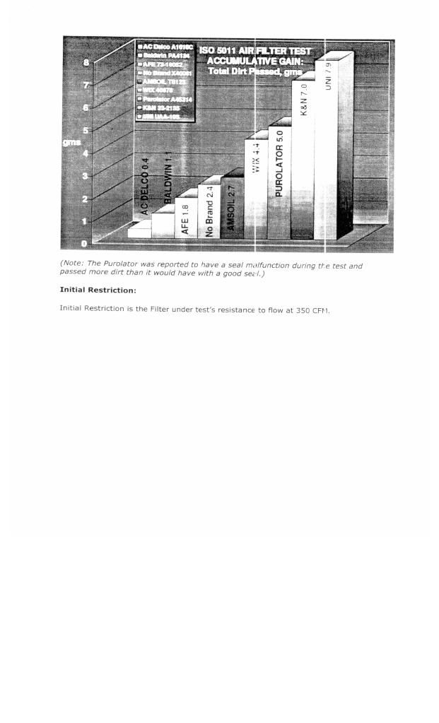

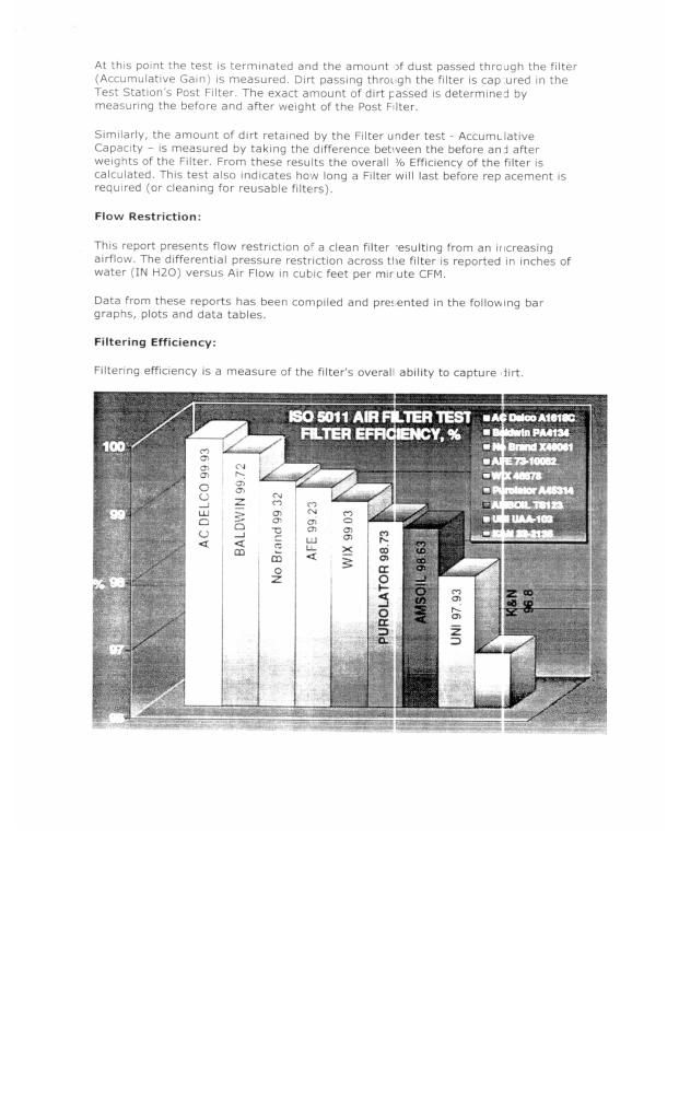

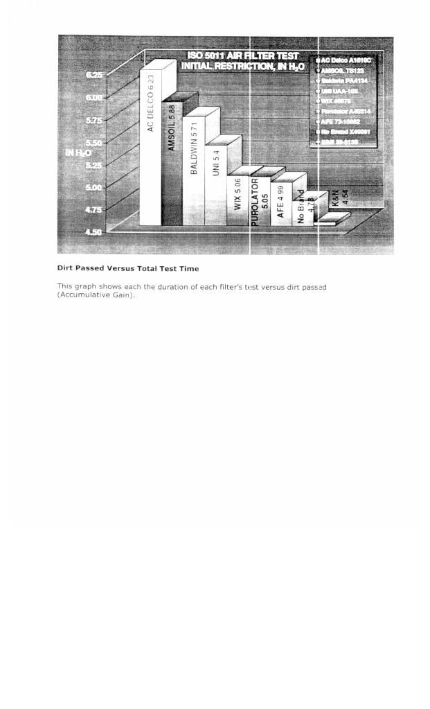

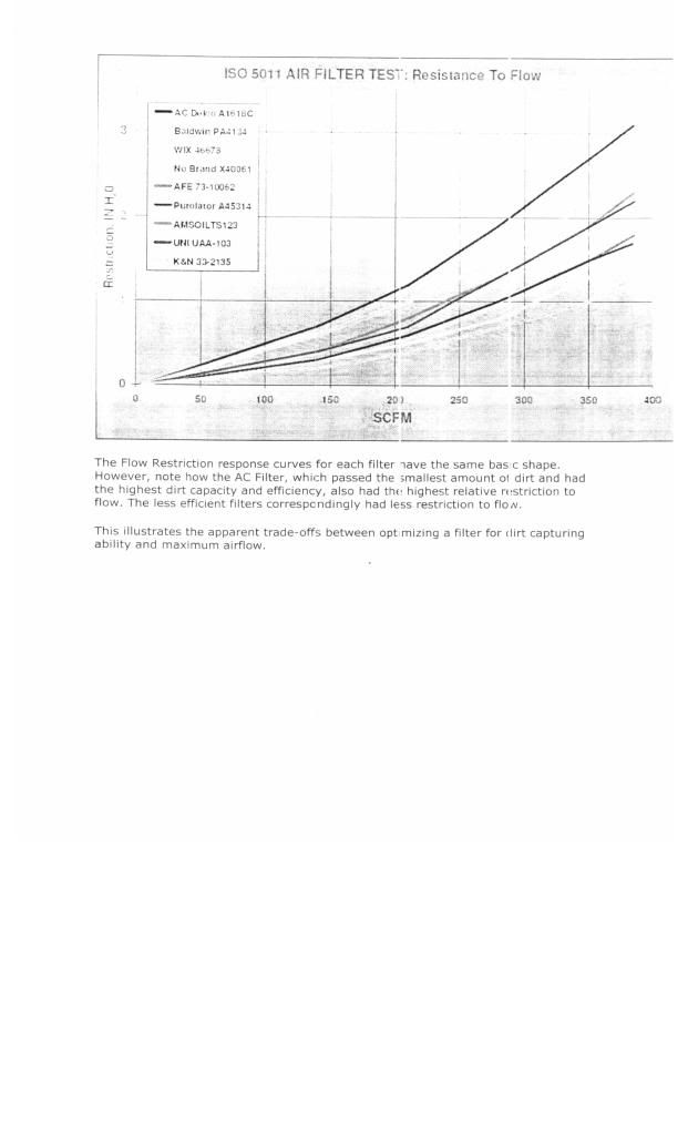

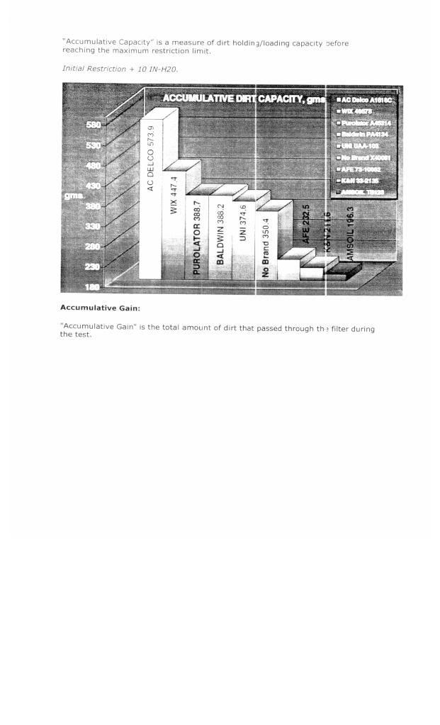

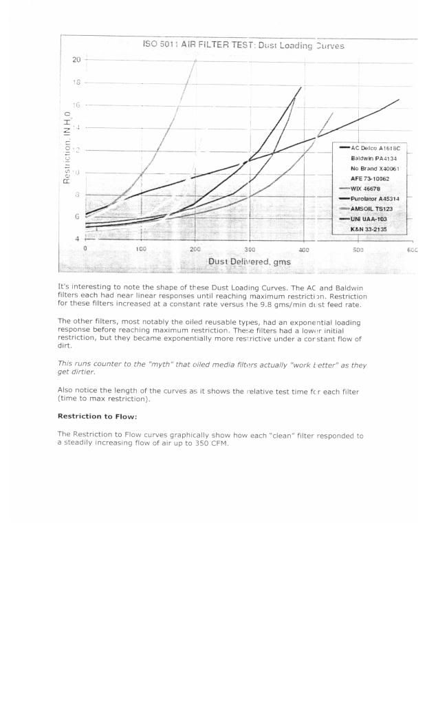

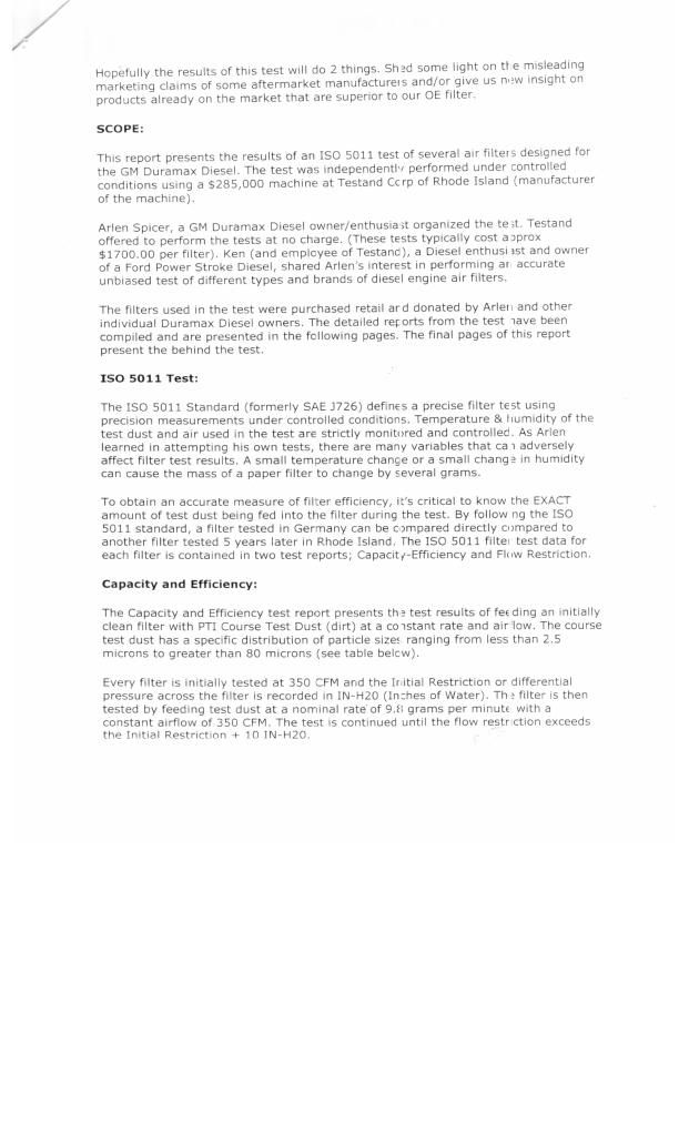

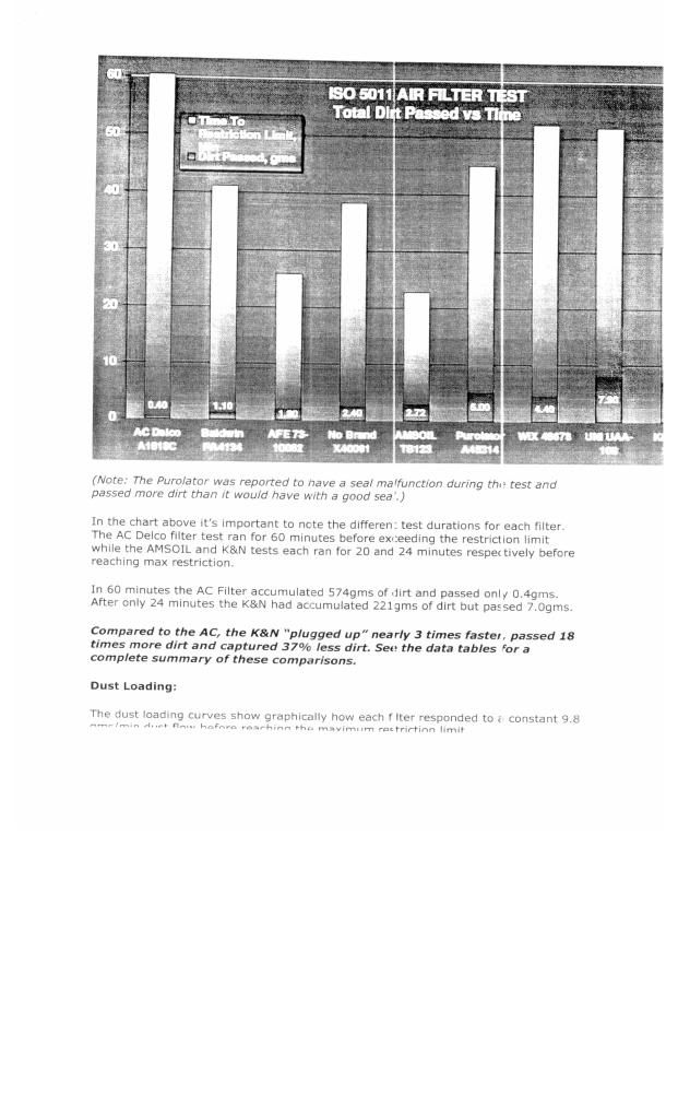

Tests taken on a $285k machine. 9.8 grams of dust injected per minute at 350CFM.
Quotes from test:
In 60 minutes the AC Delco accumulated 574 grams of dirt and passed only 0.4 grams. After only 24 minutes the K&N accumulated 221 grams but passed 7.0 grams.
Compared to the AC Delco, the K&N "plugged up" nearly 3 times faster, passed 18 times more dirt and captured 37% less dirt.
AC Delco filter ran for 60 minutes before reaching maximum restriction while the AMSOIL and K&N tests only ran for 20 and 24 minutes before reaching max restriction.
Dust loading curves: Most notably the oiled reusable types had an exponential loading response before reaching maximum restriction. These filters had a lower initial restriction, but they became exponentially more restrictive under a constant flow of dirt. This runs counter to the "myth" that oiled media filters actually "work better" as they get dirtier.
As I said before, there will never be another K&N installed on anything I own. In my opinion, a paper element filter with an oiled foam shell gets you the best possible filter medium available.
I am not affiliated with any filter manufacturer or the testing center, just want you guys to have as much unbiased information available to be able make up your own minds. And yes I realize these were taken on diesel filters but the medians are the same for gasoline engines and if anything diesel filters are going to be larger due to the average displacement of a diesel engine and most being turbocharged.

2 things about that test that stand out when I read it. By the way here is a better link to read the whole thing.
1. It used the old Amsoil filter known as the TS series, which was dual density (2 layered) oiled foam (DDOF). When the DDOF technology was tested with fine dust particles, it was shown as one of the best technologies at the time (again pre-2004). Also this is why you see DDOF technology used on 2 stroke stuff like hanheld equi,pment (string trimmers & leaf blowers) and many ATVs & dirtbikes, where smaller (fine) dirt particles are of larger concern. Amsoil discontinued the DDOF design in 2005 & replaced with our dry media filters known as the EA series. This new technology was a collaborative effort with Donaldson and is second to none in the industry.
2. If you do some real good research and look into what exactly what is tested in an ISO test you will find that they test COARSE dust & fine dust, this test used COURSE dust! Just because these guys had access to a $285,000 piece of test equipment, it doesn't make them scientists!
