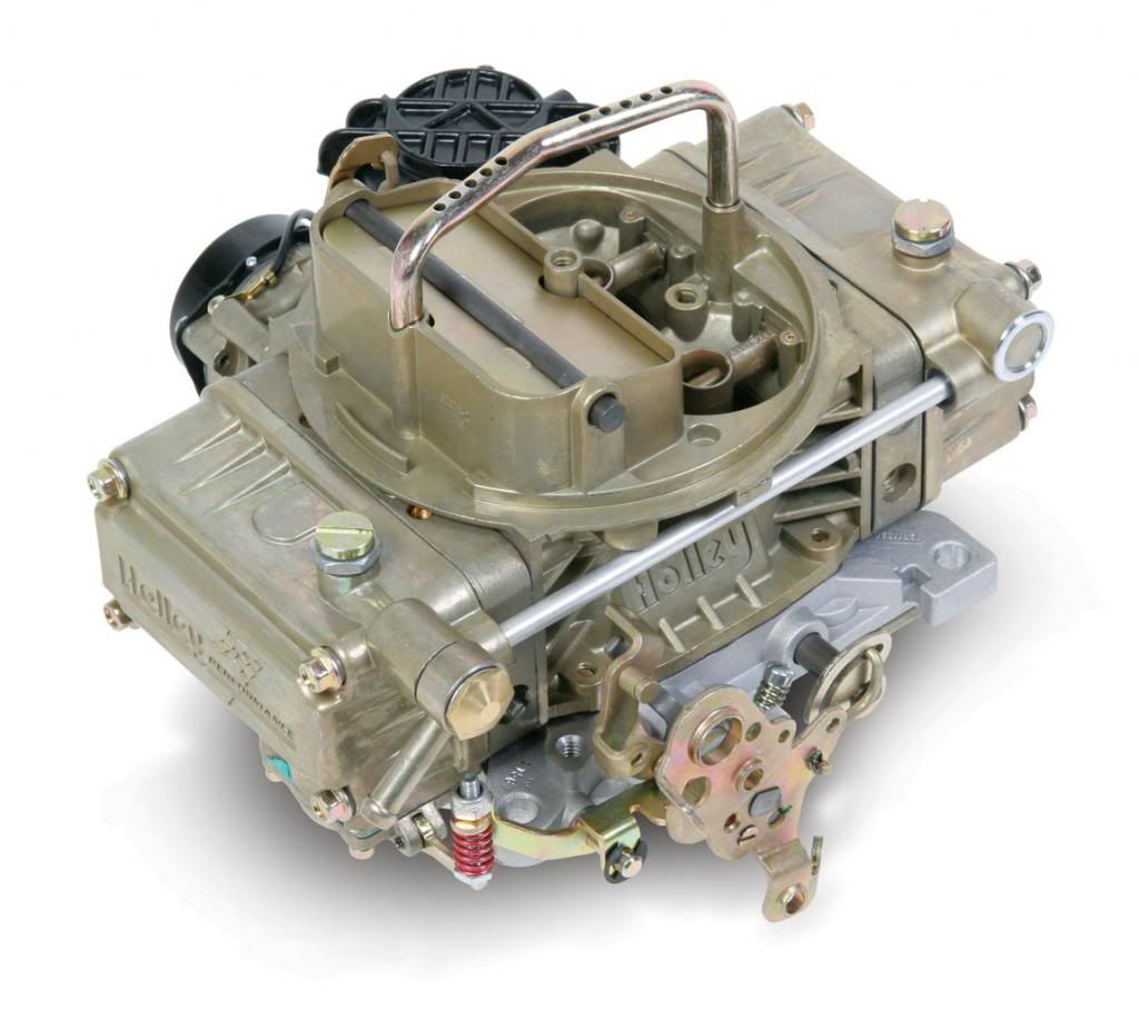

i did a edelbrock performer intake and 600 carb. if i was to do it again i would get the edelbrock intake and buy used holley and rebuild it. new carbs are ridiculously expensive imo. if you can find a cheap holley 600 with the side hung floats that would be a good way to go. i was able to get one for 25 complete carb.
My carb does not have a secondary metering block so i am going to get one with the transfer tube that you see in this the truck avenger carb pic. The transfer tube you have to call holley. a jet kit, gaskets, and maybe a couple other small parts which you can order from summit or wherever you buy parts. by the time im done i sould be around 200 complete.

i bought a used edelbrock intake and a used holley truck avenger 470. i rebulilt the carb and only have about $300 into the set up and it has made a world of difference. You do not need a 600 CFM carb for a 304. my 470 makes plenty of power and sounds mean.

600 CFM is too much. I believe Jeep Hammer has the formula, but here are a few links to try.
http://www.csgnetwork.com/cfmcalc.html
http://www.gtsparkplugs.com/CarbCFMCalc.html
my 304 with a mild build 5500 max rpm and 80% efficiency requires a high 300 to low 400 CFm Carb
