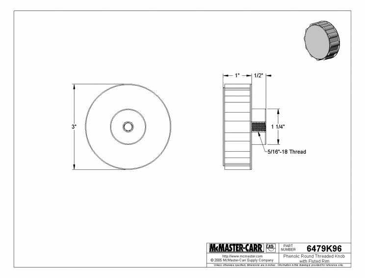

Next, go online to McMaster-Carr.com and purchase a threaded knob with a 5/16-18 threaded hole. I picked out five that will work and are ideal for gripping but the choice is up to you. Here's some pics of what I have picked and the part numbers are located on each drawing in the lower right-hand side.
Cost: Anywhere from $1.00 to $4.00 + shipping.
Most of the knobs shown, if not all of them, have a temperature range from -15 to 200F. I chose the first one pictured but probably will try the second one and last one pictured as they look more like something you would find under the hood and they have a larger diameter for gripping. Will post later on with pics when I receive them.
We now have our two products and no modifications are need except to remove the 5/16" nut from the rubber plug and use one of the knobs in its place.
