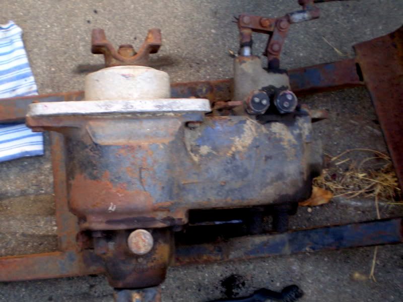

Is this an AA divorced Dana 300?
I can't figure out what this is, not being very well versed in Jeep. It looks like a Dana 300 with an advance adapters divorce kit but google is letting me down right now.

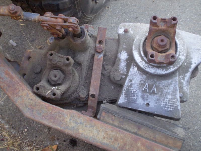

A few more pictures

Dana 21 divorced at first glance but at second its a Dana 20 with a AA divorced kit. Dana 300s have an aluminum output shaft housing while the 20s are cast iron.

A good clue is the "texas" style bolt pattern on the input mating surface.
That's shared between the spicer 18 and 20 cases - but the spicer 20 case has the rear output inline with the input, whereas the 18 has the rear output offset and inline with the front output.

It could be simular to the 300 mounted on a T-18 like those used in some Scouts one year. I think those had a Texas pattern also.
Looks like a T-case set up to be mounted behind another t-case to double (tripple?) your gear reduction. Would need to be in a jeep or something.

Those configurations were used by company's like Wolverine and others doing 4WD conversions on mini trucks in the late 70's and 80's time frame.

thats the one for sale on pirate, yes its a dana 20. i have one to that i bought a while back for a buggy prodject, haven't used it yet. mine has a flange on the front face insteed of the yoke, i would love to find ( or get that one ) for the yoke.
AA deos make a dana 300 divorced kit if you where intersted, they dont adverties it but they will build one for you, jason.
