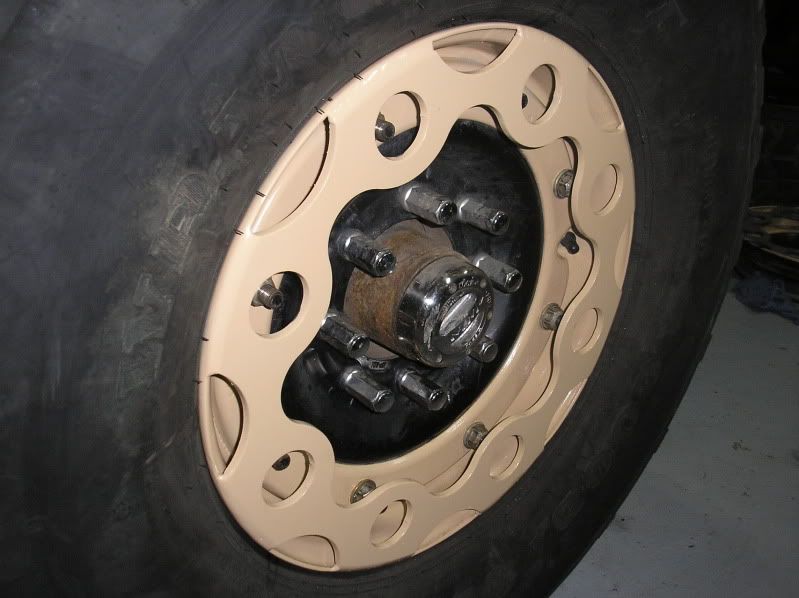

Do the Warn premium 6 bolt conversion. Here are what mine look like...don't mind the old rims.

85 Laredo CJ7 has a very good picture of what you need to upgrade to 'Premium' lockouts.
The larger things are the Hubs, wheel bearings, wheel studs, you reuse the lug studs in most cases,
And then the 6 bolt Axle Lock Outs.
