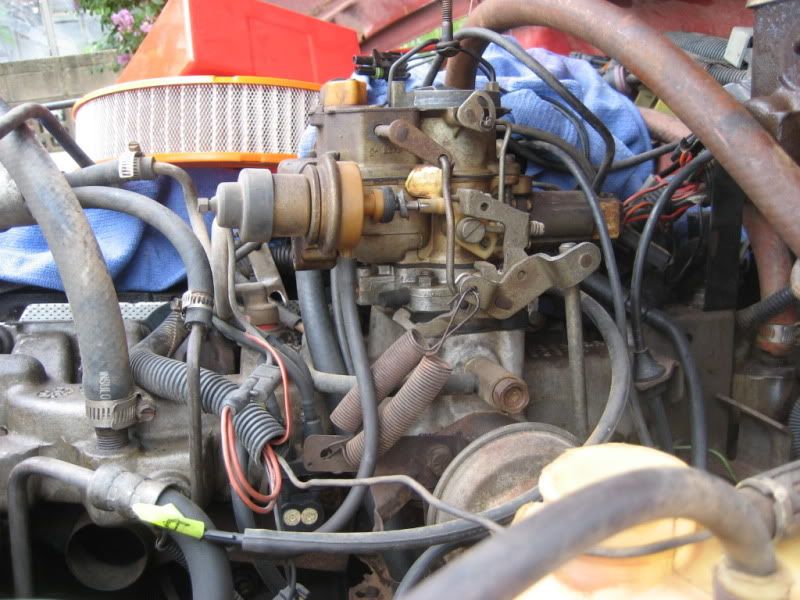

all right thank you here is the pic. No I do not live in a emissions area. and no it does not run good it wont even idle.

The idle pickup tubes are notorious for their 'too small' crimped ends blocking which causes no idle. The U shaped gas line between the carb and filter can hold an amazing pile of junk in it. You will need two wrenches to remove it or you will mess up the float needle setting. You have to hold the fitting at the engine solid when attaching that gas line.
To see if it is just an idle tube issue, you carefully watch down the carb while keeping it running and give it a slow shot of gas. If you see drops of gas vs a spray of gas, the idle tubes are blocked. They are brass tubes in the center venturi cluster and can be removed from the top. (cleaning while kitting is best) Folks ream out the crimped ends to 0.032". Welding torch tip files or drills come this size as do dremil tool bits.
If you really want to get ambitious, you can remove the computer and it's related sensors from the ignition loop. Here is a thread on doing that: http://www.jeepforum.com/forum/f8/ho...bypass-522262/
Your gas filter is also in crooked. The return line needs to be up top or gas siphons back to the tank when it sits.
