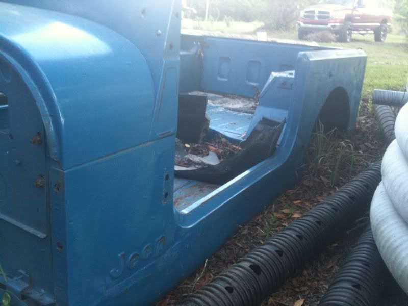

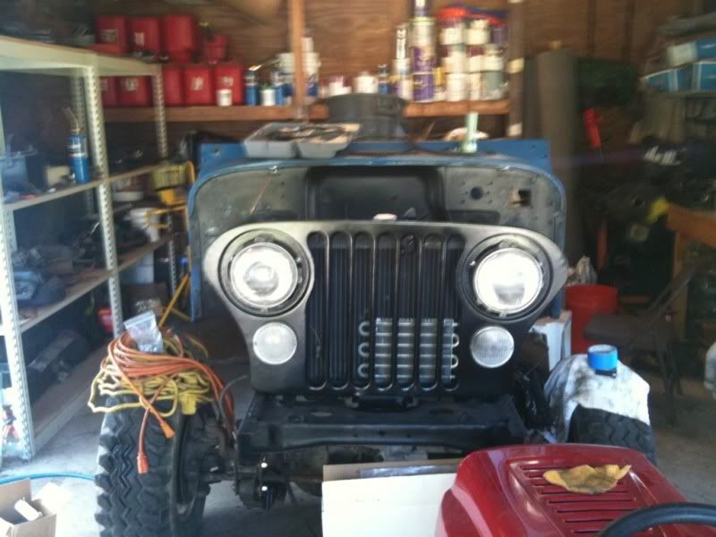

Heres some pics of my mutual project with a friend.
84 CJ-7 300 plus an unused glock.

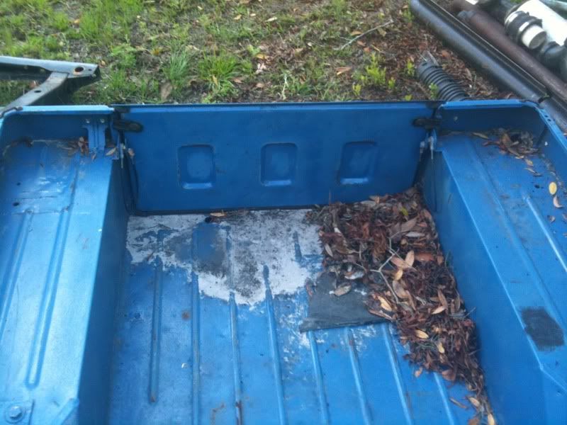

Came with every thing but a radiator, hood, tub, dash and the windshield frame is rotted out. But it did come with a hard top and set of hard doors.

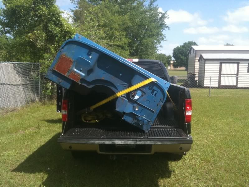

Decided the new tires that were one it would get sold to buy a tub. Like a christmas miracle found a local guy with a tub (decent shape) hood already smoothed and sanded (rust free) dash, solid windsheild frame, and radiator. So tire got sold and tub picked up
I have a set of rollers so the tires wont be missed for now. so for 300 bucks and an unwanted glock were on our way to a CJ

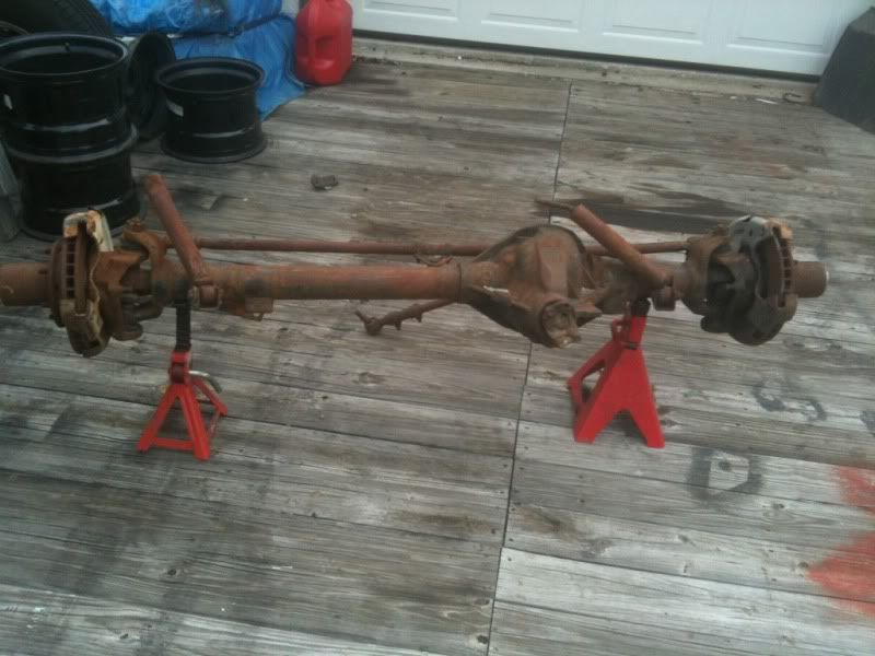

right now its just a budget build and main concern is to get it on the road so the wives will be happy that its actually moves.. they were not very happy with the parts and peices that it came in. It has the 6cyl, auton 20 rear and 30 frot.. as far as the lift goes it will have to wait for a bit. again main concern os getting on the road.

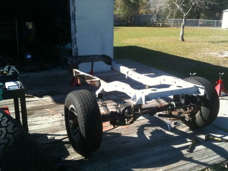

Heres some more pics

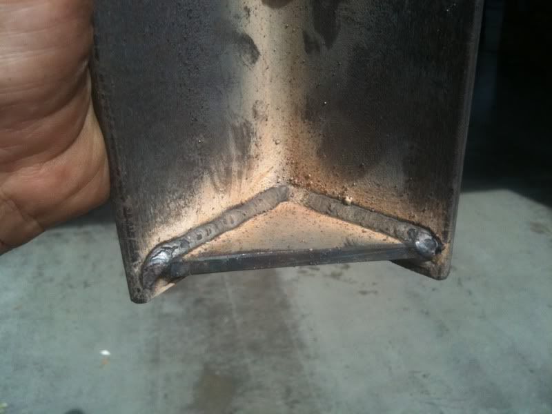

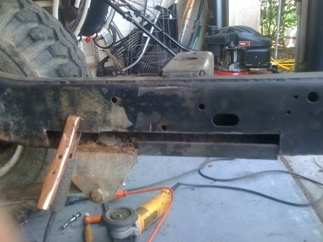

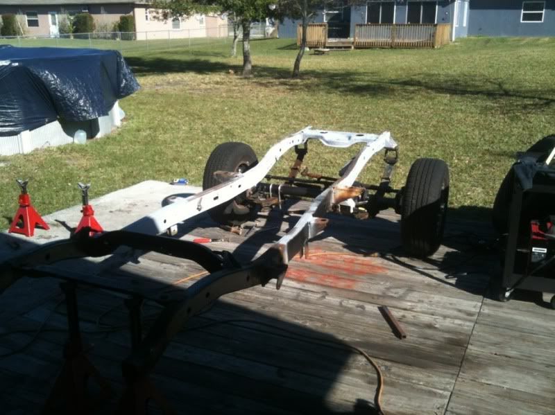

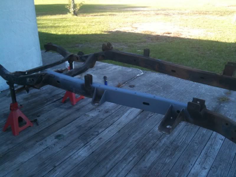

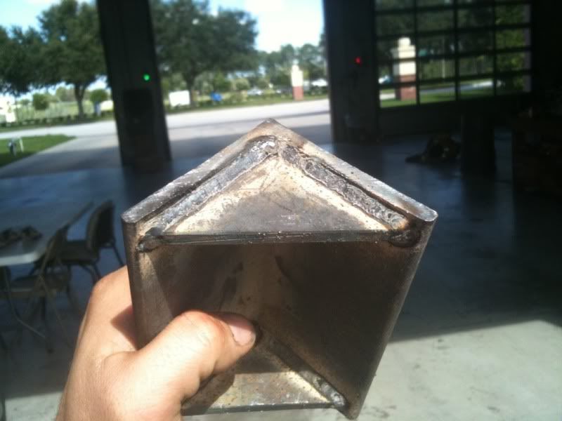

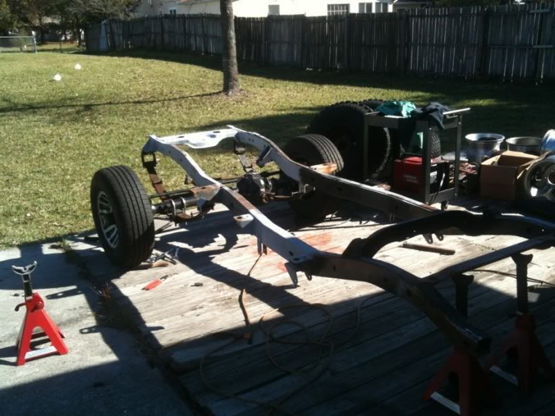

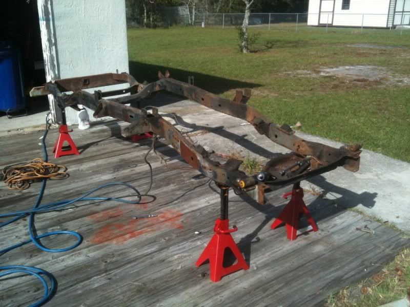

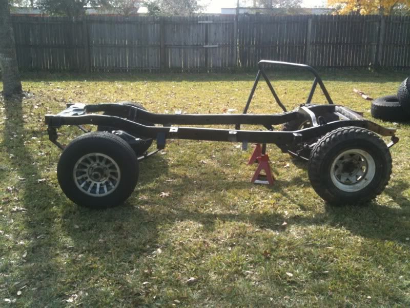

when we got it I know the frame had some rot on the drivers side near the motor mounts. I could tell it was split and soft enough to move when I squeezed it. I ddint however know it was in this bad of shape
for most of it I had to replace only the bpttom 2 inches. But up by the motor mount brackets I had to replace all the way up to the top 2 holes
Heres the motor mount bolts.. Im thinking the PO must have cruise the salt water a bunch with it

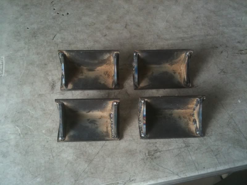

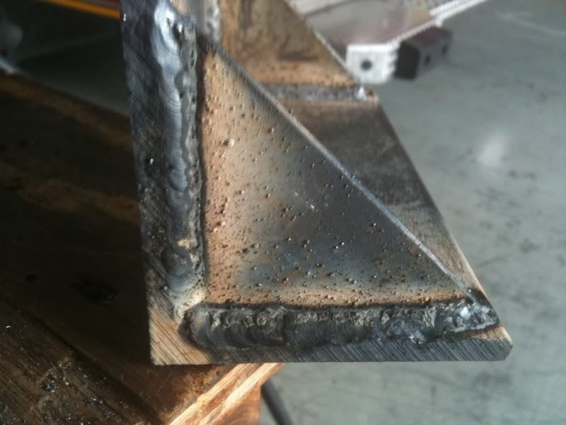

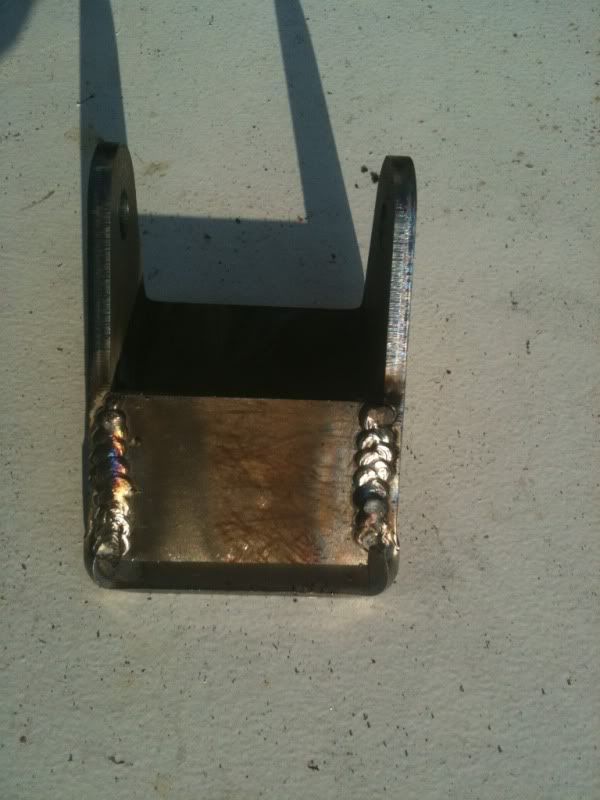

after welding in replacement metal on the inside we made reinforcing plates that ran from the front shock mounts to the rear spring hanger for the outside on both sides.. Ill try to get some pics of those in a day or two.. My buddy has the frame at his place.

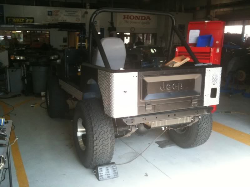

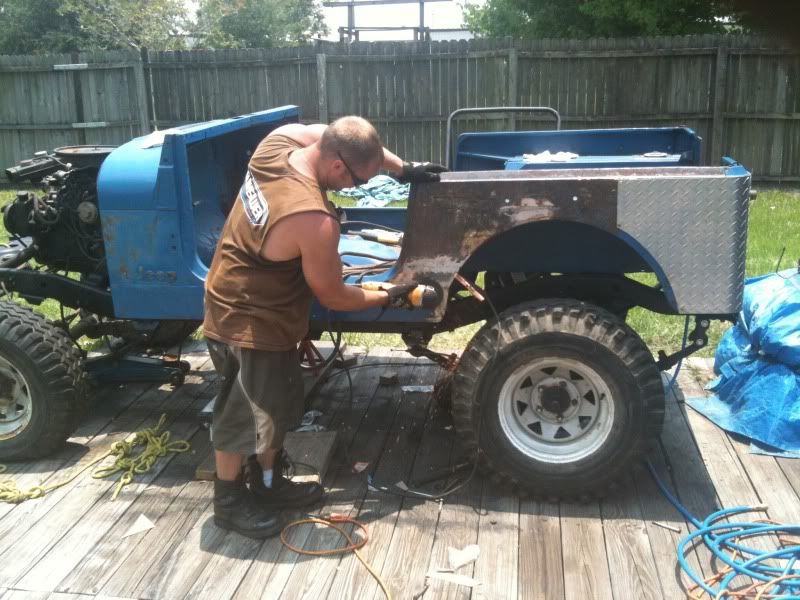

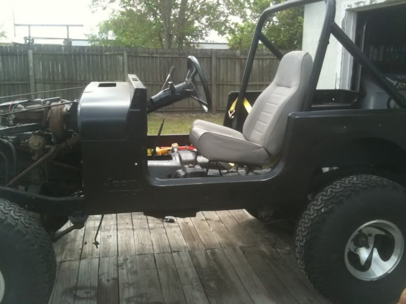

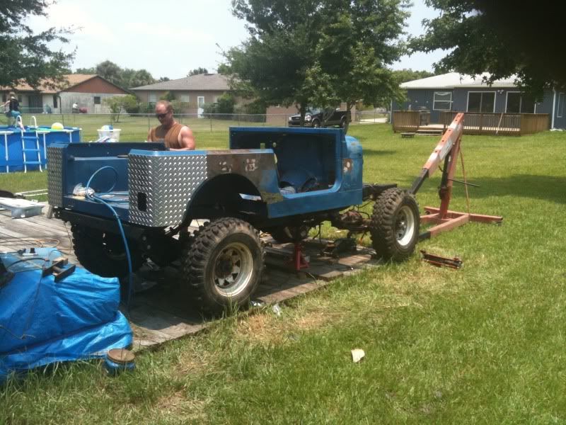

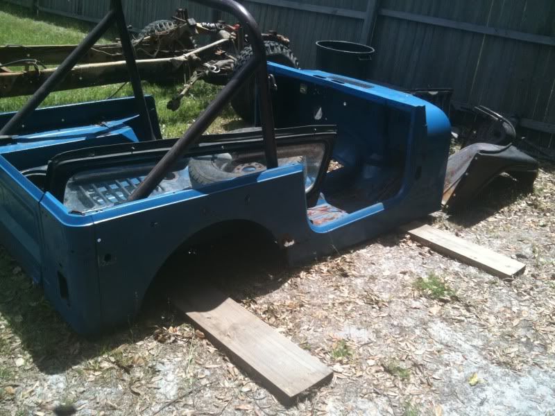

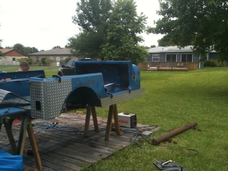

Got the tub up on some jack stands to make it easier to work when I realized the few rusty area were all in major stress points and it actually started to bend right behind the door openings. I did some trading to get the diamond plate corner and rocker covers, that will cut down on a ton of body work
heres the tub on the frame. Its sitting on temporary 2x4 body mounts.

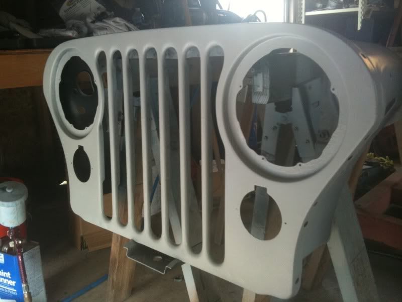

Hood, wind shield frome and grill primered
Finally got the proper body mounts on it and bolted it down.. that squared it up nicely. Doing some metal work on it. and the lift is on.. I cant remeber if its 3 or 4 inches but for $150 bucks cant beat it.

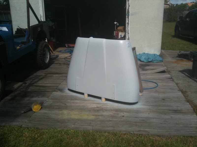

Got some paint on the hood.. I was using the duplicolor paint shop stuff but its not working out to well so Im changing gears to another option.
I also painted the hood and loosley assembled its major parts.

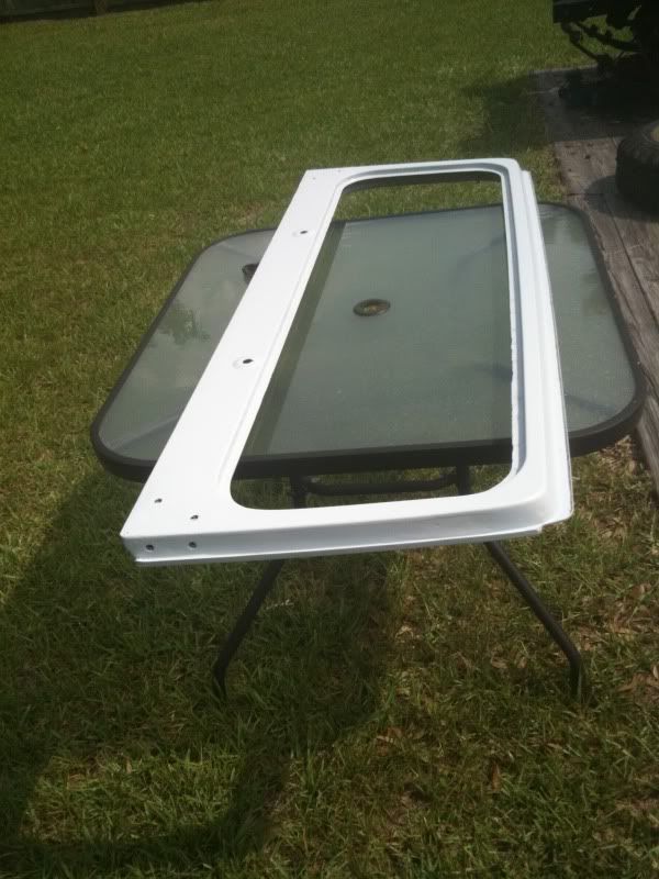

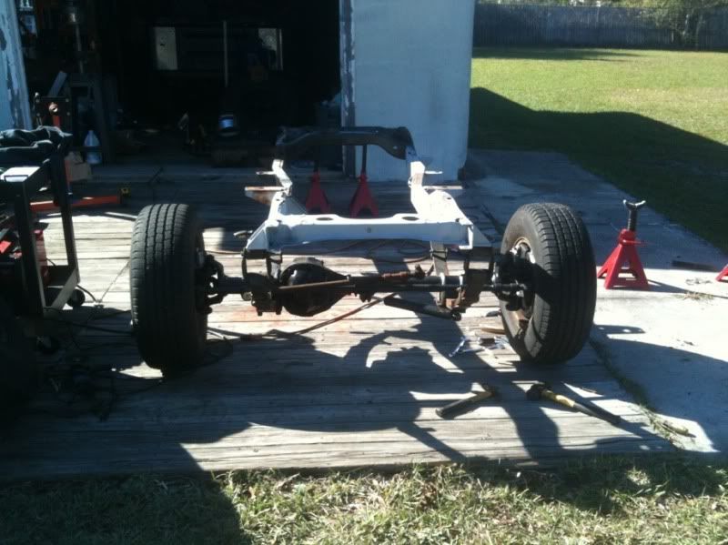

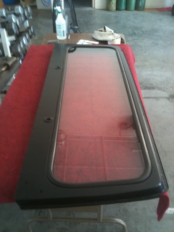

Time to swap the glass over from the bad frame to the good one.Decided what the hell and went for it. the most nerve wrecking 5 minutes of this whole entire jeep project. It was alot easier then every one has made it sound. Knocked it out on the first try.
I also did a lil pre assembly on the dash.

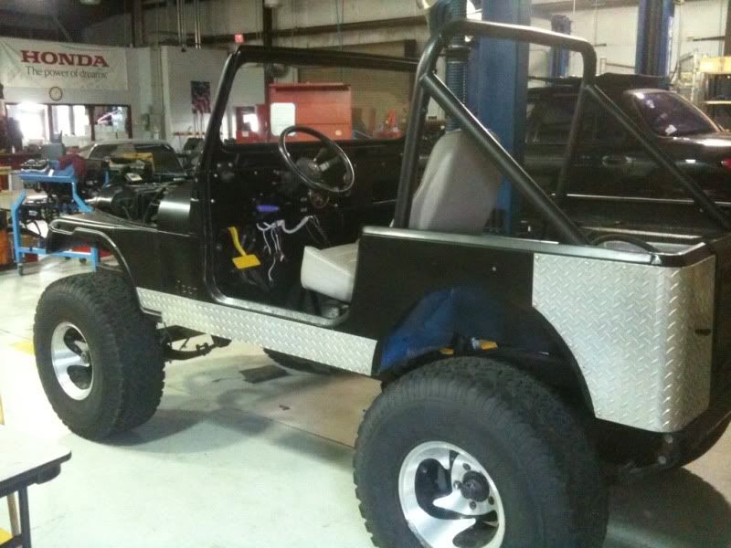

Got it painted and I'm waiting for some free days to finish. Here's where it's at now.
I have to get the roll bar straight and installed, then button up all the little things
