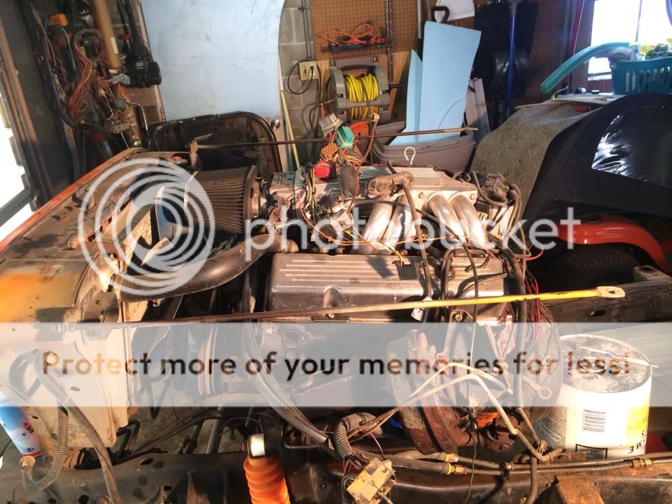

I wanna see the motor ?

im no expert but judging by the intake in the first pic that's not an ls1. Also ford front diffs were drivers drop, so its probably a chev dana 44 front diff by the looks of it
Yep, looks like 5.7 TPI engine

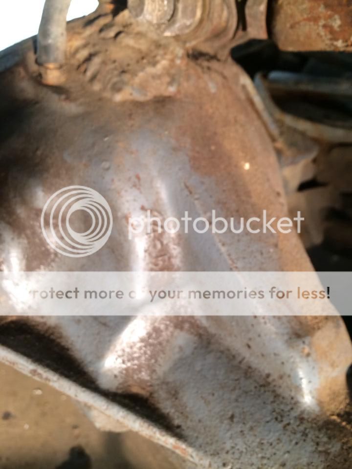

Well found the block number today and it jnfortunately is NOT and LS1 motor it is a 80-85 gm 305 motor. As for the axles i was told they were 1ton axles dana 40 fronts and dana 60 reads which i now believe is untrue. Reason we suspected they were from a 72 for f350 is because the diff cover gaskets matched up with the ones we pulled off. Anyway to figure out for sure what they are? Thankyou everyone for the info and enthusiasm. Also the jeep will be fully black after the rhino lining as its the only color we deal with out of the shop i work for
Infiniti89 is offline
post #7 of 11 Old 12-14-2013, 09:11 AM
Blakescj7
Join Date: Sep 2013
Location: Tulsa
Posts: 515
yep. old 305 tpi. not too bad but grossly underpowered for a v8. i think they came in camaros. be careful if you ever pull the intake tubes, they are papr thin and dent easily! post pics of the covers and axle numbers. dana 44s arent a one ton axle, they did come in 3/4 tons though. and if the rear is a dana 60,then score! post up some more detailed pics of the drivetrain.

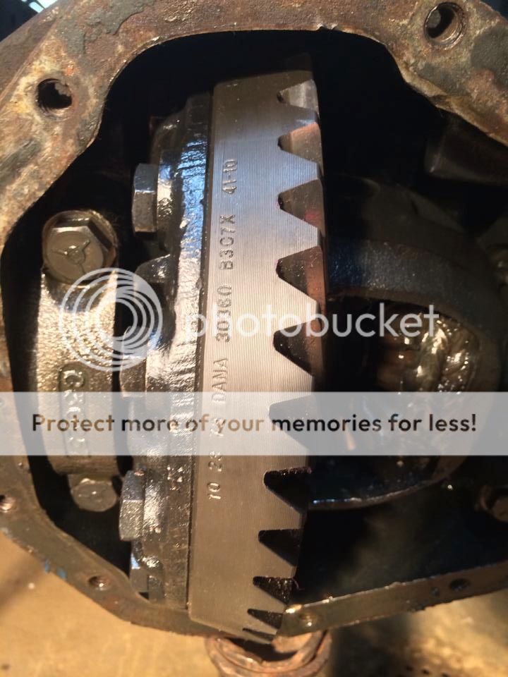

okay, so i took some more pics today of the axles and engine. Will post them.
Front Axle
Rear Axle
Judging from what i am reading online and seeing on my axles/gears, I would say the front is a Dana 44 and the rear is a Dana 60? correct me if i am wrong and appreciate any input and knowledge anyone is willing to provide! thanks people.
post #10 of 11 Old 12-14-2013, 06:07 PM
Blakescj7
Join Date: Sep 2013
Location: Tulsa
Posts: 515
Good score on the Dana 60. The d44 isn't bad either. Should be a good combo. I can't see too well but does anybody think that rear looks welded?
Blakescj7 is offline

yeah the rear is welded posi.
