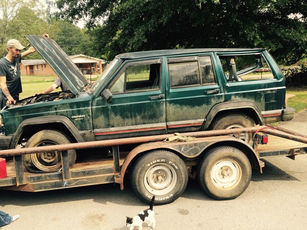

Hello again gentlemen, I am looking to try and get a little advive and opinions on what route to take with the next step and perhaps biggest step of my cj7 build. Pretty much from the time I got the jeep I wanted to do a later model 4.0 swap in it. When I got it it was obvious the old 258 had seen better days, the thing looked like the little engine that could with all the blow by and leaked oil like the valdez. But regardless I it didn't stop me from putting a offenhouser 4 barrel intake, solit header and HEI distributor on it at no cost to me to just see if I could get it running a little better for awhile until I found my motor. But after these upgrades and much rewiring it evident that the 258 is all but dead.At least one cylinder must be dead.
But anyway, the big news is I found the donor for the 4.0. Its a 96 with 175,000 miles with all of the drivetrain good. It was rolled a few years back and has been sitting other than moved around a bit ever since. The motor sounds good and has good oil pressure.
My question is what are my options and what am I dealing with here as far as how big the job is. I have read quite a few threads on different 4.0 swaps and have heard quite a few different scenarios but haven't found much on all the options. Im kind of open to anything really. Original plan was to try and run the offenhouser 4 barrel intake and split header on the 4.0 but im not sure if that is possible or not. I would love to leave it fuel injected but I have read some on 95+ swaps being a headache where this is concerned. Again im open to any options really, i like the simplicity of carbing it but i love the idea of that fuel injection too. Thanks guys, and here is a snippet of the donor lol
