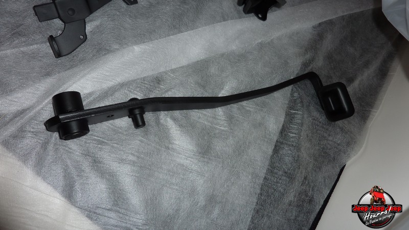

Hey!
Starting a batch of M. Ford's favorite color...
Regular Paint...
PlastiDip paint ...
Pedals done too...
More Pics ASAP ! (Camera is on strike )

After some kicks on the camera AND battery refilled ... don't know what's the usefuller ?
Black it baby!!!
some details...
ONE exception : WHITE in the inner part of the light under hood in order to have a better reflection/efficiency AND better design:
That's the french touch LAREDO option !!!
Every pad pedal will be, of course, replaced... I've allready the pads for the brake et clutch... which fit/look like OEM...
but I've not ordered the accelerator pad: I'm a little concern about it looks like... does the OMIX-ADA are right AND OEM ? do you have better choice ?
