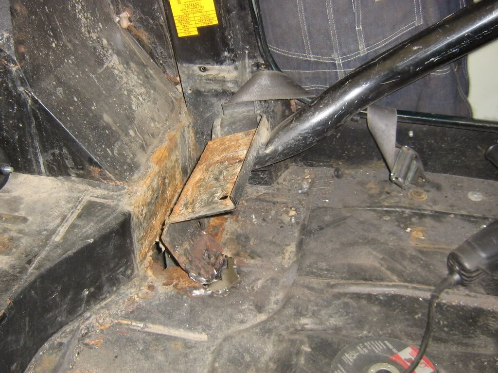

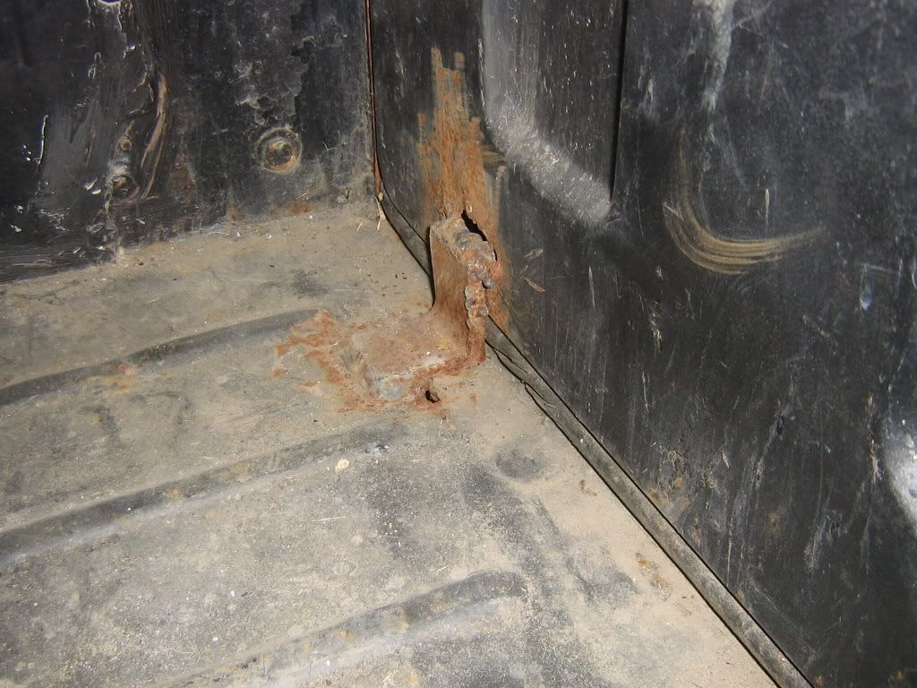

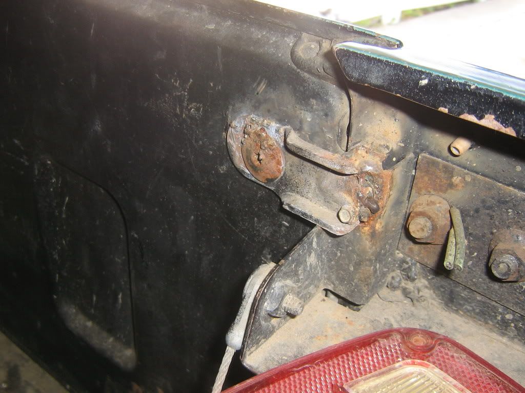

So I'll show a couple things that the PO did. First of all, he had a speaker box in the back behind the bench that housed a 10" sub. The box was small enough to fit back back there, but big enough that you had to get it in and out by opening the tailgate- you couldn't just drop it in. So for the sake of securing his 2nd hand 10" Cerwin Vega speaker, he goes and does this...
and even better...
Now I've seen good welding, I've even seen great welding. But the gentleman responsable for that should have a shrine made for him, for he has taken welding into a new realm.
The flame job on the front of my first Jeep would've been so much cooler had the flames not been real.
SaskCJ7 is offline

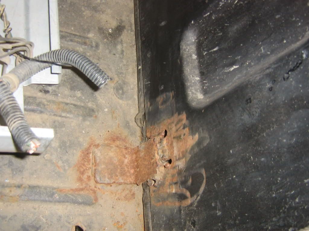

As if that wasn't enough, I guess the guy REALLY wanted his roll bar to stay put.
The other post was the same way. Ugh.

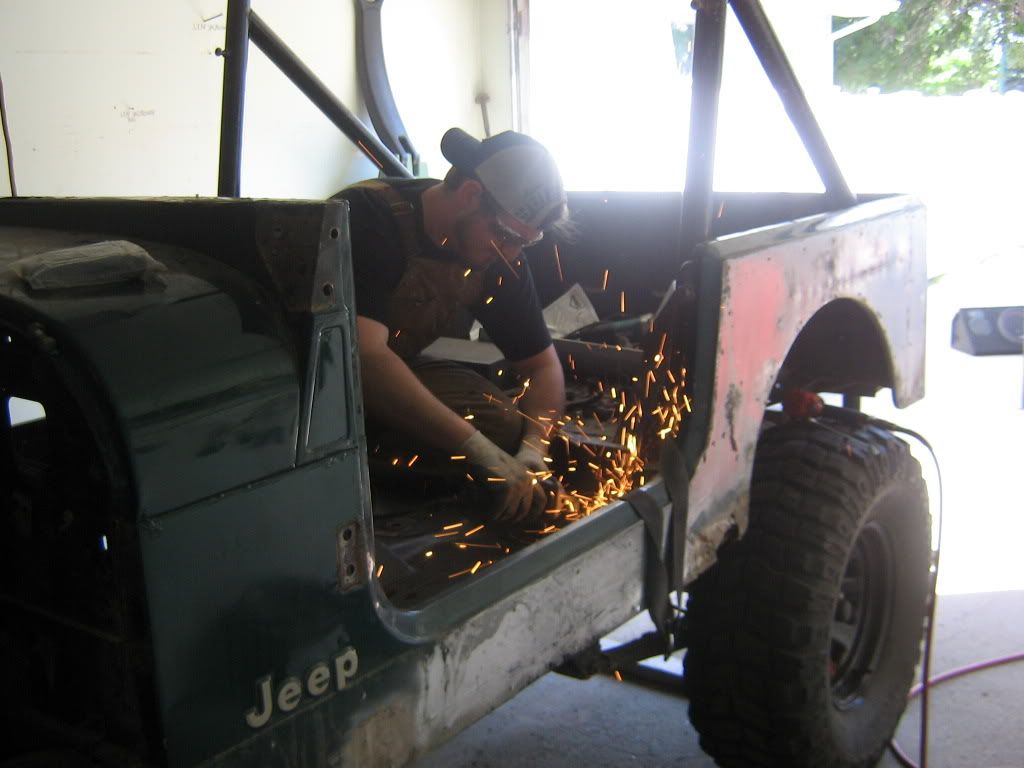

So here's buddy grinding one side of the roll bar off...
and me on the other side...
here's pulling it off...

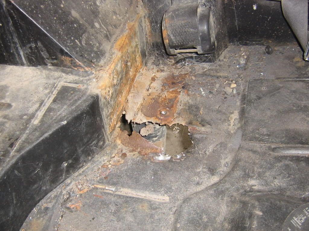

And here's what was waiting underneath...
Here's a pic of an A+ patch job...
This has all led to my ultimate decision to just get a new tub. I have the skill to repair it, but I don't have the time, patience or desire.

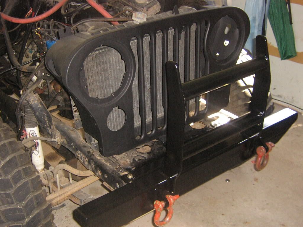

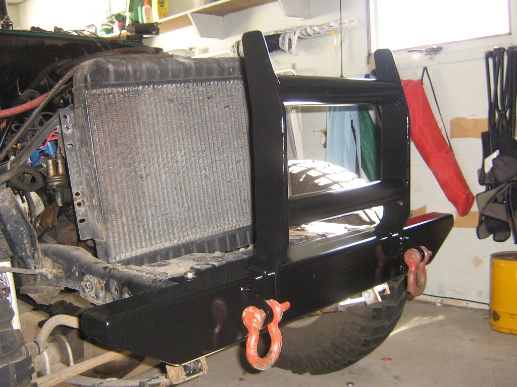

I finished fabbing my front bumper. I think it looks good. I cut the sides of the original bumper to be as long as the frame is wide, welded it to the back of the new bumper so then it could be bolted to the frame the exact same way. The hardest part by far was the two flat bars that make up the sides of the bull bar. They have a very custom shape to them, so the only machine process used to make them was cutting some stock flat bar at the saw. The rest was done with a torch (I can control a oxy/acetylene torch easier that a plasma for some reason, maybe cause it's heavier?) byhand, then a grinder with a soft disk to smooth it out. Doing one was easy, but making a second one the exact same shape was where it got a little trickier. They turned out good though. Overall I'm really happy with it.
The rear bumper is being fabbed up right now. It's about halfway finished. I plan on getting a fiberglass tub with no tailgate opening (despite the crappy welding, the PO had the right idea about securing that speaker box...), so I figure I don't need my spare tire mount to swing out. Therefore the whole thing is going to be one solid piece. I'll provide pics when it's done, or the next time I go to work I'll bring my camera and snap a few pics. Anyways, I'm headin out for a drink with a work buddy.
