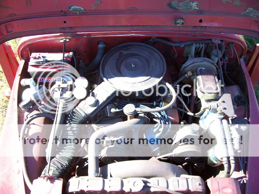

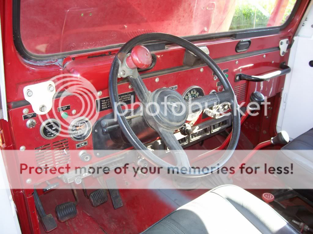

After an engine rebuild and new paint the tow loader was used about 10 years ago. Since then it had been resting, safely stored. All attached arms and cylinders removed as well as the original special equipment sheet metal half-cab.
After inflating a few 31x11.50x16.5 Goodyear wranglers we dove right into the engine. Marvels Mystery oil worked it's wonders and the motor turned by hand fairly easily. A new battery, spark plugs, wires, fuel filter,oil change and all new parts in the original 2 barrel carburetor has the engine running nicely at the touch of the ignition.
The front arms, bucket, and counterbalance re-assembled fairly easily and new cylinders have been installed. The 25hp hydraulic pump needed a new belt and we were able to find one at flaps. The design not only allows you lift/dump 10 feet in the air as well as lift the front tires 2 feet off the ground- the two front arms can function independently to tilt the bucket to one side or the other. A very nice feature.
Our next big task was to figure out what to do about the half-cab, left completely dissembled. Some door hinges are missing, as well as the two curved metal pieces that cover the front of the windshield frame. It's back together including glass with fresh paint aside from the nearly finished doors and those troublesome windshield covers.
The D130 backhoe needed new plumbing, and one cylinder to be worked on. With the proper coupler all valves are working. It needs a new seat cushion but otherwise should be ready to go.
There is still plenty to be done and I will report progress. Pictures will be posted after the tow loader gets to the farm.

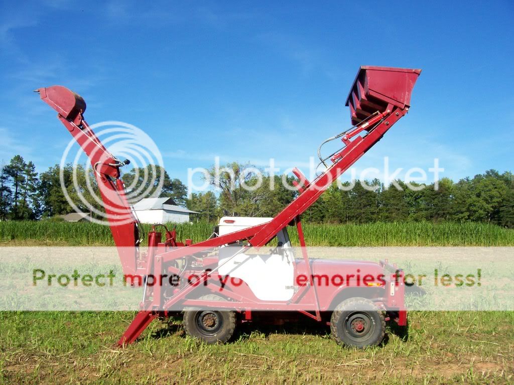

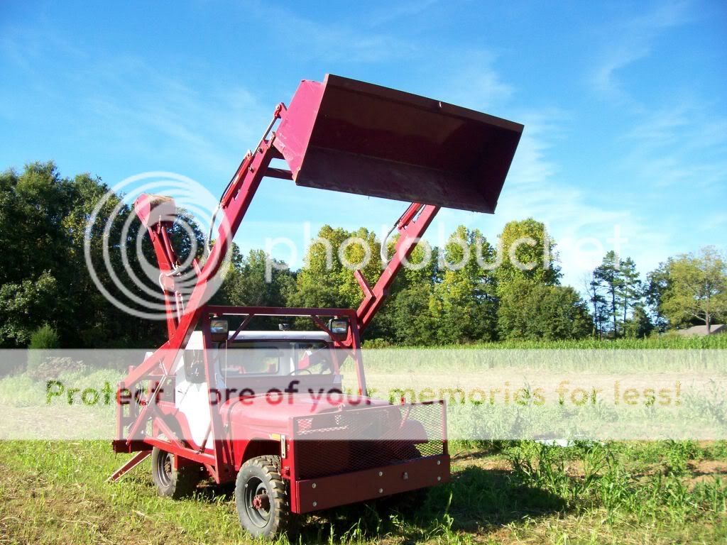

THAT is pretty cool. Not sure how stable it would be with all that extra weight, though. Looks like some full-width axles would be a godsend for that rig.

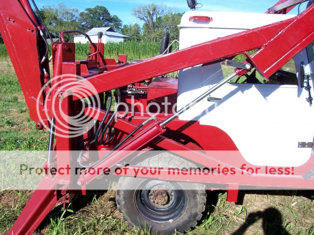

Thanks for all the kind words. I thought there might be a few people on this site that would get a kick out of seeing it.
Now that the backhoe assembled and working all that's left are the details. Finnish the doors, some electrical, new fluids and tires and whatever we run into!

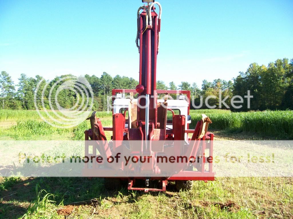

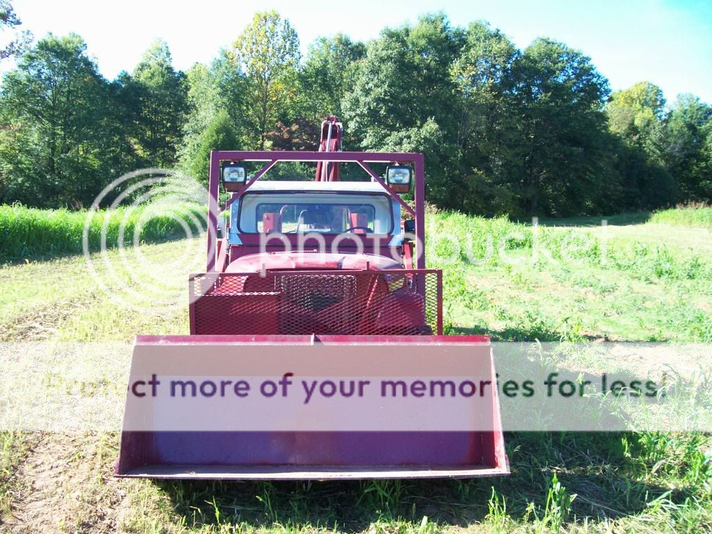

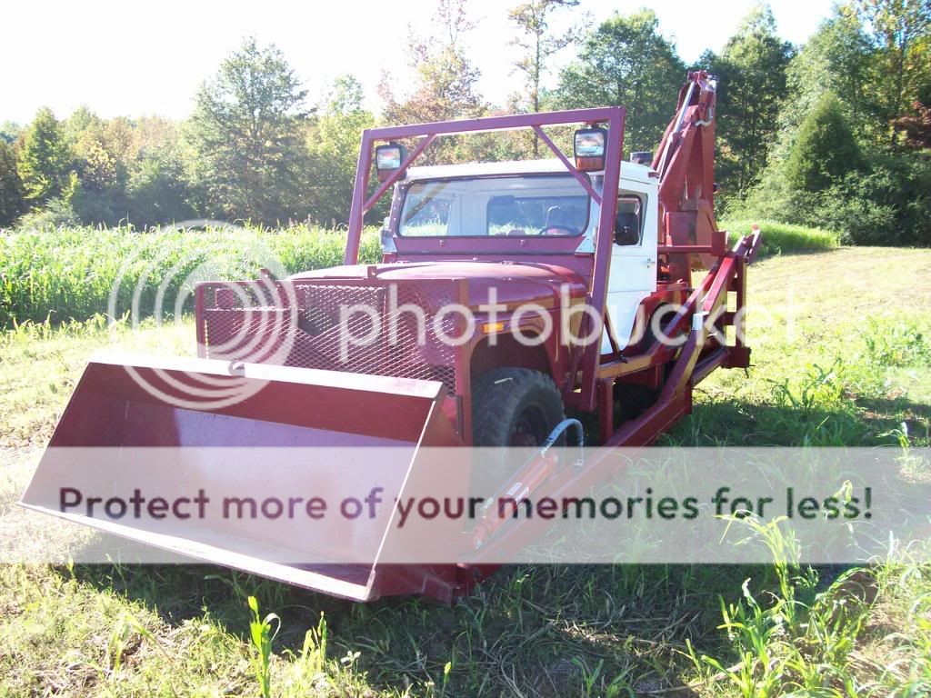

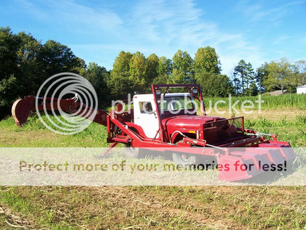

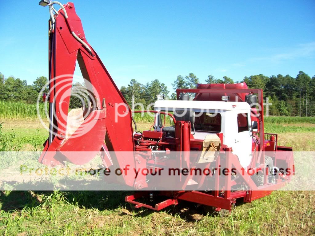

Well I’m far overdue for another post. Finally after many hours of planning and long weekends the tow loader now resides at the farm. I really have to thank my dad for all the time he has helped me the past months to bring the tow loader back to life.
Everything is working except the old A/C and the cracked heater core, which is now bypassed. Nearly every day I’m tweaking, replacing, or installing something. Some parts are still missing like the wheel well splash guards, rotating beacon (to become strobe), and spotlight. The 25+-year-old 28 ply tires are still holding air after a few drives on the farm, and the brakes are stopping at speed downhill. Sure… there is a long list of details and maintenance items to address before I would put it on the highway, let alone call it done. How many owners here are ever really done anyway?
Well here are more pictures. Check them out.

Here is a picture that has been missing... Just about as full as it gets I think.
http://i461.photobucket.com/albums/q...2/100_1653.jpg

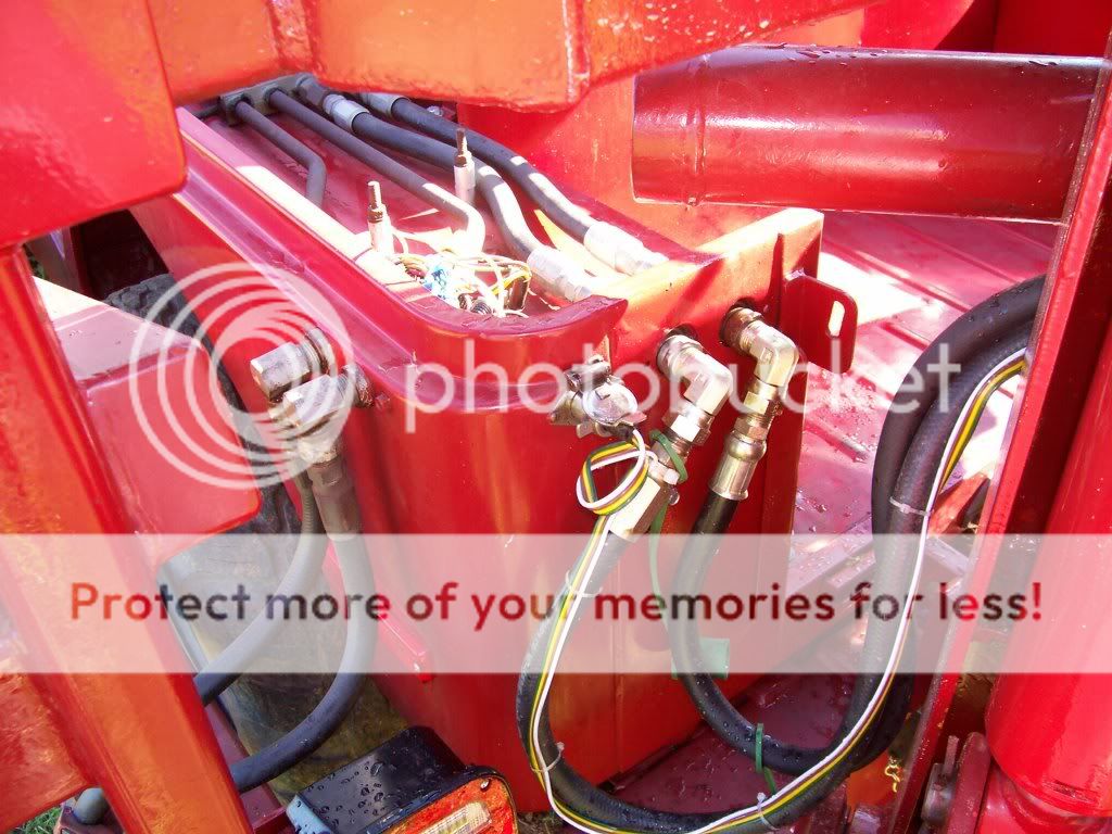

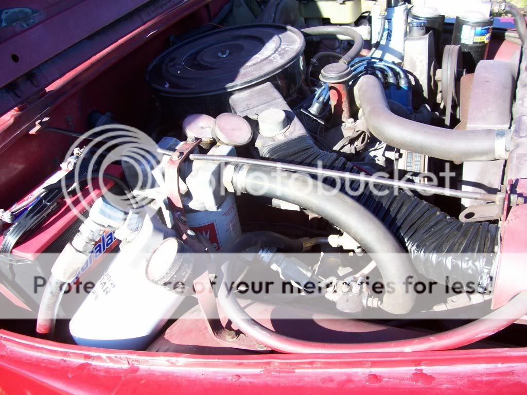

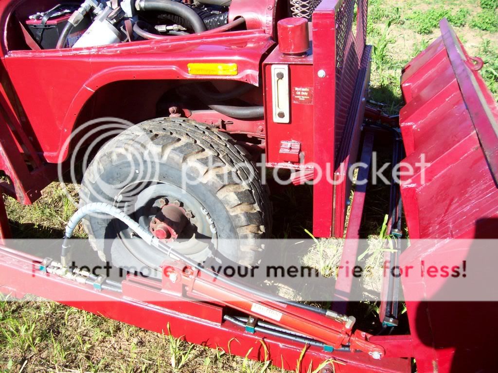

Here you can see the hydraulic filters and some of the pump.
http://i461.photobucket.com/albums/q...2/100_1655.jpg
Here is the hydraulic oil tank. The passenger fender is cut out to accommodate.
http://i461.photobucket.com/albums/q...2/100_1656.jpg
http://i461.photobucket.com/albums/q...2/100_1650.jpg
http://i461.photobucket.com/albums/q...2/100_1665.jpg
http://i461.photobucket.com/albums/q...2/100_1664.jpg
Here you can see some of the backhoe fittings. Oh what fun they were!
http://i461.photobucket.com/albums/q...2/100_1667.jpg

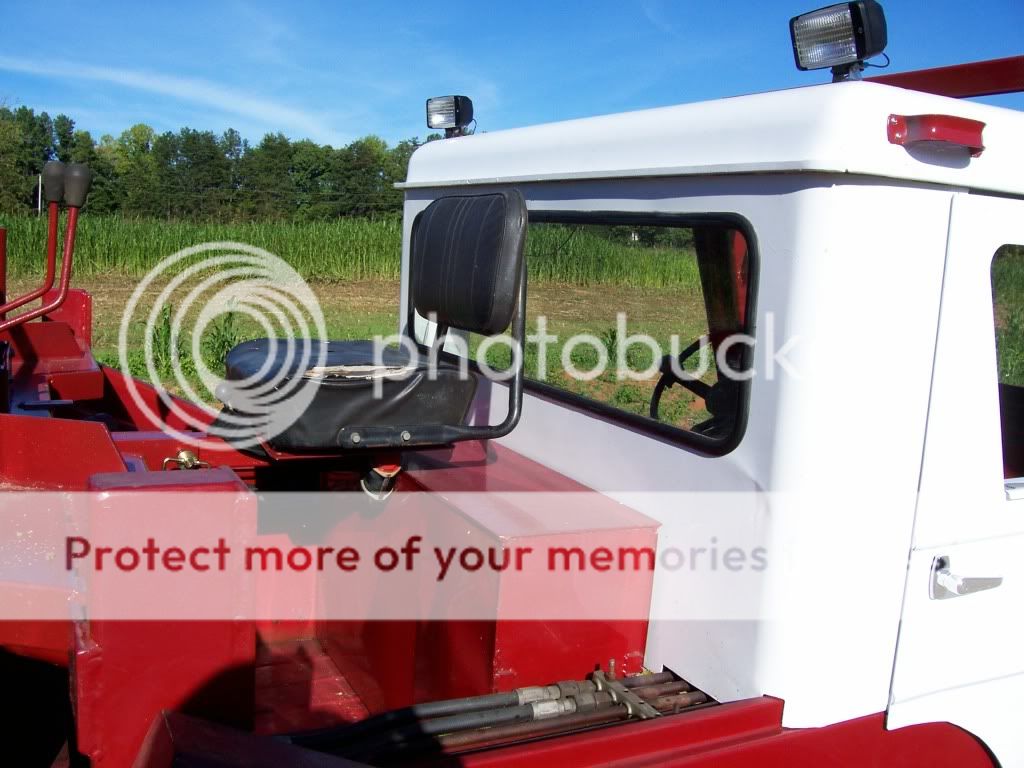

Backhoe seat and Custom gas tank.
http://i461.photobucket.com/albums/q...2/100_1668.jpg
Overall the re-creating the cab was this most time consuming. It was nearly the first and last thing that we worked on. Here is a picture of the most impressive new hardware.
http://i461.photobucket.com/albums/q...2/100_1657.jpg

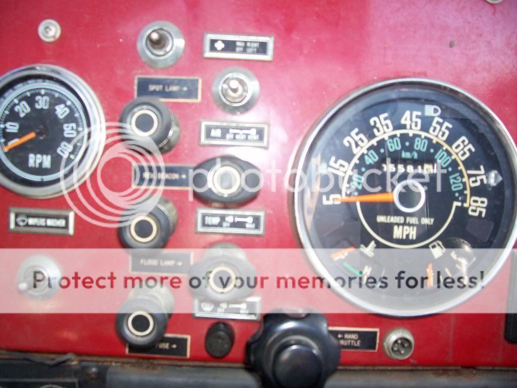

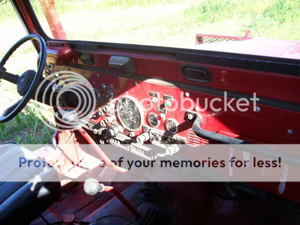

Here are some interior shots. The dash is a little more cluttered than a typical CJ. Still need to find some knobs but most everything is working.
http://i461.photobucket.com/albums/q...2/100_1669.jpg
http://i461.photobucket.com/albums/q...2/100_1673.jpg
http://i461.photobucket.com/albums/q...2/100_1675.jpg
http://i461.photobucket.com/albums/q...2/100_1651.jpg

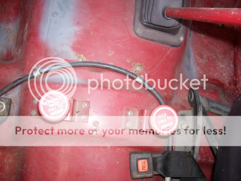

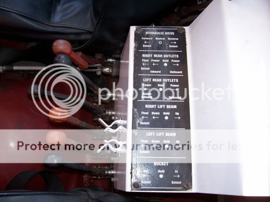

These pictures show the hydraulic drive and PTO controls.
http://i461.photobucket.com/albums/q...2/100_1672.jpg
http://i461.photobucket.com/albums/q...2/100_1671.jpg
http://i461.photobucket.com/albums/q...2/100_1652.jpg
Here is a look underneath the front. Yes the truck is lifted off the ground with the font bucket.
http://i461.photobucket.com/albums/q...2/100_1660.jpg
Both front and rear axles are dana 60
Well I hope you have enjoyed. Let me know what you think. (really)
