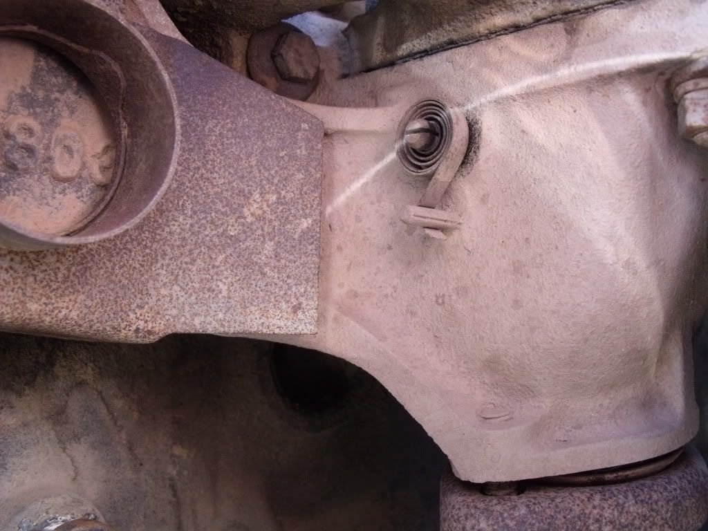

Here is a pic of the spring.

There was a spring that would control the position of the flapper. Usually rusted away as in these photos.
