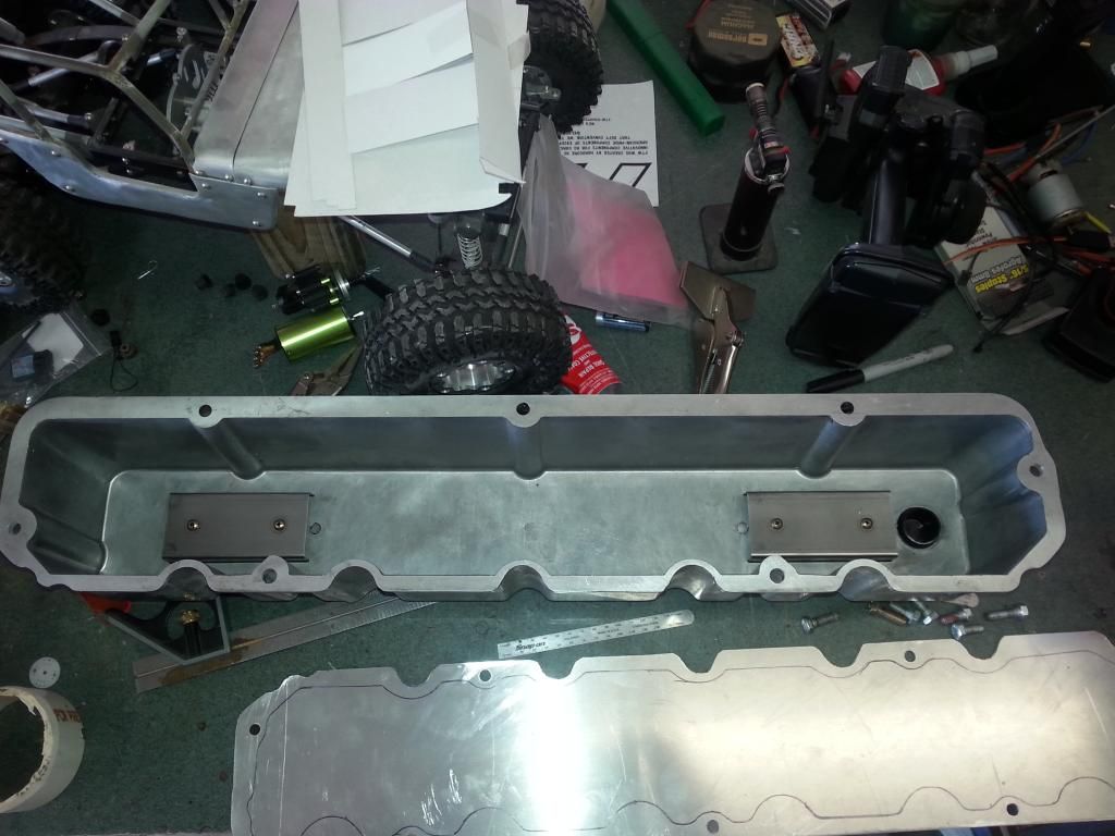

After "completion" the new valve cover leaked. Didn't match the head perfect so I made an adapter plate.
