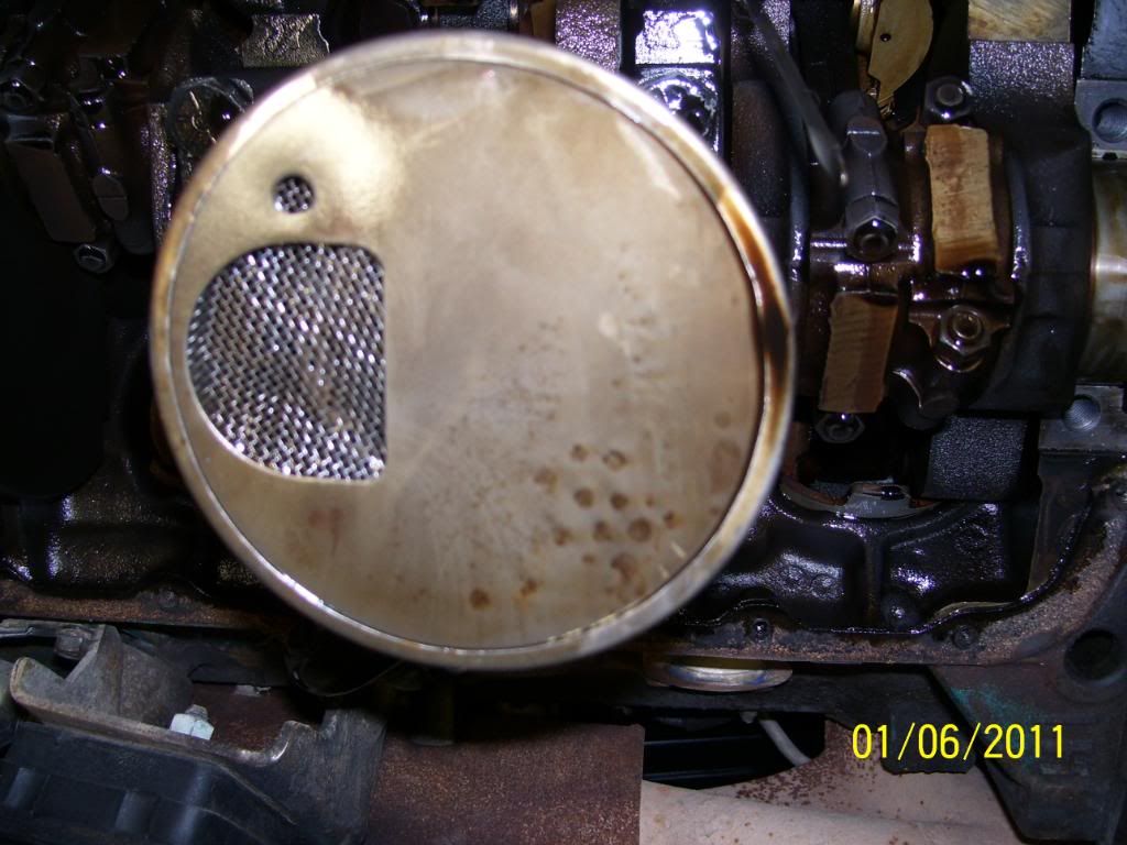

Today the first thing I did was drain all oil out of the pan

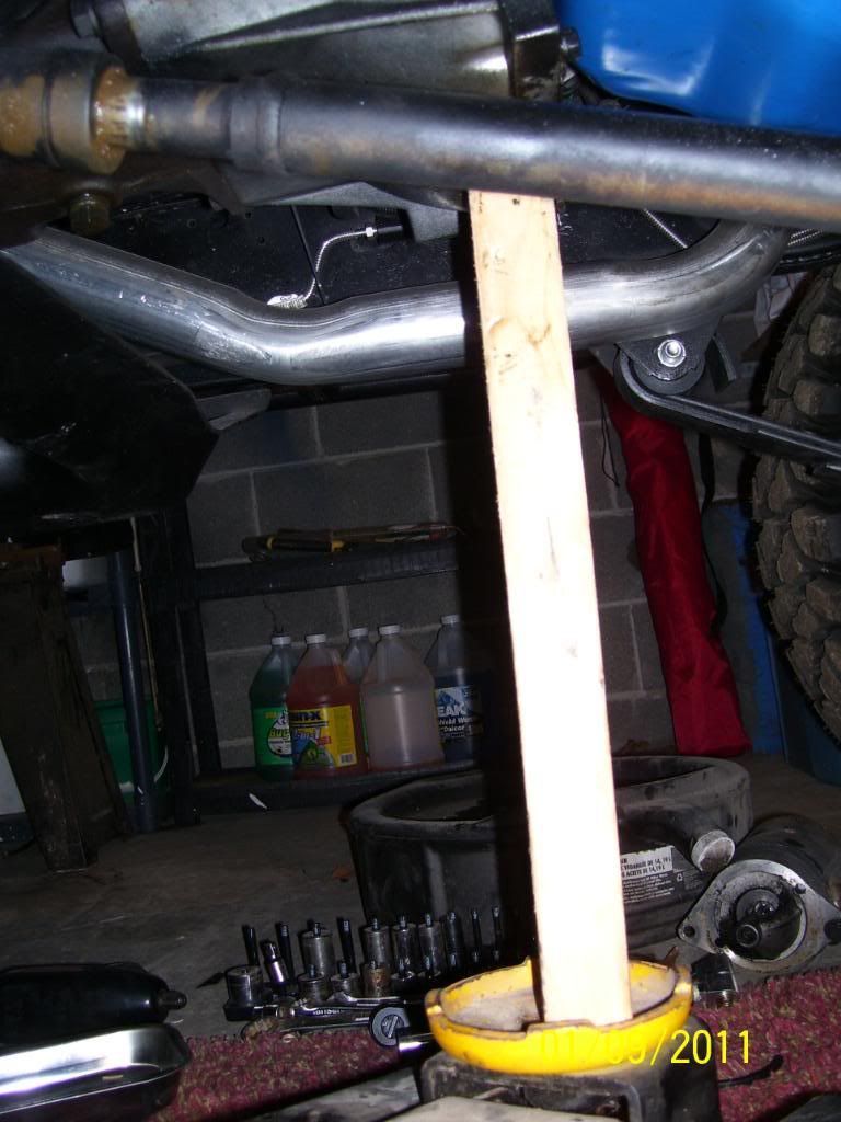

I jacked up the motor with a standard floor jack and a piece of 2x4
This picture shows how much seperation was needed from the motor mount to the block to get the oil pan off.
5) With the motor jacked up and all oil drained, I removed all the oil pan bolts.
6) with the oil pan bolts out I used a rubber mallet and a small pry bar to loosen the oil pan and had to finagle it around a little and it dropped down.

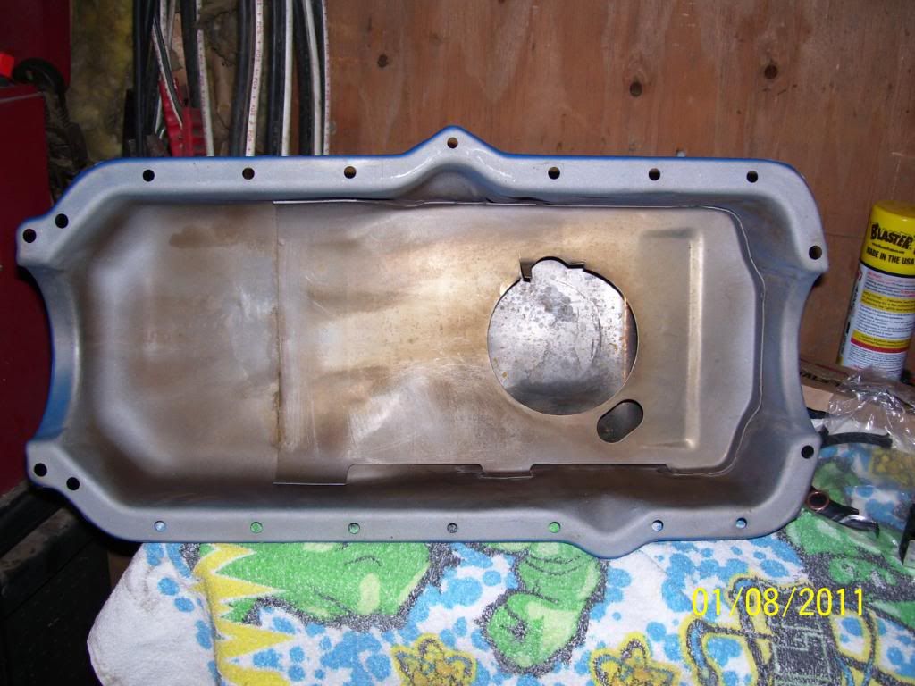

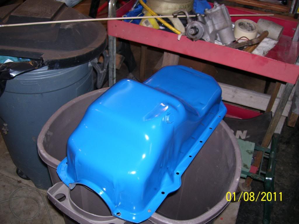

7) I now cleaned the pan up and gave it a fresh coat of paint.
I inspected the pickup tube and i looked good to me.

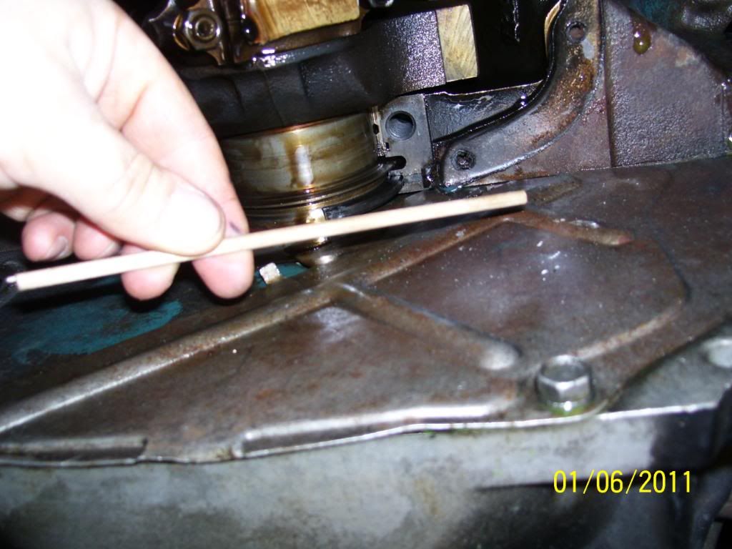

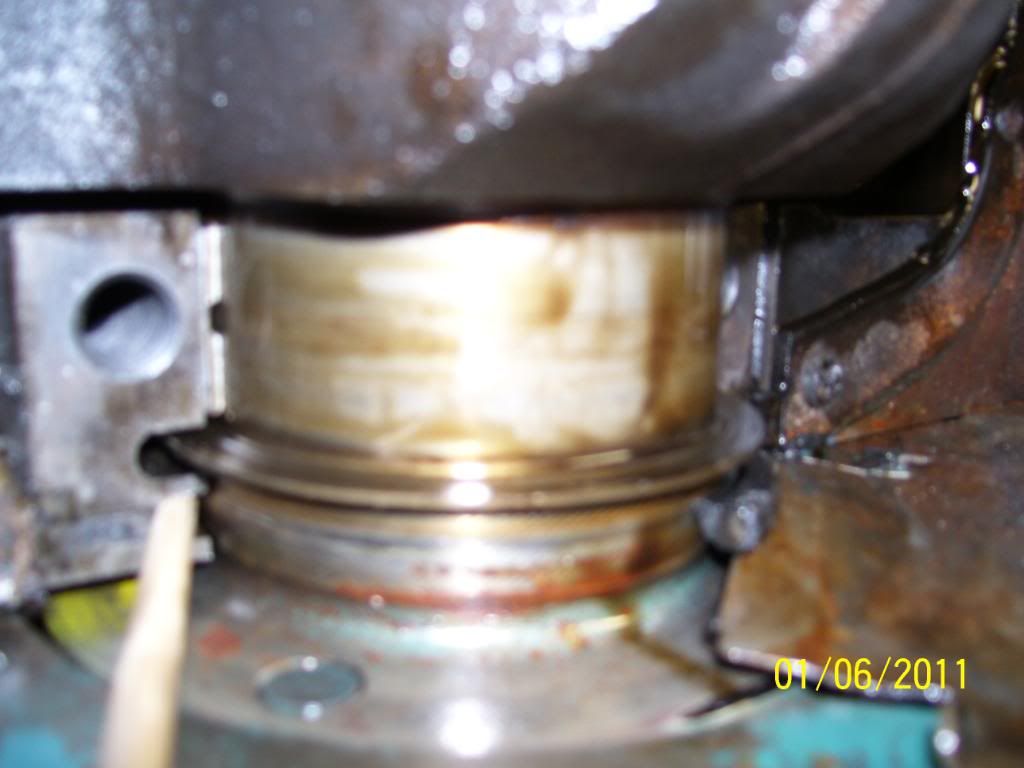

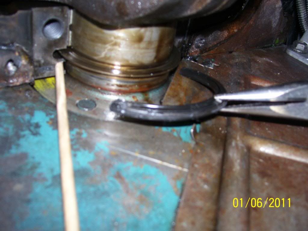

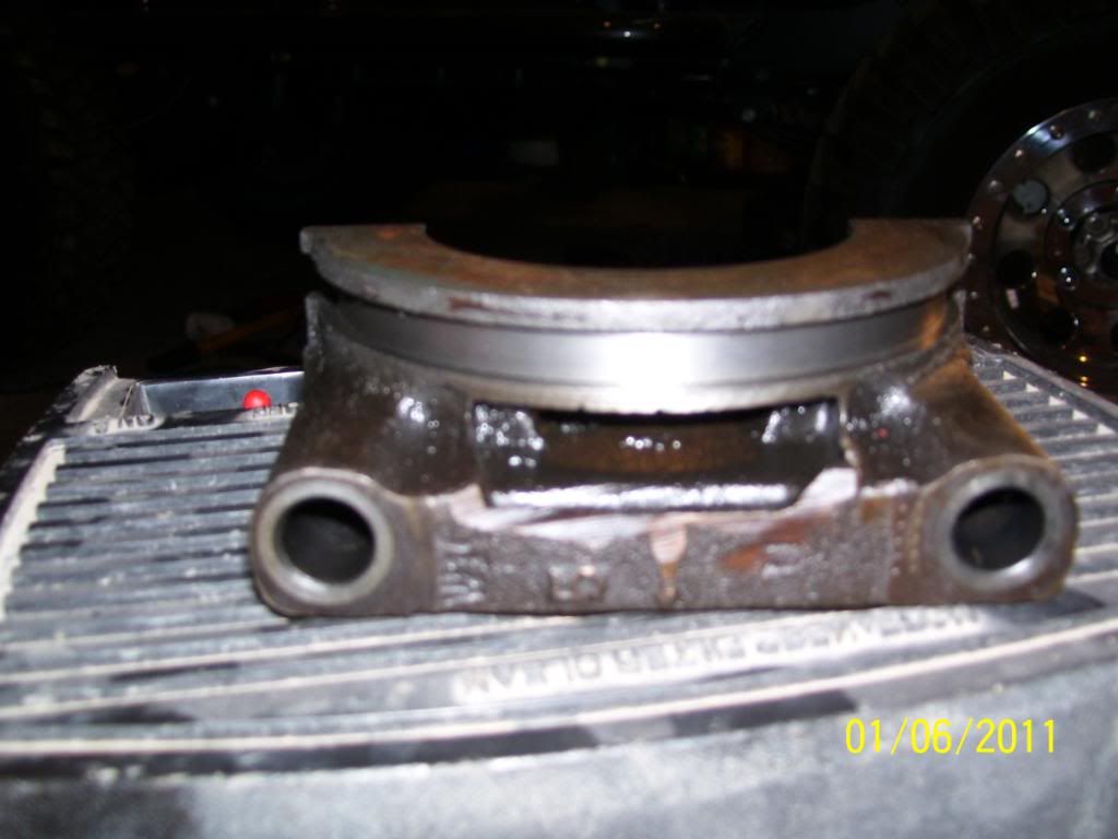

8) I now removed the main bearing and removed the old gasket from it

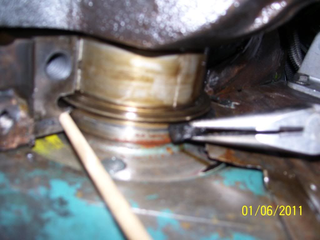

9) I am pushing the old seal out with a small wooden dowl I purchased at a arts and crafts store. I tapped on the dowl with a small wooden hammer.
With the seal removed I began to remove the old gasket
I must say the wooden dowl and hammer pushed the seal out with ease, everything went smooth today, but thats all I have time for today.

1. I didn't remove the starter I just used a long extension to get to the oil pan bolts.
2. I didn't have to mess with the motor mounts on mine to get the pan off.

One thing I would definitely inspect the oil pan closely where the bolt holes are. Its just like the valve covers if it gets tightened too much it will bend around the hole and will leak... if you have one or more that's bent you can take a couple of hammers and put one on one side of the hole and hit the pan on the other side and it will flatten the pan back out because it was smashed between the hammers. (You shouldn't hit it hard its better to use several lighter blows than one big one)

how many miles on the motor,because that rear main bearing looks a little rough.Other than that you did good
dzltech the motor has 120,000 miles on it. I kinda thought the same thing, it looked rough but it runs quite well and does not smoke and the oil pan was quite clean inside. I just purchased a 1974 AMC 360 with a R4B Aluminum intake for $325 from a friend. I got it all tore down this weekend and it looks real good inside, it will be on its way to the machine shop Monday morning. This motor should wake things up a little.

I'm changing my rear main seal and I'm having a hard time finding the seals I need. What is the name of the piece that Kpony tail took off in the above pics that looked like a half moon bracket with a seal on it? I need the seal that goes on the outside of it. Thanks in advance
Greekcj5 is offline
post #8 of 17 Old 10-20-2011, 04:27 PM
davbytrace
1979 CJ7
Location: clinton
Posts: 487
It is a main bearing cap, with main bearing installed.
