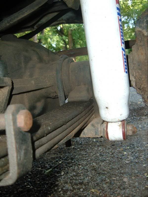

i can cut weld and grind myself, anything i dont trust myself in doing, i can ask any of the veteran welders in the shop i work in to help me out.
knocking out the blocks and that Z angle thing they put on should be easy. the one that connects to the shocks!
what im gonna have trouble with is finding out where theyre supposed to go!
also, what do i do about these?
is it suppose to look like this?

It would have been like this:
The rear shocks would have attached to a stud in the spring plate like the front.

Cut off everything the PO welded to the axle. Leave only the spring perches that are shown in spottedfrog's Picture.
Getting it back to stock, and Safe, will actually be easier than you think.
may i see a different angle of that.
What angle do you need?
lets say that angle its front to back
i need the opposite side, back to front

Back to front:
Back to front:
perfect!
is it just a stud welded on the plate?

http://s1063.photobucket.com/user/Ab...841_n.jpg.html
but what about this!

A 1/2" grade 5-8 bolt will work just fine for the shock mounts.

Originally Posted by TexasJeepyall View Post
If I'm looking at you picture right, the arrow is pointing at the ORIGINAL spring pad. You want to keep that.
