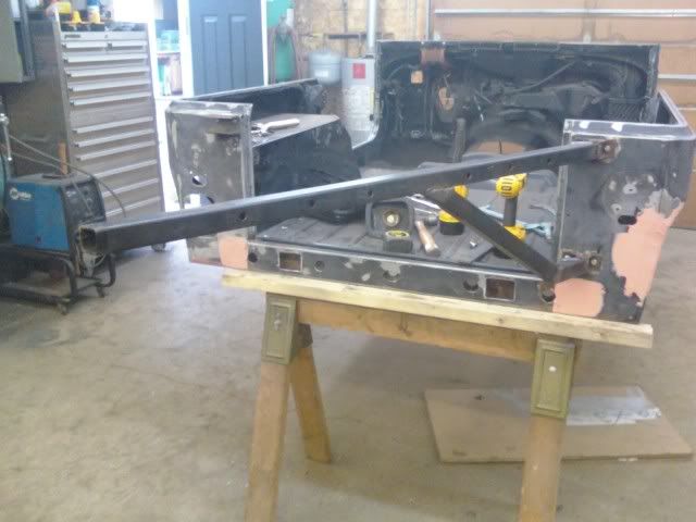

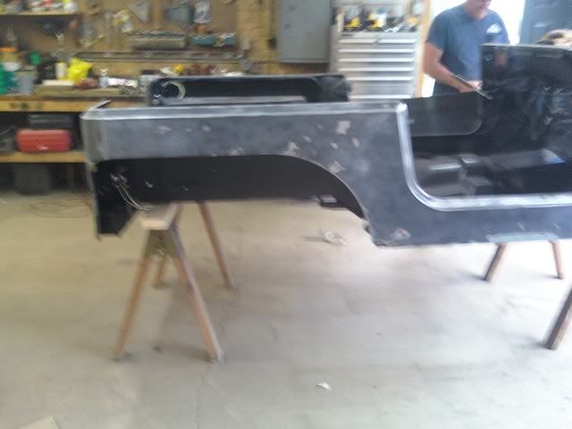

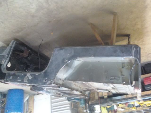

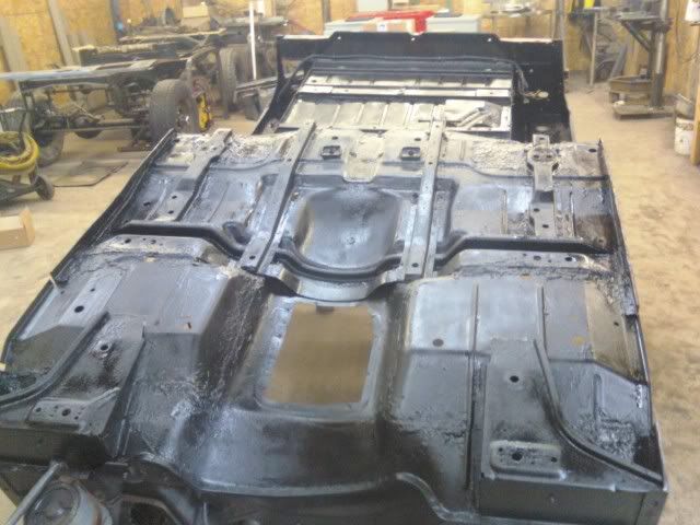

yes the jeeps upside down its not too good of a pic but ill have better to come when i flip it over after i rhino line the bottom. but i decided i am going to extend the wheel base 8 inches in the rear so i comp cut my fenders and they turned out pretty nice considering i had a grinder and jig saw and a couple of hammers to bend down a 1/2 inch lip to match the rest of the wheel well

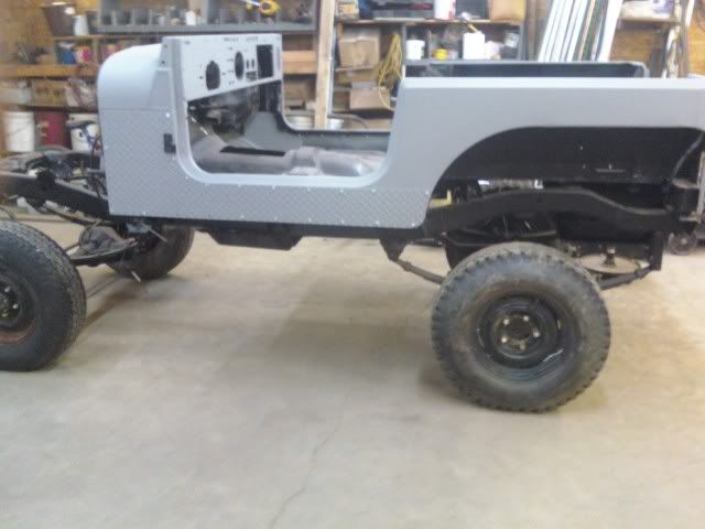

rhino lined the bottom turned out real nice
better pic of the comp cut fenders
steel diamond plate on both sides

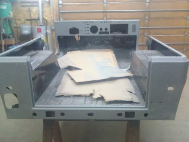

a little bondo work and ended up fabbing up a spare tire carrier out of the old yj hinges and a couple pieces of scrap metal still working on that.
all primered the dash is in which is half old half new so i can use the new glove box
put the body on to put it away in storage for the 6 months im gone but i do love how high it sits i still have to extend the wheel base 8 inches in the back thats why it looks so off. but i can easily fit 44's

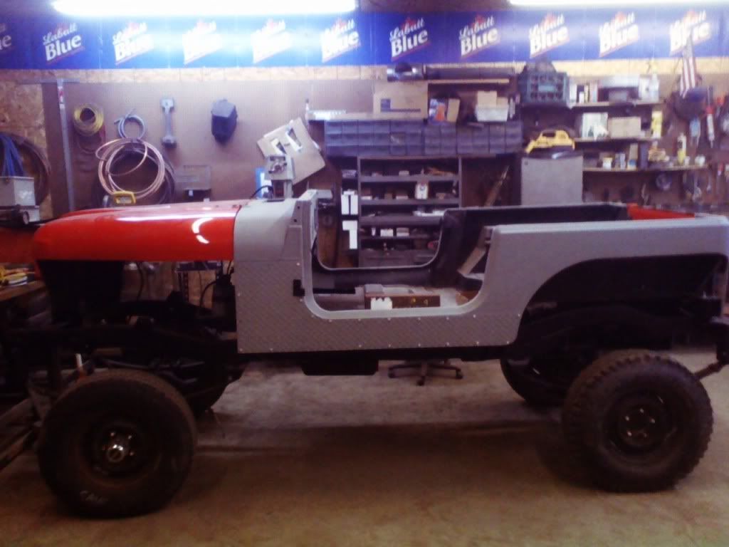

thats how it sits at home now with the rear axle extended 10" and the hood on also got the tube fenders with 3 inch flare waiting to go on
