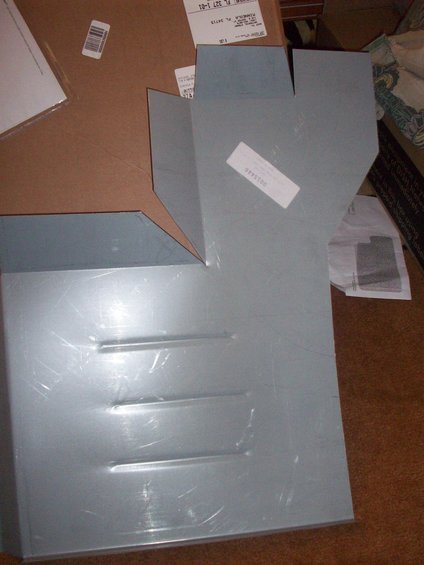

Floor Pans for in front and under the seats I got 3 of 4, the other pan is back ordered for at least a week.

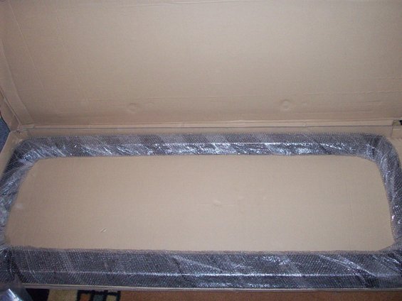

Windshield frame and windshield. The glass is being drop shipped from the manufacturer.

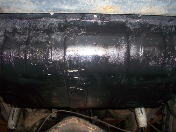

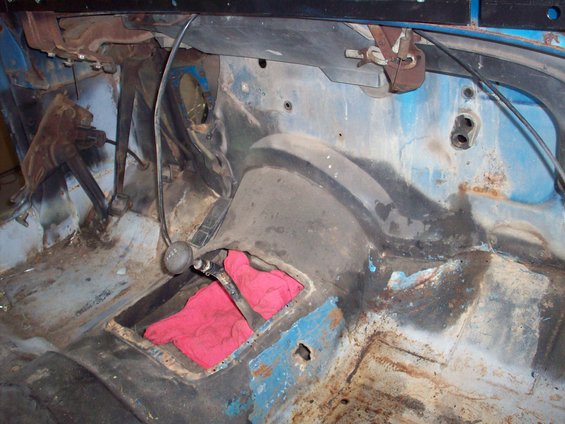

This weekend I made some progress on the Jeep. I replaced the transmission mount.While I was at it I painted the skid plate and the gas tank skid plate. I also welded in some patch panels for the floor. This weekend I am going to be rewiring it and then painting in the next few weeks.
The skid(it needs a few more coats)
The gas tank skid
The plates

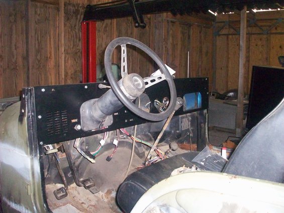

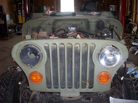

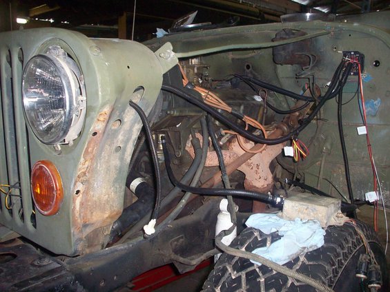

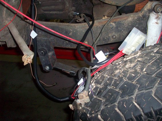

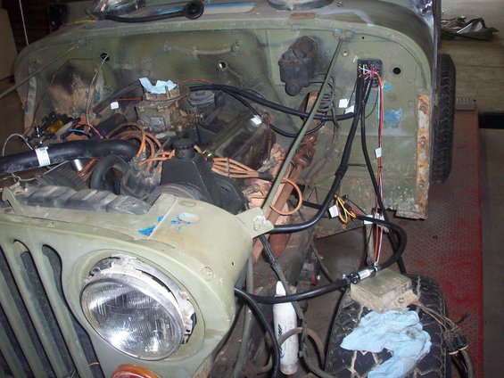

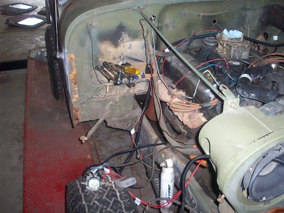

Well I was finally able to get back to the Jeep this weekend after some set backs (lost my job, then my mom passed within a month of being diagnosed with cancer) I got the new dash bolted in. and all of the wiring except the rear done. Which leads me to my problem. I got everything hooked up and hooked the battery charger to the positive and negative battery cables (per painless' instructions) go to crank it and nothing. when I turn my key it goes to start, but doesn't return. to run, which leads me to believe that the ignition might be bad, but it won't fire when I jump the solenoid either. There are wires for a neutral safety switch that I did not hook up because the jeep does not have one and it ran before I tore the old harness out. I also do not have any of the gauge wires hooked up because my jeep came with manual gauges (oil and temp) and it is not in the cards to buy new gauges atm. Am I missing something? do I need that neutral safety switch for the painless kit to send power to the starting system? I will be calling painless in the morning (it's a pain that they aren't open on the weekend ) I was just hoping that maybe one of yall could give me some insight. The plan was to sand blast and prime next weekend and paint the weekend after. now that is getting pushed back at least another week because I need the jeep running to get it out of the barn and into the paint booth. Well on with the pictures.
New dash with steering column reinstalled
Pictures of the wiring process
Possible location of safety switch?
Or?
Gave my Jeep a black eye(broke the light pulling the old harness off)
Other picture can be found on my supermotors page
http://www.supermotors.net/registry/19083
Thanks for looking and hopefully someone can shed some light on my issue.

It looks to me like your solenoid is wired wrong. This is how mine is wired up...

Nice Jeep. FYI, there's no such thing as a neutral safety switch on a manual transmission. Only on automatics to prevent you from starting them in gear. The switches you've pointed out on your transmission are for the backup lights and the other is a timing retard switch (emissions-related) that retards timing when it's in 3rd gear.

I got her to crank today. It ended up being my battery charger wasn't putting out any power, that will teach me to leave my test light and multi-meter. I did end up having to buy a new ignition switch because the old one was brittle and broke when I was disconnecting the old harness. Next up is paint.

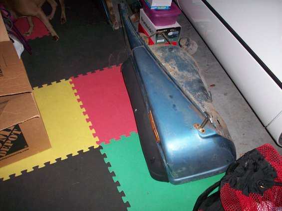

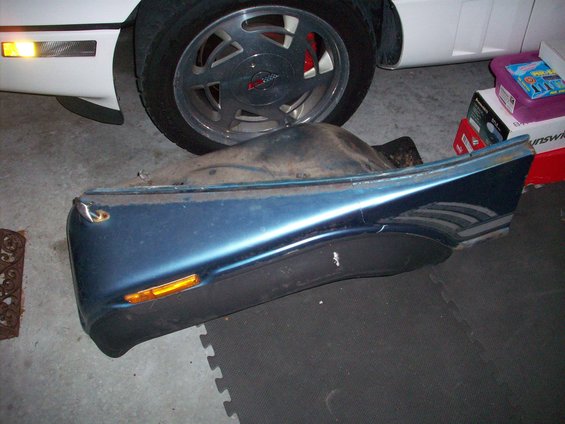

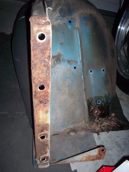

I picked up a set of new(to me) fenders today. They only have a little surface rust and no dents. The fenders that came on my jeep were more bondo than metal and dented all up. I was over in Clearwater and stopped in at Jeff's Jeep Yard and asked if they had any used CJ fenders and they did. Now I just need to find a good cheap sand blaster and someone who can weld weld my patch panels I made in. I have a welder, but I stink at it and this is something I don't want to practice on. On with the pics!
The only rust spots

I'm thinking my harness has a jumper acros the Neutral switch connector.

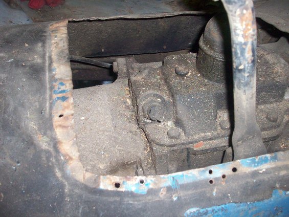

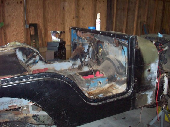

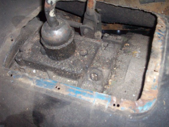

Made some progress this weekend. I started getting ready to pull the body off of the frame. All of the nuts for the body bolts have broken free and are just spinning, so I tacked the nuts to the body on the bolts in the middle of the body. The ones in the front and ones in the rear I have to buy a holesaw to get to them from the top. I also removed the top plate from my transmission so I can pull the body, I am using the lift to pick the body up off of the frame, but it does not have enough lift height to clear the shifter. The lest thing to go yesterday was the heater box, the original unit was trashed, but I found a replacement at Jeff's Jeep Yard in Clearwater. While I was doing that, my dad was busy designing and building a body cart so I can roll the tub out to sand blast and then over to the paint booth. I was hoping to have the body off this weekend, but as usual nothing with "Jeep" involved goes according to plan, so my planned completion date has been pushed back another week. On to the pictures.
The cart, we started with a cart from Tractor Supply Company that has a 1500lbs capacity and then my dad built the frames
