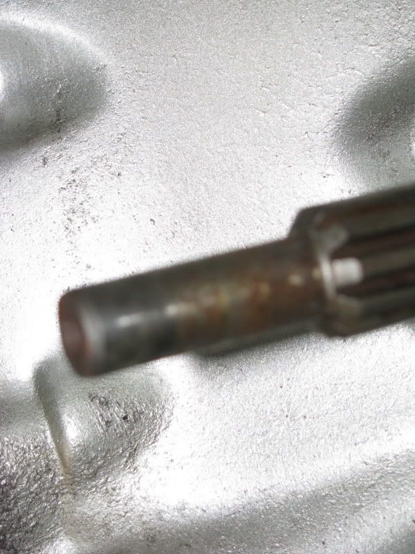

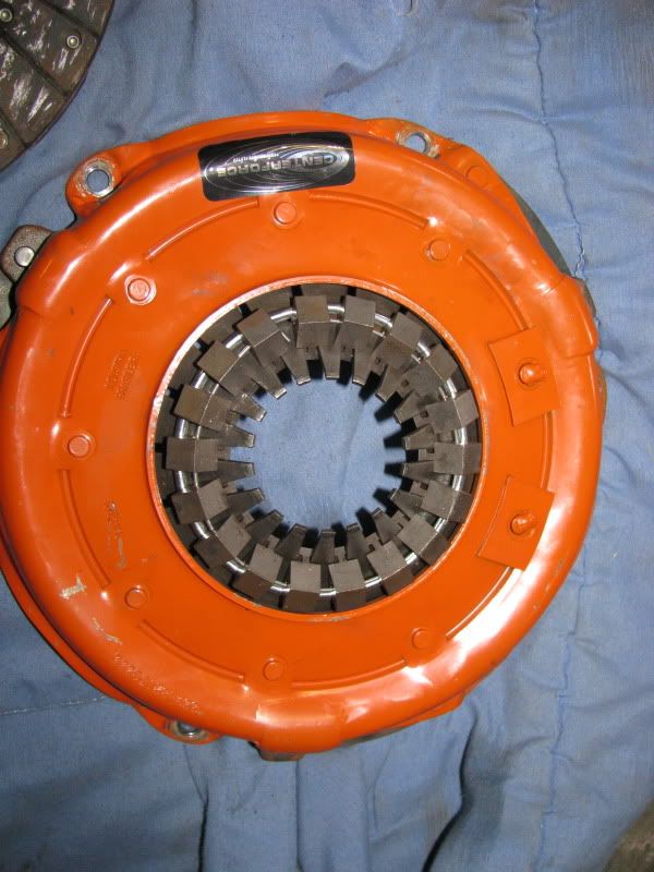

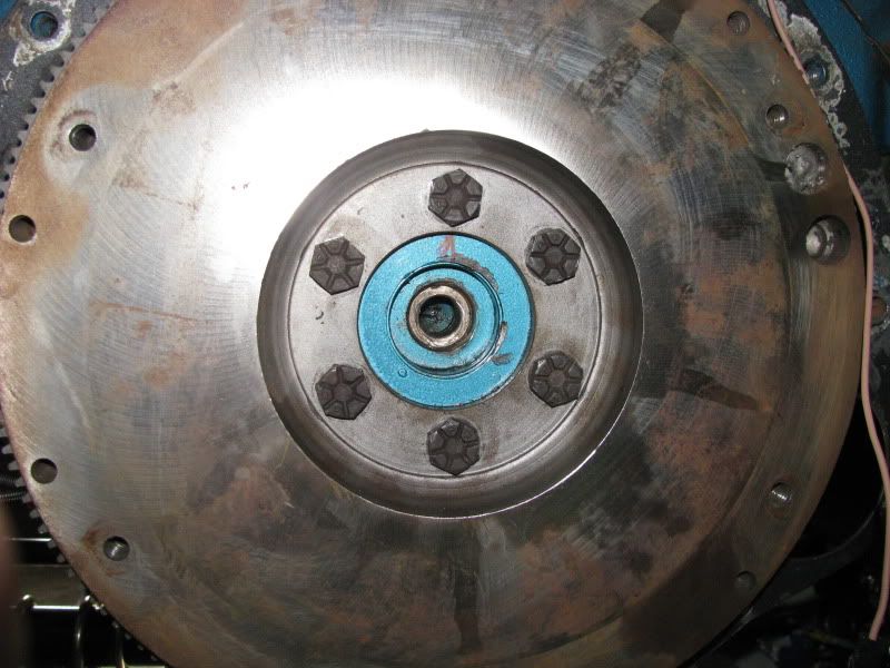

The bleeder down at the bellhousing is pointed to the side but I did try bleeding it quite a few times unbolted pointed up. I think I should be getting enough throw to at least do something.
I dropped the trans again this morning and (getting good at this only took 45 min. this time ) and took a bunch of pics to see if anything was out of the ordinary.
Looks like pilot bushing could possibly be seated a tad further?
Just1970CJ is offline
post #20 of 25 Old 10-19-2009, 09:59 AM Thread Starter
Just1970CJ
Location: Holtwood, PA
Posts: 76
also almost looks as something may have been rubbing on the bushing but its hard to tell. Anyone see anything wrong. I am about to call centerforce and see if there is something special about there throw out bearing that would make this work.

Can't see pics right now, but if the input shaft is tight inside the pilot, it might take a few miles to put enough wear on it to disengage. Mine was like that at first when I installed a new trans. Shouldn't take more than a few starts, though - it's steel on bronze.

well I was talking with centerforce and they are saying the throw out bearing I have should be fine. They are also stumped as far as what cause be causing this exactly telling me it the bolts would just cause a vibration possibly and had a hard time believing it was the throw out bushing.
They told me that once the throw out bearing makes contact with the fingers it should be about 3/8-9/16 of an inch to operate the clutch correctly. This would translate to 3/4- 7/8 inch of throw at the clutch rod which I should have plenty of travel if thats the case.
