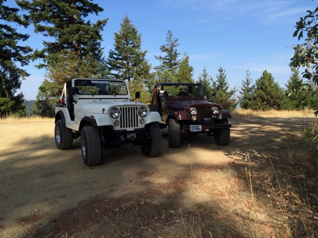

Been a while since I have updated. Haven't done much other than drive the jeep!! Installed a set of NOS Warn hubs and. Set of NOS steps. Will take pictures tomorrow. I will say it has been an memorable and fun/great experience building this with my father in law. All that is really left is paint and some odds and ends. Any suggestions??
Here's just a few shots of mine and his together. His is an '81

Been a while since I have updated. Haven't done much other than drive the jeep!! Installed a set of NOS Warn hubs and. Set of NOS steps. Will take pictures tomorrow. I will say it has been an memorable and fun/great experience building this with my father in law. All that is really left is paint and some odds and ends. Any suggestions?? Here's just a few shots of mine and his together. His is an '81 Sent from my iPhone using JeepForum
