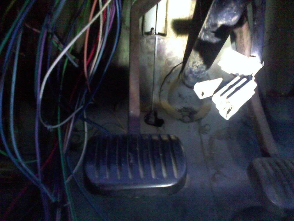

hey yall i got a 72 cj5 304v8 with a t15 three speed.my question is how is the clutch cable routed and how does it attatch to the floor board.i just have a hole where it comes up through and when you push the clutch it does not move the clutch fork or do anything a picture would be great from on top and under the truck so i can figure out what i got goin on here.also how is it routed under the truck im wonderin if im missin a bracket or something i got like 3 feet of cable just stuffed up under the frame

The stock pedal end should have a clip that retains it. This end is pushed up from under the floorboard then the clip installed. The cable is routed between the frame rail and the body in a loop back to the bracket on the side of the transmission.
These cables are prone to failure. The early ones would simply pull up through the floorboard. All are prone to seizing and sticking. The simplest upgrade is to find a 73-75 pedal and bellcrank assembly complete and swap it in. Others have installed a later CJ hydraulic setup.

You may want to look at upgrading to the linkage style. My '72 had the cable originally, and it never worked well. The kit from Quadratec should work perfectly for you.
Part "A1" in the diagram Clutch Linkage Kit
This is how I mounted it in my '72. the transmission bell housing had the two holes to mount one side of the linkage, and I had to drill the holed in the body tub to mount the other side.
