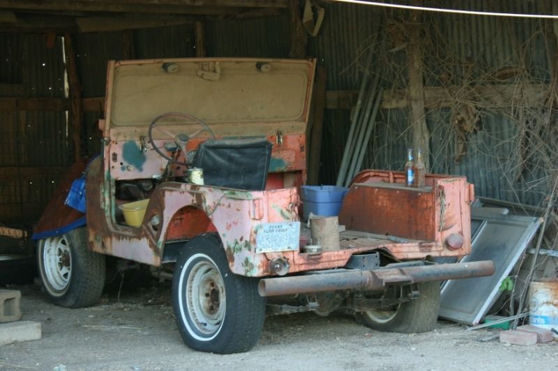

Ok, here's the pics. First one is how the it looks now- the fender is off, revealing a bunch of wires that I had to cut because I couldn't get them off using normal means. I plan on putting in a Painless kit anyway, so there's no point in keeping it. That long pigtail-covered cable goes to the e-brake handle.
Second pic is the hood and fender, lying up against some barn detritus. The pen is actually for the dogs so when we're not up here, they'll have a dry safe place to hide out during a rainstorm.
Third pic- can someone confirm that this is the union for the rear brake lines? It looks about right, but my Haynes manual doesn't say anything about brake line replacement and my dad's FSM vanished two mechanics ago.

Your faded surrey pink may in fact be faded Indian Ceramic, a really cool period color. One clue is the matching steering wheel.
Ya that's the brake line union.
I suggest you get a pack of matches and set fire to that Haynes manual. It will cause you much grief with misinformation and missing information. Get a Factory Service Manual for this Jeep, you won't regret it. Many sources to find them in print, ebay and www.thejeep.com come to mind.
This looks like a good salvagable/restorable early CJ5.
Do you plan a factory restoration, or a resto-mod (restoration appearance with more modern safety/driveability upgrades such as saginaw steering/11" or disc brakes/modern wiring with fuses, etc)

I did a little google work on Indian Ceramic jeeps, and I noticed that the Tuxedo Park models had wheel well cushions with snaps on them. My wheel wells also have snaps, so maybe this was one of those models? They certainly aren't in the right spot for a soft top.
Not until I can get an FSM in hand. I'll have to try the site you listed, although last time I was there I couldn't find one for anything before the '70s. Once I've got one, we can see about a good Haynes-burning.
Resto-mod. Some of that isn't entirely my choice; the electrical system was toast when we first got it and a Painless kit seems like the best choice for that. But for now I'm just trying to focus on getting it driveable again. The fiberglass body, Chevy V6, and brake upgrades for pulling small trailers are all going to come later.

They don't have the indents, but you also don't want these fenders. Way too much bondo. Which is very troubling because the metal's sound enough to have not needed any bondo. Like I said, if the mechanic who put that fender back on was still alive, I'd phone him up and give him a good piece of my mind.
Two more pics, trying to nail down for sure whether its a Tuxedo Park or not. This could seriously affect how much modding there is in "resto-mod." First up is one showing where the snaps are on the inside of the wheel wells. I'm mentioning these because I saw some pics on another board, of a Tuxedo Park which claimed that they had these special padded armrests that snapped down. I certainly haven't seen another Jeep with those.
Second is the word "JEEP" on the passenger's side. I got to thinking and remembered an article somewhere that said all the Tuxes had the word "JEEP" in all caps, instead of "Jeep" like all the other Jeeps. Dunno how accurate that article is, but here it is just in case.
