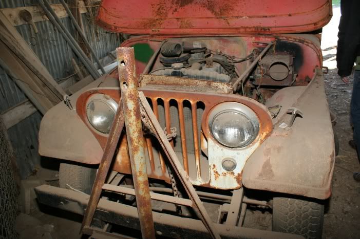

Ok, so as I mentioned in the introductions thread, my dad has a jeep in a barn that I want to fix up. More after the pics, which I also posted in the "ugly jeeps" thread since it does seem to qualify right now.
So here's the lowdown: the only parts I can be sure are decently good are in the engine. Its an old Hurricane inline four, which means a very low top speed and decent enough torque if you lock the transfer case into double low. It *should* have a Borg-Warner T-90 transmission with a Spicer 18 transfer case, but dad's mechanics spent all their time wasting time on the engine instead of checking out the transmission and everything else.
The engine is also missing some of the clutch parts.
The brakes go to the floor. Since they're something that's really good to have if you plan on towing it without having to rent a Uhaul transport, I plan on getting these fixed first. I've got the tools to bleed them, including a small hand-operated suction pump to help remove any solid residues that might've built up.
The hubs are gone. As in, the last mechanic had them disassembled when he got laid off and we had to take the jeep back in a hurry because the remaining mechanics didn't want any 4x4 vehicles in their shop, particularly ones more than five years old. So I'm going to have to completely replace them since the original WARN hubs went missing during the move.
The electrical is a bloody mess. I'm going to have to get in a Painless kit, no question about it. And while I'm at it, replace the crusty old generator with a modern alternator.
It has a definite list because one of the leaf springs is much stronger than the others- cause its new and replaced a broken one. Now the other three are the weak ones. Good going, dad.
Rims are a total loss. After three cans of fix-a-flat in each just so we could get enough air in them to put them on a Uhaul, about all they're good for is dumping in a hole and burying.
Body tub is in really bad shape, too. Its got some real bad rust in areas where it shouldn't, but unfortunately as the most expensive item, its also the last one on the list. Lots of bondo on the front fenders as well.
And the passenger's seat is completely missing. It vanished several mechanics back.

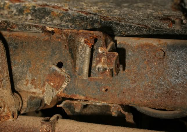

Ask and ye shall receive, although I'm missing a few of relevant areas. The whole shebang is up on a mix of concrete blocks and flat stones stacked up enough to serve as surrogate jackstands. We've got real jackstands too (open to suggestions as to where to put them to properly support it), if I can get dad to find the remaining three.
SKT- Might want to make a note that its not really abandoned; its more like a 20- year work in progress. And mom uses it as a resting place for her laundry basket.

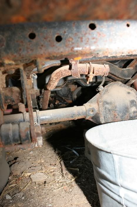

This is the rear bumper. Its made out of some kind of oil pipe. The body was deformed when we had to use someone's tractor to push it up onto a Uhaul the last time- you'd think they'd equip the blasted things with winches like on the boat trailers.
Undercarriage showing the rear diff and the PTO cover on the back of the transfer case. One of my goals is to replace that PTO cover with a Novak one. I know the muffler's missing; I can worry about that when its inspection time.

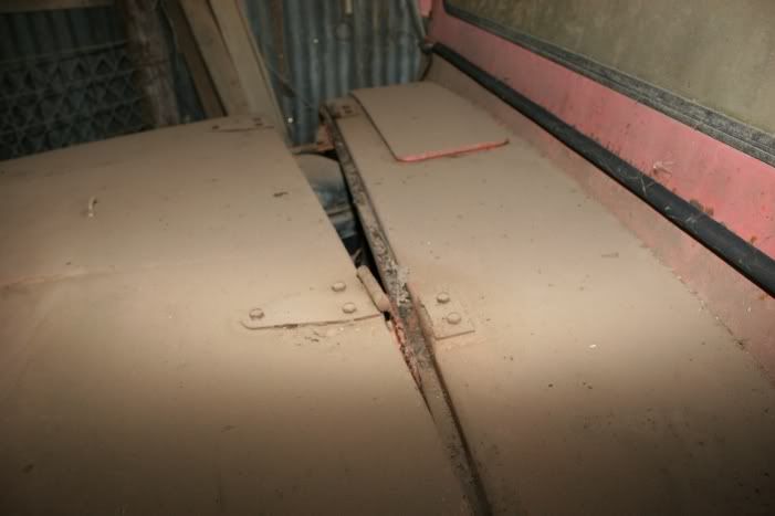

Broken hood hinges. I have an idea on how to fix this. So does dad. We don't see eye to eye on it, but this can also wait until much later since I don't think you even need a hood to pass inspection.

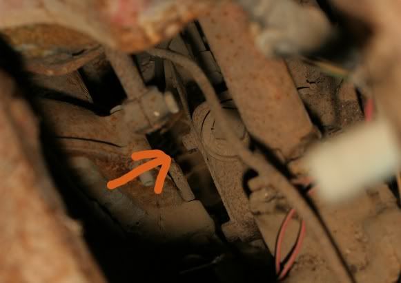

Now the real bad news. The transmission appears to be totally STUCK in neutral. As in, I can't get it to shift. Dad says its because "it doesn't have a clutch plate." My answer to that is "lolwhut?" since if it didn't have a clutch plate, wouldn't it be able to shift freely?
When I got the back up on stands, the rear axle behaved strangely. If I turned one wheel, the other would turn the opposite direction. Is that supposed to happen?
