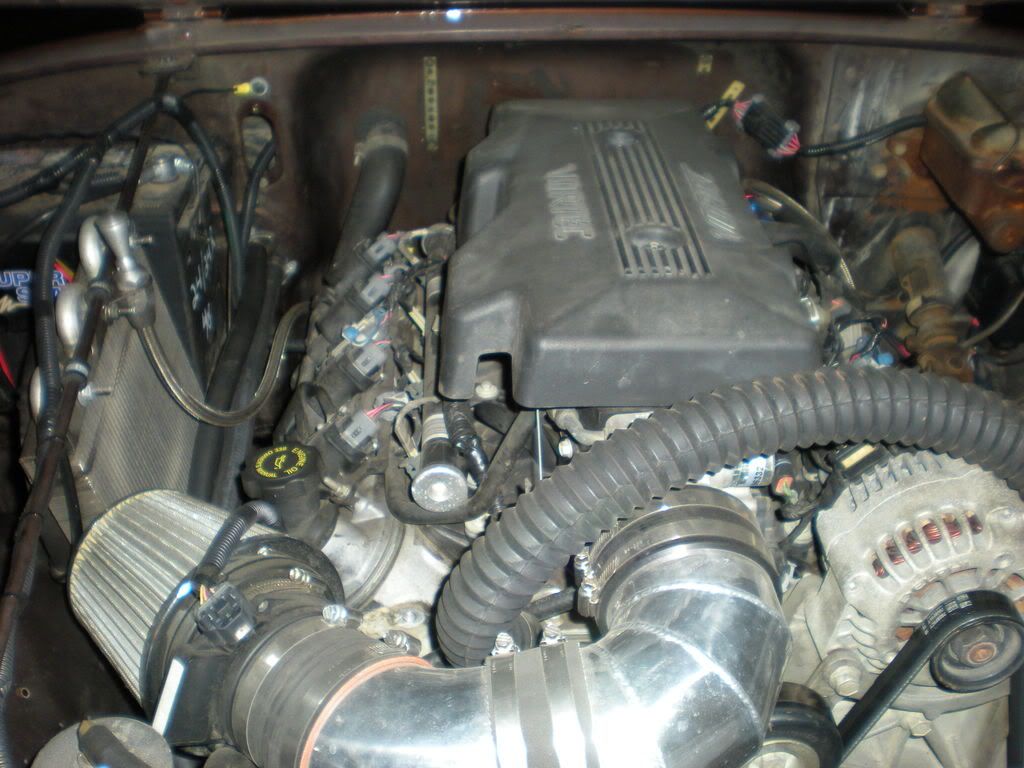

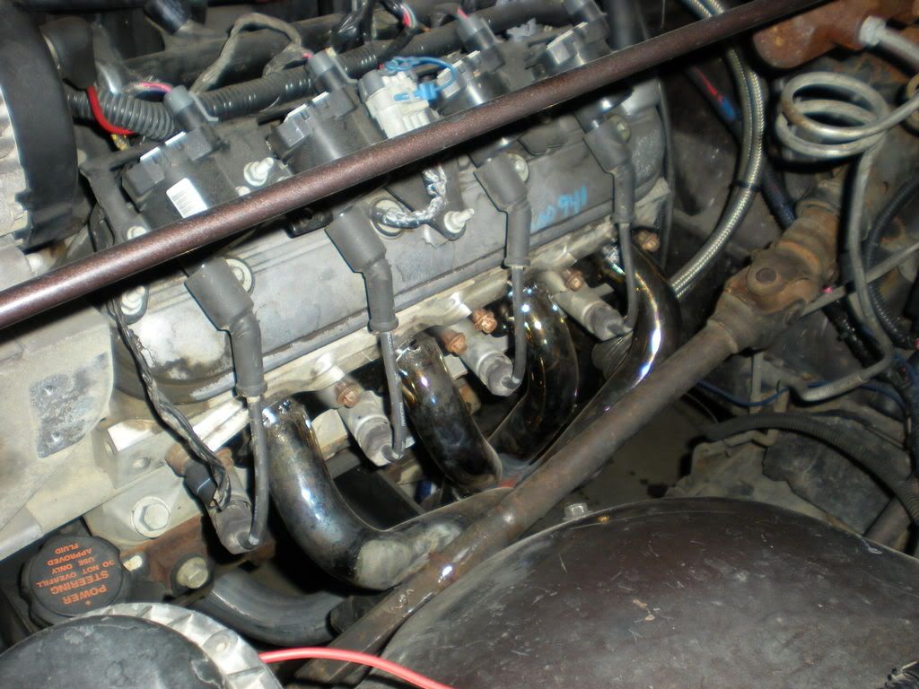

I did the 5.3 swap and its been great! (now that I'm done with it!) It had its headaches but a lot of that was because I went with the matching 4L60E which forced me to mount the motor as far to the drivers side as I could so the front driveshaft would clear the tranny pan, this in turn had the header rubbing the steering column. I got it all sorted out but it would have been much easier had I gone with a manual trans like you are planning to. you should have it much easier.
IF you go with the Vortec motors made after 2002 (I think) you have to get the gas pedal from the donor vehicle as well since its throttle by wire instead of the good old linkage throttle. Obviously you need to get the computer too..
Here's a couple pics of my setup.
Here you can see the exhaust rubbing the steering just a bit, older pic and has since been fixed

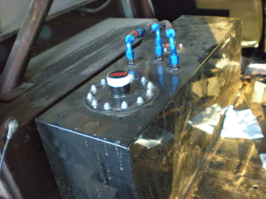

I went with a fuel cell in the back behind my drivers seat and inline fuel pump mounted to the frame below. I couldnt find an in tank pump I was pleased with that provided that much higher fuel pressure required to operate the Vortec motors.
