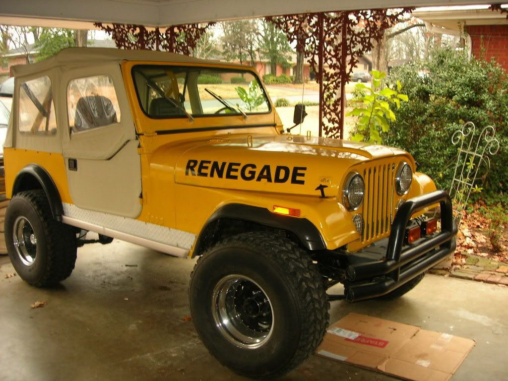

I found this when I was looking back a few months ago...maybe it'll be helpful to you. Be sure and look at the CJ section (2nd one down) and not the YJ or any other section.
http://jeep.off-road.com/jeep/articl....jsp?id=261349
I have 33's on my stock '84 Jeep CJ7 (no lift) and don't have any problems. I finally got to take it out into a gumbo rice field last weekend and it performed awesome, very minor rubbing of the plastic fender flares. Any other time I don't have any rubbing at all, it was just the major trenches that a combine made that made my tires rub. I'm not saying that it would be the same for your Jeep, but that's what mine does.
