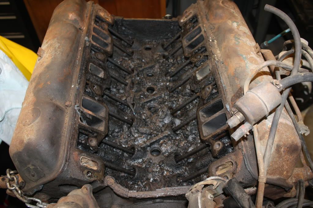

I bought a 360 out of a 90 Wagoneer. It ran very well and had 120,000 miles on it. I am goin to try to boost the 145 HP a little with an Edelbrock RV cam, performer intake, 650 cfm 4 barrel carb, and headers. I tore it down to a longblock last night and it was pretty clean except for the EGR ports and valley pan had about 1/2 to 3/4 of a cup of carbon build up. For the most part it is solid chunks stuck to the block that can be removed easily.
Question is-
Is this a large quantity that I should address by taking it in to a machine shop or should I just clean it up put the thing back together with my new cam, intake etc and drop it in my '79 CJ7 and go?
Thank in advance

My opinion, I would take it to a machine shop and have the engine freshened up before I would start dumping money into a intake, carb, headers etc. You could do the RV cam during the rebuild. With 120,000 miles, it might be due for a rebuild.
Have you done a compression test or leak down test?
You could always add the intake, carb, headers later. This way you know that your are adding to a good base.
Heres my 360.

Originally Posted by Chili4me View Post
That is way worse than mine. I'll post a pic tonight.
Yeah, another $75 special. I have to repair a chip by the back seal then its off to the machineshop for dipping and inspection.
