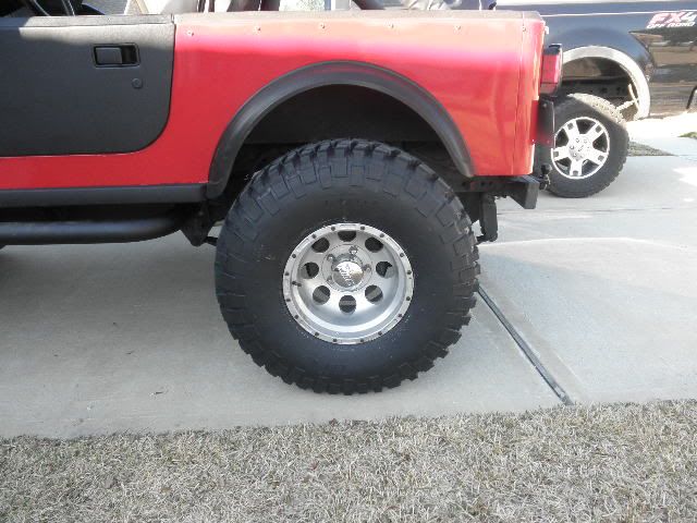

Here is mine on 33's with a 4" super lift and a 1" body lift.
Dave in Muskegon

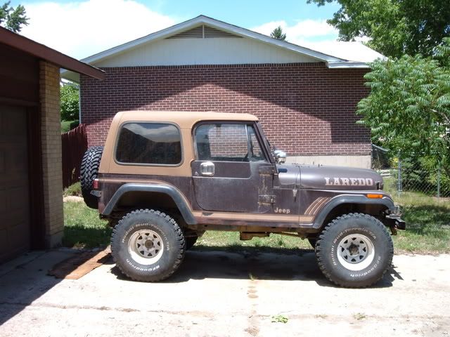

Here's a crummy pic of my glass/kevlar tub w/ 4" ROUGHEST ride COUNTRY lift and .75" shackles. If you can make out the tire they are 33" BFG A/Ts. There is a 12" gap. I wanna go w/35s. Since the springs won't flex I don't have to worry about the tires hitting!
If they don't settle by fall, I'll pony up cash for decent springs. Likely SkyJacker soft rides.
The rear is a D-44 w/4.10 Yukon gears and a Tu-Trac. Tru Trac doesn't reccommend anything over 33s for their unit.
As far as tires go, G-Year seems to be the only ones who give out actual specs.
