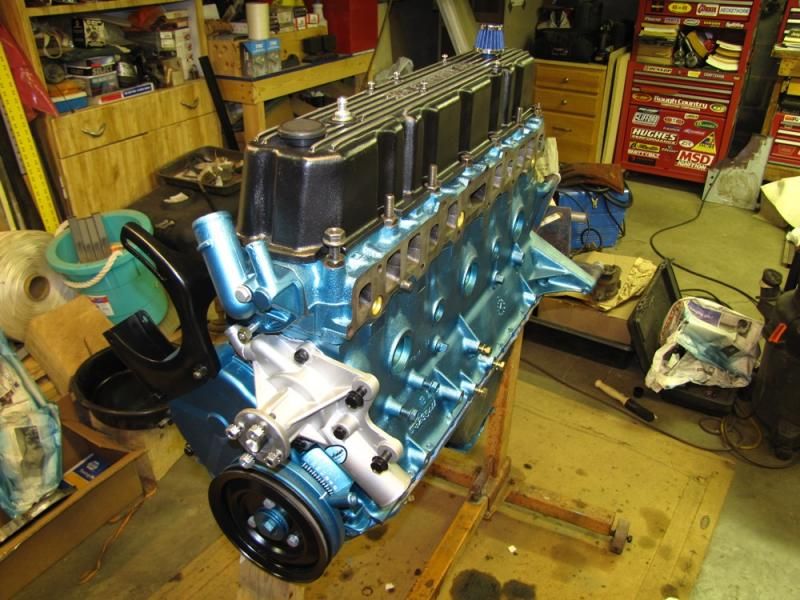

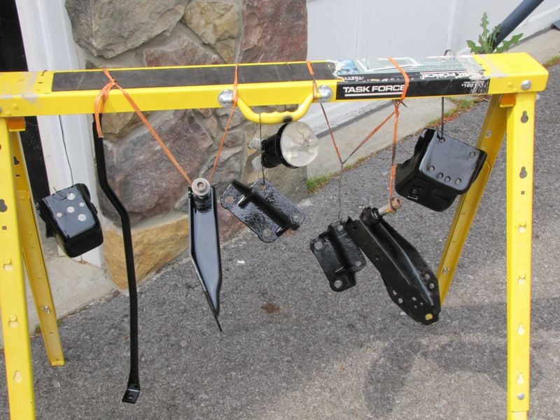

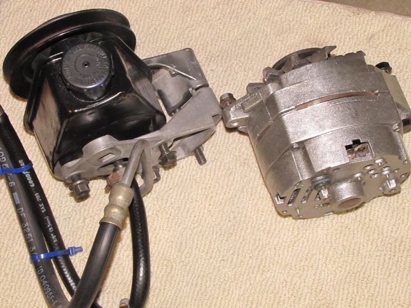

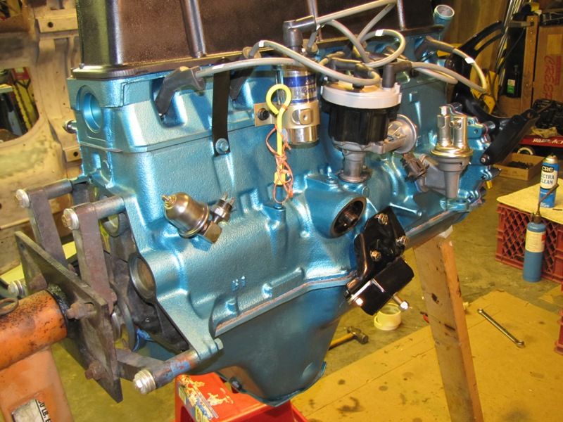

Not much new happening to write about but I’ll post a few pictures. Been working on cleaning up and painting engine bay peripherals and brackets, and doing little odds and ends. I figure they have to get done sometime and it’s less I’ll have to do later once I’m putting it all back together and need that part. Starting to address the tranny and t-case and change those fluids and any worn parts. No rebuild or disassembly for them. Also have been removing the axles from the old frame and suspension so I can sandblast those and have some work done on them.

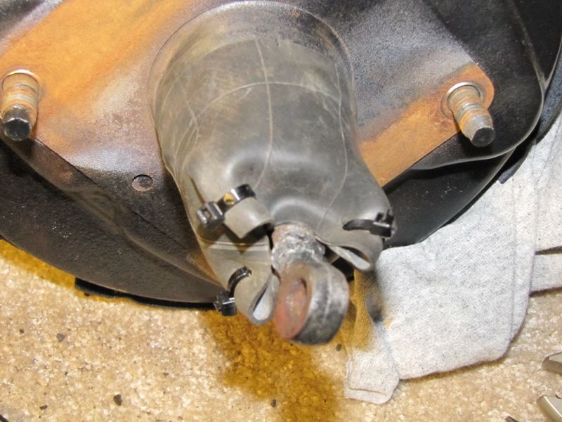

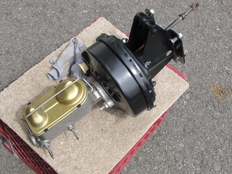

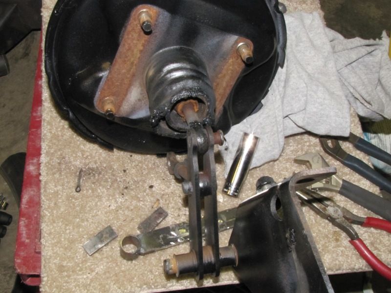

I had to repair a rubber boot on the back of the power brake booster that had the end rotted off. I used a bike innertube and pinched the ends shut some with zip ties. It’s not totally sealed but pretty close and much better than it has been lately.

Here’s the pass. side of the engine. Not much to mount there. I’m leaving the other side bare for now so I don’t have the added weight of the manifolds setting on the engine stand that I don’t have a ton of faith in, plus it’s a 3 wheeled one and not 4, so the tipping factor is there. And it’ll be easier to maneuver into the frame to mount. I had all the black brackets and a pulley powder coated.

Brush painted some parts with POR-15 and BlackCote that will mount to the frame.
2211
Misc. cleaned and painted engine bay parts.
2228
2190

That engine sure looks great!! Nice work.

Thanks Jim. I wish I had a better 4 legged stand cause I'd love to put everything back on it then set it out of the way. Then it's all done and taking up less space. I can't wait to see what it'll look like too! But I guess it's like everyone says when havin' a baby, "I don't care whether it's good lookin' or not, as long as it runs, that's what matters!"

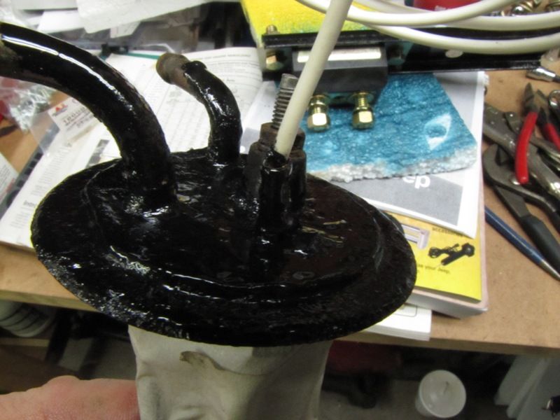

Still working on the smaller stuff, cleaning repairing or painting. I put a poly gas tank in years ago after replacing 2 metal tanks before that due to rust (there’s that word again), but the top of the sending unit is still metal and looking a bit shabby, as is the ground wire to the frame.
2282
The tab connector for the wire seems to be spot welded fast and is still holding on well (at least for now) so I figured I’d just cut the old wire off and solder a new one on. I kept a short piece of the old wire on it to wrap around the new one. I was able to pry open the top 2 crimping legs to slide the new (heavier gauge) wire into it, then I wrapped the old wire around it and soldered them together.
2284
Then I took a copper ground crimp used for solid strand home wiring (Romex type) and slide that down over the soldered connection and crimped it. That should keep the old tab, which was just a spade terminal bent 90*, from being easily bent and snapped off. Then it all got a coating of POR15 to stop the rust. I'm pretty sure I'm going to put an access panel in the bed directly above the sending unit, so when it goes bad it'll be soooo much easier replacing it.
