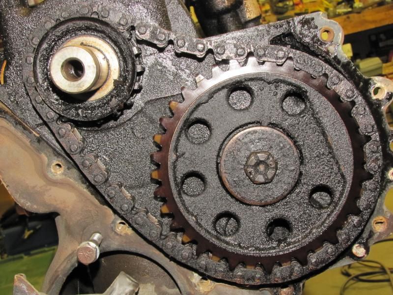

Before I popped the head off I wanted the block cleaned of the old paint and what little grease there was. I tried some citrus stripper, which you can do indoors, but that didn’t work too well and the wire brush was taking a while. And since the sandblaster was handy I decided to make short work of the job. I taped or otherwise sealed any hole up and wrapped the distributor and went to town. I didn’t bother with the oil pan since I can remove that and do it later. Besides, it was cold and windy outside so I wanted to get finished.
So here’s a few pics of what I found, which was nothing out of the ordinary for a 150k +/- engine. I have to order the timing chain set yet and then I’ll pull that cover off and change that out. I also got an expansion plug set for the block and ordered some small brass ones(7/8”) for the head.

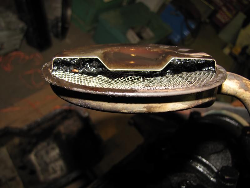

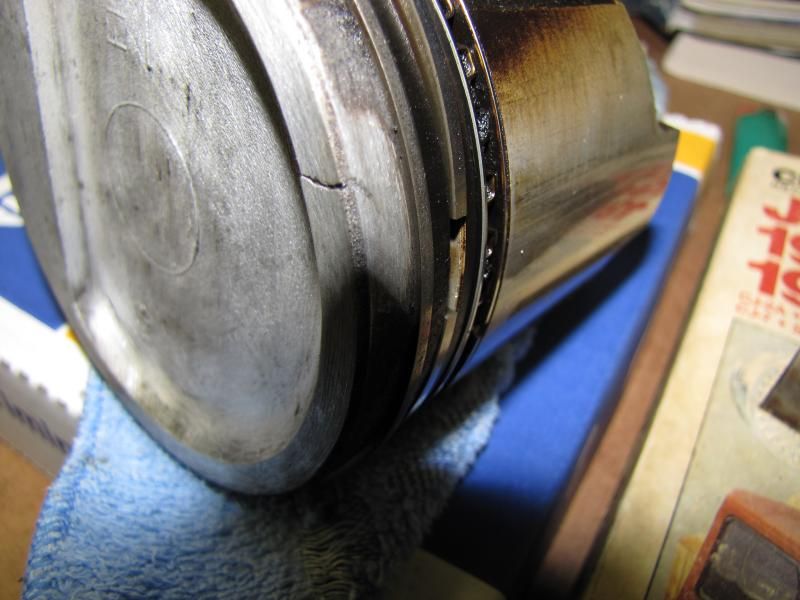

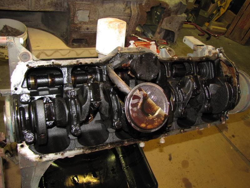

Nothing ever goes as smooth as planned. Since I pulled the head I went ahead and cleaned off the carbon from the piston tops. As I was cleaning the last one I noticed a mark on the rim which looked like a casting defect. But after further cleaning it was obvious that it was a crack. Not something I wanted to see.
1984

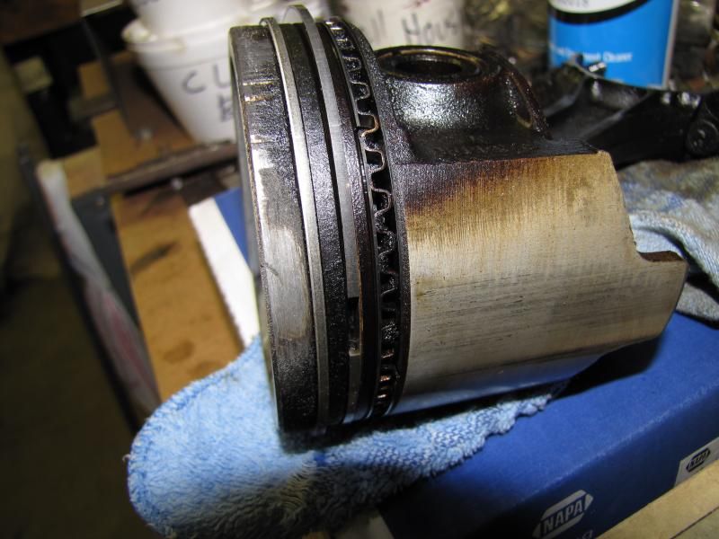

So I pulled that piston out for further inspection and it had a similar crack on the outside. So after getting some opinions on whether replacing just one piston was okay to do, I ordered a new single piston from napa. Some think the crack could have been there since birth, as AMC wasn’t real picky with parts. I didn’t want to take that chance!
2004
2007

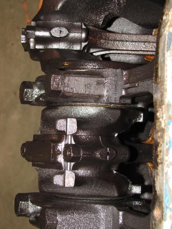

As you can see the engine is pretty carboned up but it’s not a sludgey layer, it’s pretty thin. I’ll wipe what I can but I don’t want to dislodge a bunch of it and fall in places it shouldn’t be. I was going to drain the oil and put some kerosene in it and run it for about 10 minutes, before I started tearing it down, but it never got done. The first oil change will be within 3-400 miles. There was also some sludge in the oil pan. Not a lot, maybe a ¼ cup. After draining it and running a magnet thru it no metals came out. I think it was a lot of paraffin and grime. Almost the consistency of asphalt patch but not that hard. I dug a pile out of the oil sump as well. Now I’m debating whether to replace the oil pump or not, they’re salty. I might just open it up and take a looksy, then pack it with vaseline.
1987
1996
1998

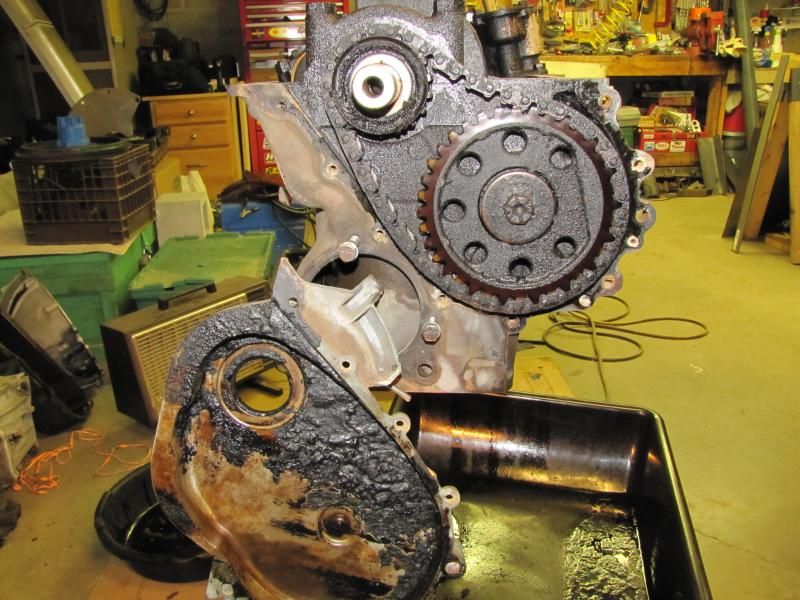

I also discovered a crack on one of the bolt bosses on the timing chain cover. It was to the outside but when I loosened that bolt it was cracked in 2 places so it just fell away. So I had to order a new cover. And wouldn’t you know, 2 of those ¼" cover bolts snapped off into the block! And mine had no cam end play spring or spacer in it. Is that normal for some? The chain and sprockets were all carboned up as well and it appeared to have a good bit of slack but I didn’t measure it yet. The nylon cam gear looked in fairly good shape yet. I got a new timing set from napa, in the napa parts line (NTP-napa timing parts) but the cam gear is in a clear wrapper that says Made in Taiwan!! Go figure

Haven't posted in a while so I thought I'd give a bit of an update. Been mostly working on engine parts and pieces, then painting and reassembly. I put in a new rear main seal while it was open. I discovered a cracked timing cover bolt hole flange so I got a new cover. (not without it's own issues that I covered in another thread "Crown brand timing cover")
Note the remnants of the original AMC Blue paint.
enginerebuild002
So I replaced that and swapped out the seal that came in it for a National brand seal from NAPA. And a new timing chain set as well.
