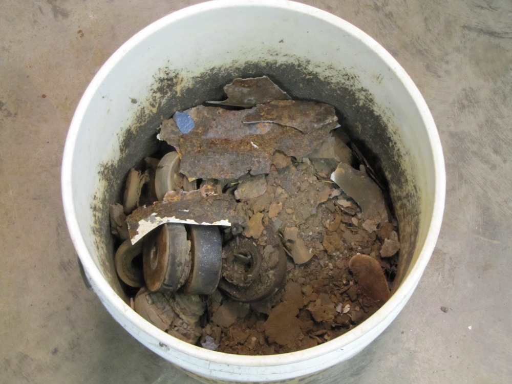

Once separated, I could then see the full extent of the cancer. And as I worked on it up to this point I just kept sweeping the fallen debris into a pile underneath. I scooped it all into a bucket and weighed it just for ****z-n-grins. Counting the body mounts I removed, 14.5 lbs. of rust fell off during my disassembly!
