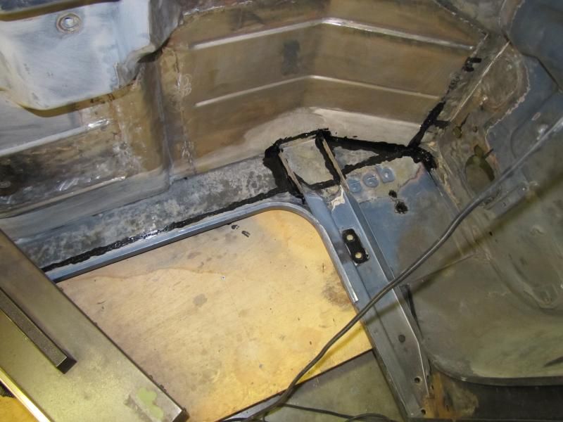

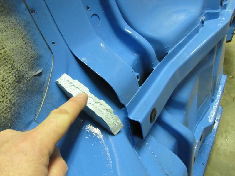

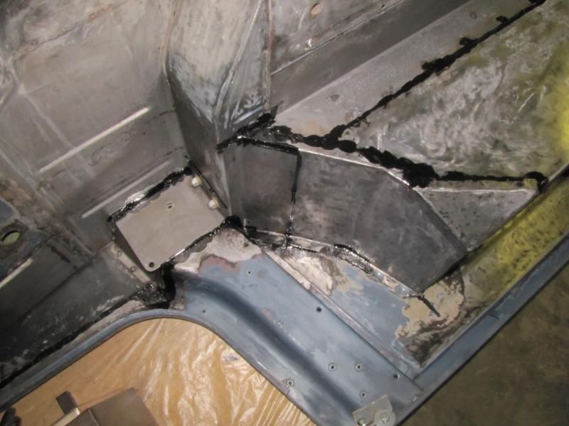

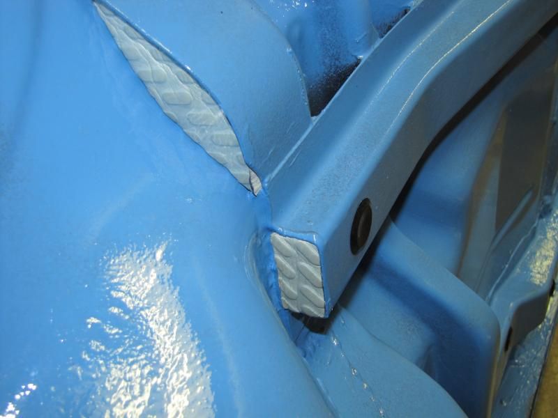

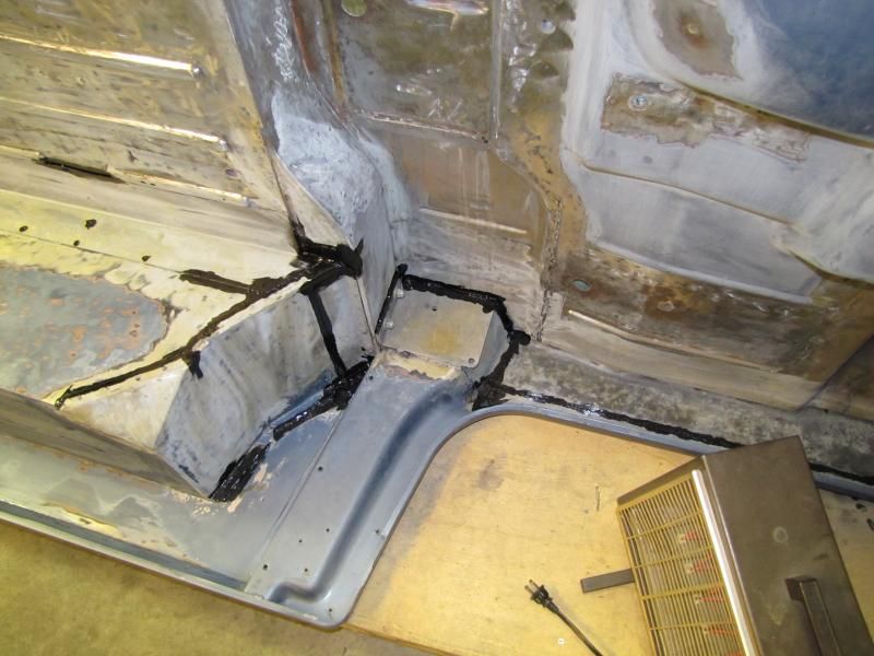

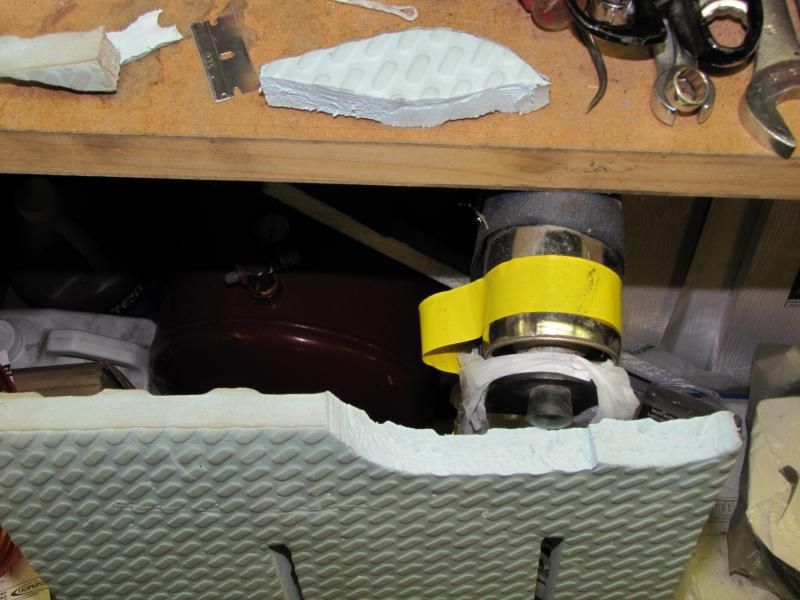

It’s been a while since I posted anything. Things have been slow with hunting season and the holiday’s, plus the weather hasn’t been very cooperative with painting or sanding. So I’ve been just taking care of little things to fill the time.
There are some voids in the body support’s design that tend to let the outdoor’s in for a rust party, and even though I caulked or painted these best I could theres two places I still wanted to plug up. One in the transverse support and one in the inboard support. I was originally thinking of using a thick coolly cup for some closed cell foam material, but then I realized the foam mats I use to lay on the concrete for knee or back padding would work perfect. It’s ” foam from one of those “fatigue” mats that I cut in half to lay on. I cut them oversized so they would “squeeze” in place and stay.
5047
5048
5051

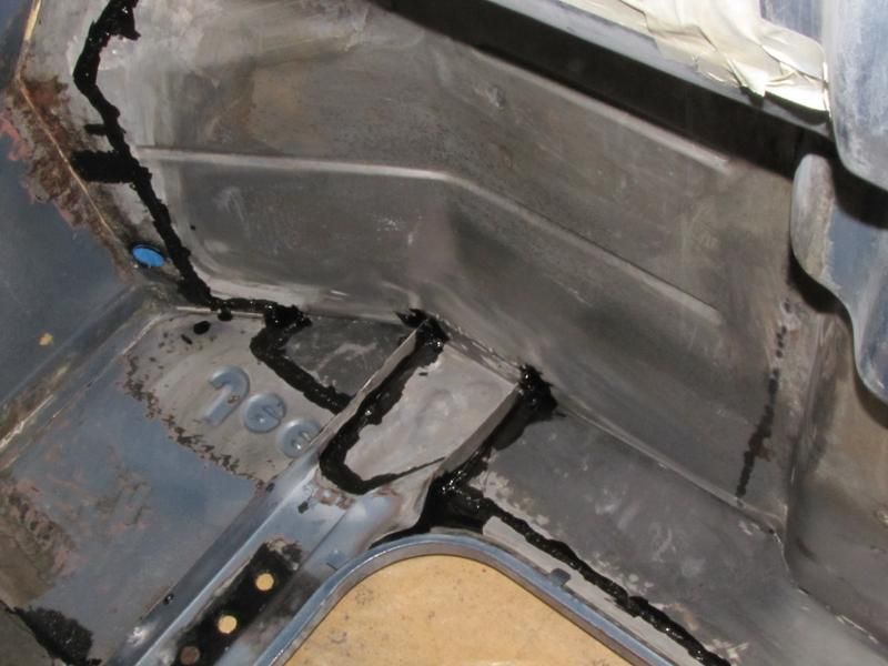

I also got a bit more etching and painting done to the tub. We got a couple short warm spells into the high 50’s so I took advantage. Painted the other side of the tubs exterior and the rest of the rear. Now the whole exterior of the tub is painted with POR except for the cowling.
5031
On the inside I took advantage of gravity while the tub was on each side and painted some vertical seams that the thin paint could seep into. Once the tub is sitting on the frame I can then paint the rest of the inside.
4979
4978
5035
5034
