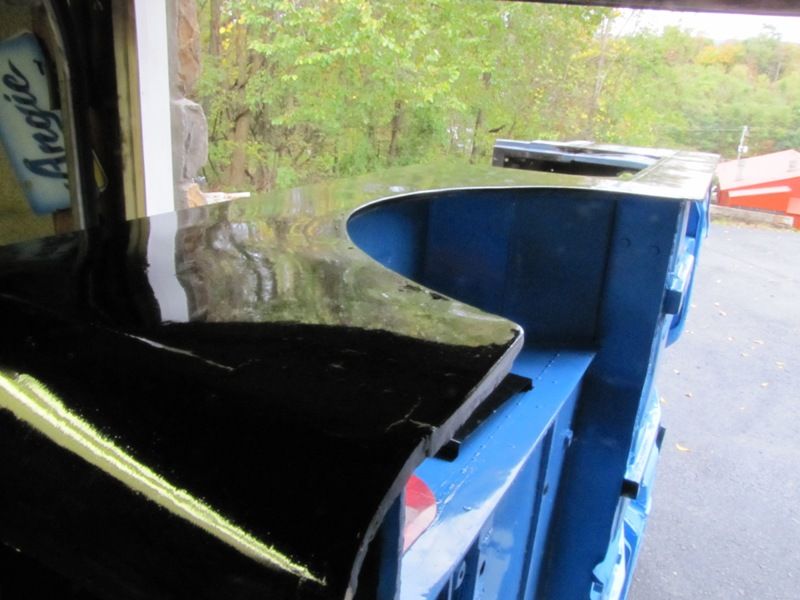

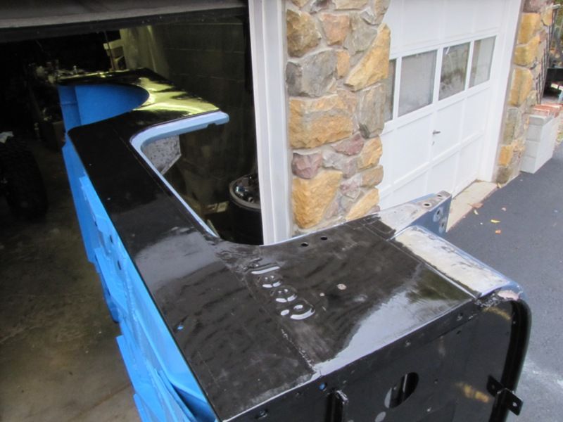

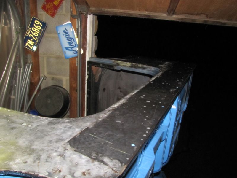

Just a few pics for an update. Not much has taken place lately other than some sanding, painting, and a little sandblasting. Since the summer weather is over I have to seize the opportunity to paint when I can so I’m doing it a little at a time to get this tub finished. I have to say that painting has been the biggest stumbling block all along the way. While POR is great stuff the prepping can really drag things along. I try to clean and etch the areas the night before I know there’ll be some warm weather the next day (sat. or sun.) so I have time to apply 2 coats.
This is hard to see but it’s wet with the etching solution which I sprayed on and then after setting a while I wiped several times with a wet sponge that I kept rinsing. Kind of hard to do the whole hose thing without making a mess or getting water where you don’t want it.
4872
4874
4883

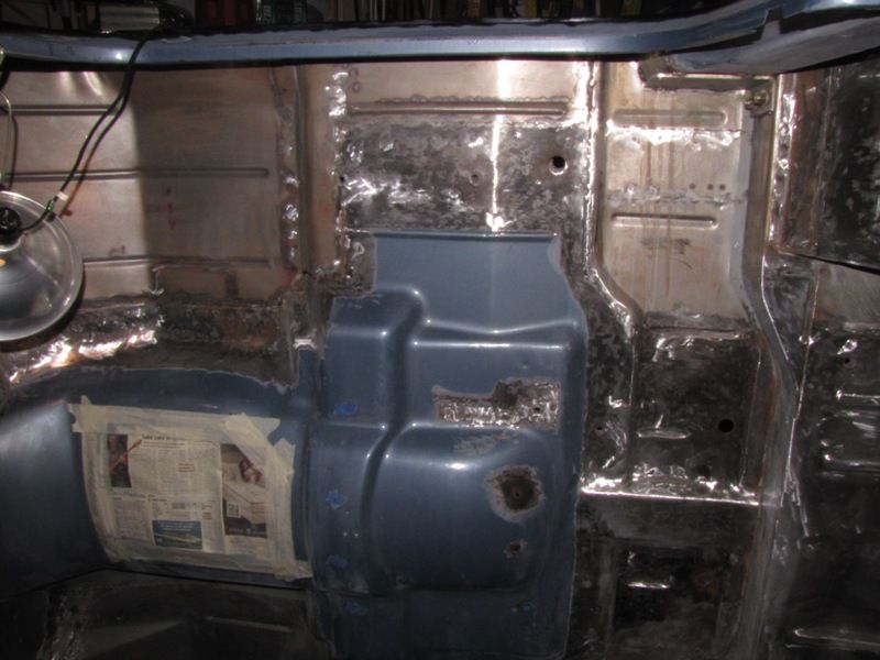

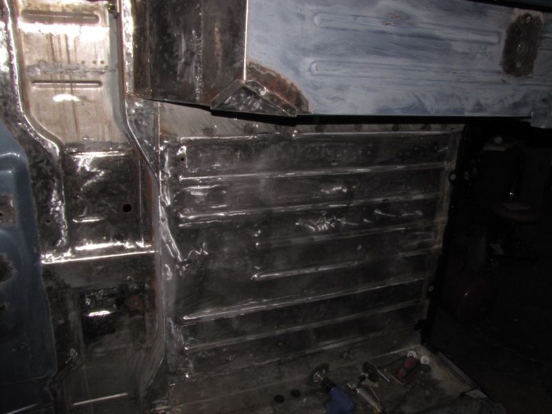

I’ve also been chipping away at sanding the old paint from the inside of the tub. I’m not going to be POR’ing the entire inside, just the horizontal surfaces and the new metal, which is almost the entire thing. I want to do the inside of the rocker before I flip it over, that way the POR can seep into the weld line of the new rocker metal.
4881
4951
4952

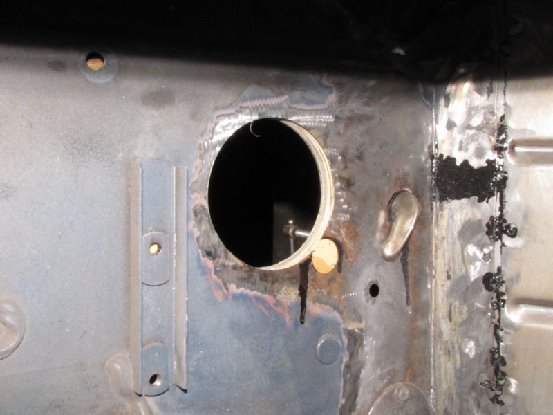

And while I’m at this point I figured it would be the right time to enlarge the blower motor hole for the upgrade and then I can paint the hole. I used a 3 ” bimetal hole saw and made a template in some plywood. Then I was able to clamp it fast to the tub to guide my drill.
4921
4922
