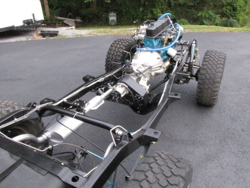

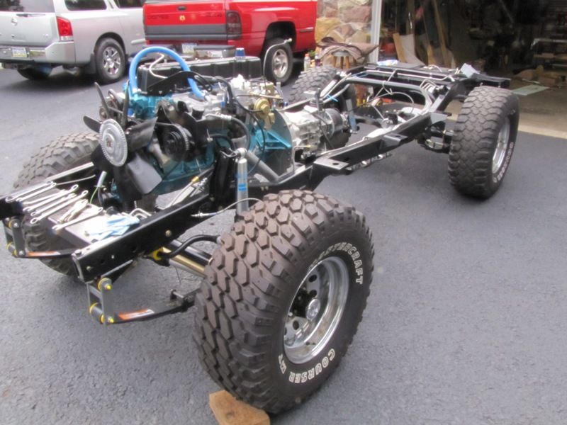

Well I haven’t posted anything in a while. Despite a weeks vacation, I haven’t made much headway (we went camping). At least it seems that way to me. And here it is, the end of summer. I envisioned being further along but it is what it is.
I did get the transfer case attached and then started hanging parts on the engine. The intake and exhaust manifolds, the steering pump, alternator, and belts.
4688
4612
4704
I could only find a header pipe for an ’83 and up (Walker 44-872) which has the stubbed port for the exhaust recirculator tube on it, so I had to plug this. I welded a shortened 5/8” hex bolt into it.
4672
Once the t-case was in I could measure some driveline angles to find out where I’m at there. I had 1.5 degrees at the t-case and 7 degrees at the axle yoke. Remember I had left my rear U-bolts just snug because I figured I’d need some adjusting once the drivetrain was in. I had to remove shims that came on the OME springs which were pointing it up too high. That took it down to 4 degrees. The next easiest thing to do was to drop the transfer case / tranny skid plate. Which I didn’t want to have to do if it wasn’t needed but it turns out it was. So I picked up some steel sleeves (3/4”x7/8”x1”tall) at Lowe’s, which are basically what some lowering kits include, and proceeded to loosen some bolts, support the drivetrain and install these sleeves. When said and done that brought my t-case yoke angle to 4 degrees, a half degree from target and good enough for me. (edit Once I installed the rear driveshaft that put it's angle at a C hair under 25 degrees.
4624
I also added my steering stabilizer. I got a Skyjacker brand which I’m told are one of the better ones out there. I like it’s small size that helps limit interference.

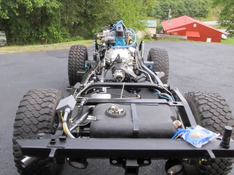

I took care of the wiring that I ran the LiquidTight tubing for. I got a Cantex NM junction box (4”x4”x2”) at Lowe’s to fit all this in and it used every bit of it. Their nice because they have no holes so you can drill one wherever you need it. I have 2 relays and 2 fuses in it that will take care of my rear aux. lite and waterproof power port that I mentioned earlier. The light is mounted (you can see it in the one pic) but I’m waiting for the bumper / spare carrier to go on to mount the outlet. I might put a light on the other side too.
4710
4714

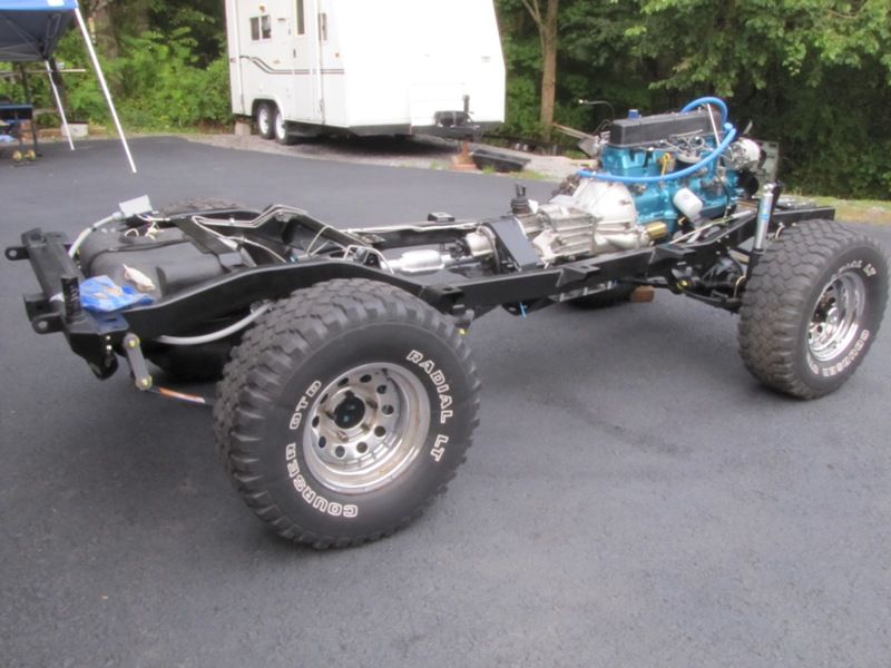

As April Wine’s song goes, “she’s a roller, a high rollin’ baby she is”. I couldn’t wait till I got my new tires to get her some sun, so I threw her old shoes on. Well the left front is new (it was the spare) but all the wheels are old. Damn, I must say she looked good sittin’ in the natural light.
4807
4812
4803
4816
She kind of looked like some mechanical bug out of a sci-fi movie from the rear. I added the other aux. backup light on the pass. side, which is a close match to the Cepek light I got back in the 80’s. On the drivers side I had an extra bolt that TDK had welded to the frame, which I assume the larger 21 gal. tank utilized; which worked perfect for a light mount and kept it up high. For the pass. side the only thing I could do (simply), short of drilling a hole in the crossmember, was to use the remaining threads from the skids mount bolt which was about 3/8”. So I got a 5/16” coupler and cut down the carriage bolt enough so that it would bottom out against the skid bolt. I loctited the coupler just so it couldn’t loosen but theres no way it could spin off because the bracket held the carriage bolt in it’s square notch and the light held the bracket from turning. The light has very little adjustment sideways due to the tank being right behind it.
4796
4772
4769

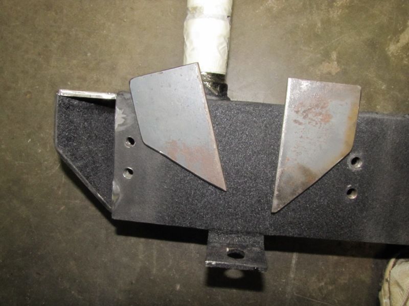

I put my rear bumper on but first I tried to get rid of the textured coating that Smittybilt puts on their stuff. It’s powder coated underneath the texture coat so I wanted to just knock down the texture. I figured I’d hand sand the majority off, then spray it with self etching primer for a knit coat and to fill in the low spots, then I sanded it again enough to knock the primer off the high spots but keep it in the low. Kind of like a high build primer does. Well it looked pretty good… until I painted it with BlackCote. It could’a used a bit more sanding! But it isn’t too bad, as long as your not looking for it. I wanted it to match my front bumper which is identical except it’s a ProComp and it’s powder coated gloss black. The tire carrier is going to stay textured black and I left the hitch tube stay the same too.
Another thing that needed done to the bumper was to fill in the ends that for some reason they left open, which would work great if you wanted a snow or mud scoop to fill the bumper with,…. but I don’t! So I welded it shut with some 3/16” plate. I only welded the top and down the sides halfway so that if water got in it could drain out but it wasn’t going to collect dirt.
