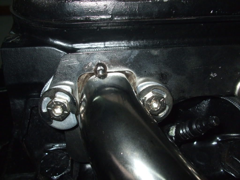

My first ever set of Stage 8 have been great for me so far.
I have removed and installed the headers since that picture was taken. So yes, I got the one on the left clipped on all the way.

Coiz,
I've never seen those stage 8's. The one's I ordered would not fit between the port tube and hole. I'll need to find those! Love the stage 8 stuff!
Thanks for posting that!
Edit: these are the one's that wouldn't fit my headers: http://www.summitracing.com/parts/st...merican-motors
Edit, Edit: I see your flange has more space than a 304, so those probably wont work either...oh well.

I did have to grind and trim a few of the tabs to fit, they didn't all have that much room. They will obviously contact the header at some point if the bolt does start to back out since that's how they work.
I'd say get the kit, install the bolts and torque them, drive it around for a few hundred miles, torque them again then install the locking stuff. Just modify each locking tab so they fit and try to contact the tube as soon as the bolt tries to turn counter clockwise. Just keep them numbered if you ever have to take it back apart. Who are we kidding, its a Jeep, your gonna have to take it back apart.
