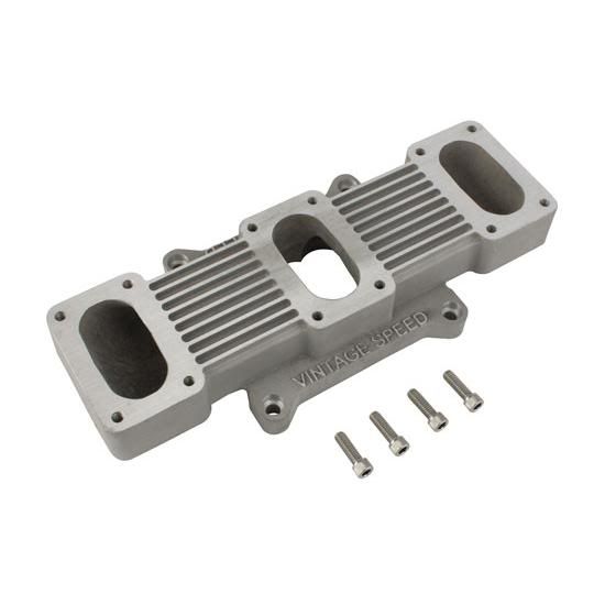

I know this is an old thread, but I found this today on the Speedway web site....
Jon B
