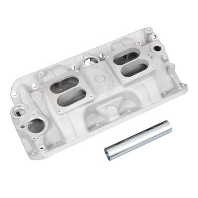

Does anyone make a intake like that? I've seen the dual high rise for AMC V-8s, but never a 6 pack. It would be interesting to see.
http://store.summitracing.com/largei...ofy-5919_w.jpg

if i hav my reasearch right the bolt pattern for a 304 is the same as a 360, 390, 401(not too sure bout the 401) so if i find one for that it should fit my 304

Its the pre-1971 401s that have a different bolt pattern.
