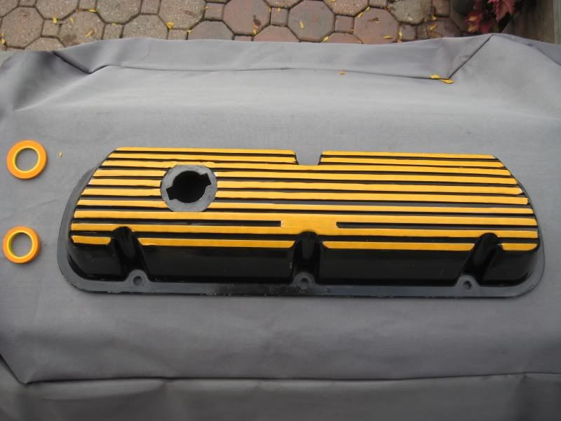

I repainted these covers to match the blue. There is this real thin 1/8" masking tape that works good for this kind of thing. Hopefully I start actually working on the motor soon

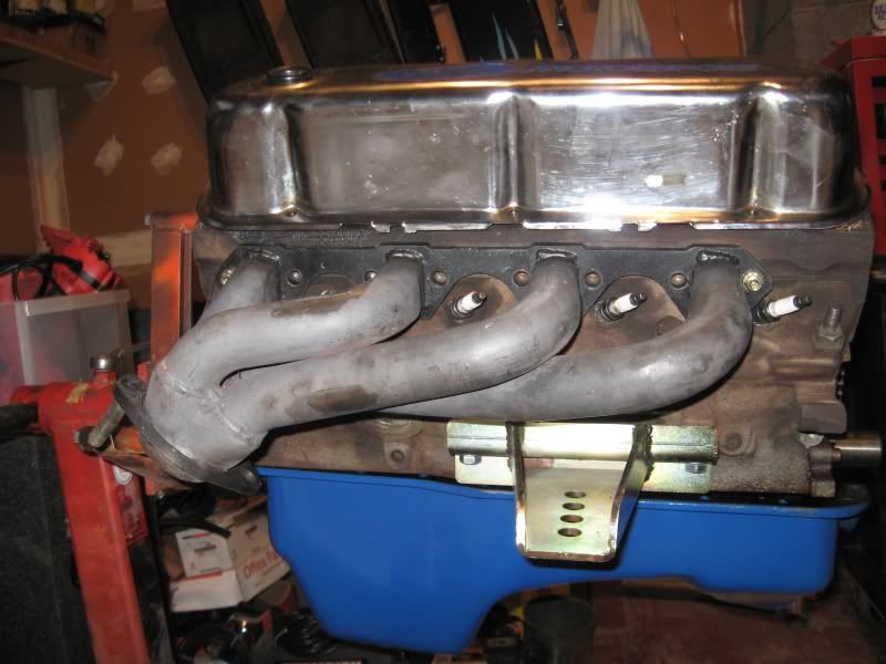

Thanks Jim. Today I just bolted on a header to make sure it wouldn't get in the way of the engine mount. Do you guys know if these Mustang Shorty headers will be ok or do they interfere with Jeep's firewall? thanks

I have a set of those headers Rob and it's not the firewall that is the problem. The one on the driver's side on mine dumps too close to the frame to allow you to hook your flanges on it. In my case they didn't work. But your headers and mine may not be the same either, guess you won't know till you have it sitting in there. Always something to consider aint there my friend.

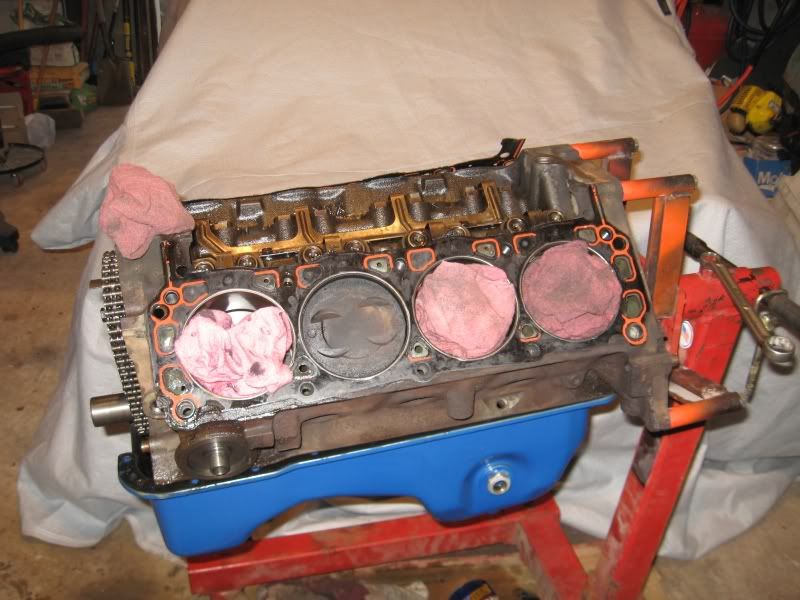

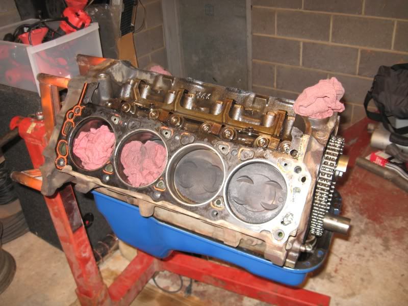

Thanks Jim, that's a good point. Today I pulled the heads off. Next to come off will be the timing chain and cam. Do you guys have any ideas on a good low rpm cam? thanks
I believe that the driver's side also dumps right in the middle of the clutch linkage.

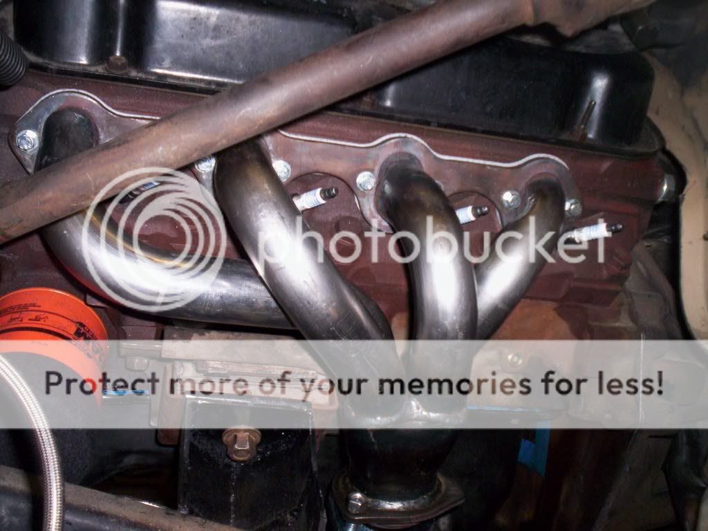

Top are center dumps I picked up from Summit (SUM-G9063 SBF BLOCKHUGGER) for $130. Worked good. Hint, if you use these double check d side header to motor mount. Had an exhaust leak and finally had to grind down a portion of the MM.
Middle are OEM mustang - If using the mechanical clutch won't work. Heard hydraulic allows more room.
Bottom are off F150 - Same thing as OEM
Driver side header.
Pass side header. The starter is within 1/2" of the header. Wrapped with insulation to ensure it don't burn up.
80 CJ7 5.0 Dual Exhaust, T176, D300, D30 w/ true trac, AMC 20 w/ ARB 4.56 gears, York OBA, Hydroboost

did you have any starter clearence issuses with those headers?
Yeah it was within 1/2". No problems taking it in or out. That's why I wrapped the starter in that blanket. So far so good.

ok it looked like you may have to remove the header to replace the starter.. i like thos headers and the price not bad.. I may swap mine to those

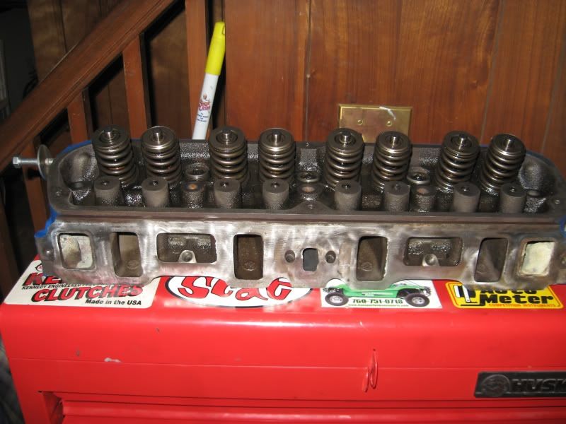

post #105 of 566 Old 10-11-2010, 10:57 AM Thread Starter
CJ7ROB
1986 CJ7
Location: Whitehouse Stn,NJ
Posts: 1,459

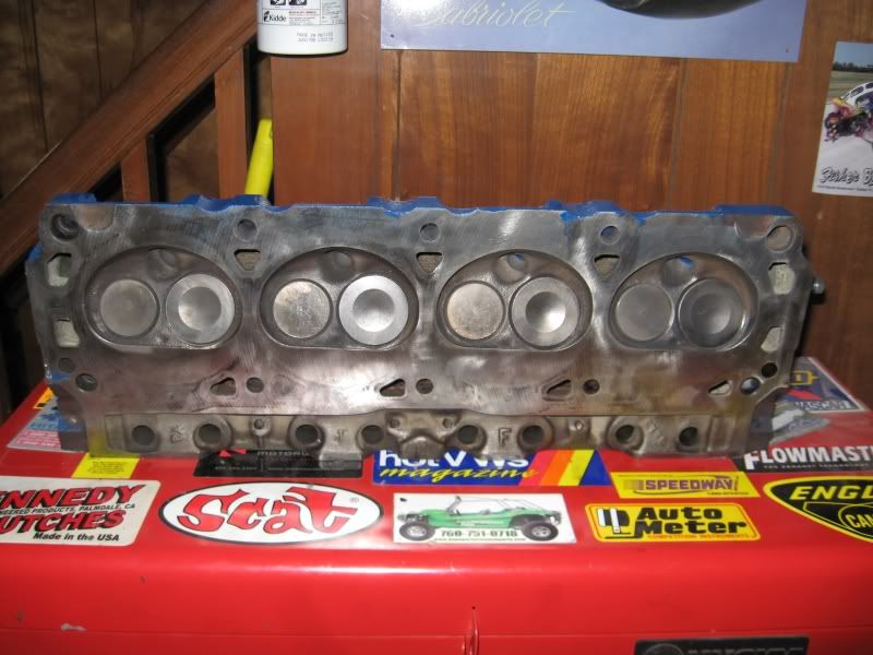

Cleaned up one of the heads and painted it.
CJ7ROB is offline
