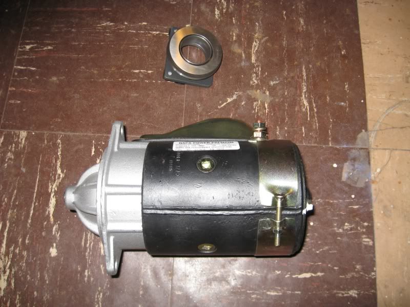

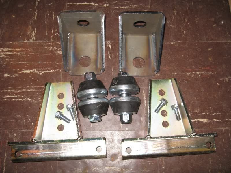

Got a new starter, TO bearing and the engine mounts by Advance. Got the Advance mounts from a JF member for $115 shipped and they are new so I was happy with that.

post #62 of 568 Old 08-30-2010, 03:55 PM
Jim1611
Jim1611's Avatar
Posts: 7,315
Parts look good. You're fixin to get some major things accomplished!

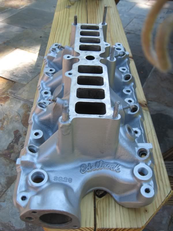

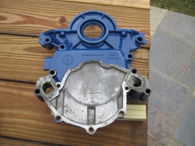

Started to clean and paint up some of the engine parts. Zinc coated the oil pan bolts. Do you guys plug up that oil sensor hole on the side of the oil pan? thanks

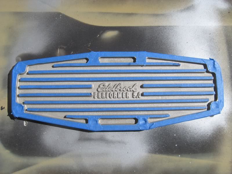

Decided to paint between the ribs on this piece.

post #65 of 568 Old 09-14-2010, 03:44 PM
Exposed
Exposed's Avatar
1981 CJ5
Location: Katy, Texas 77493
Posts: 588
Cj7rob, looking good man... I started out with the same intake setup I picked up off the craigslist.. I notice the front bolt has been welded up from where it was maybe broken... Mine was glued back together on that same stud. That must be a weak spot in their design..... I came across a good deal on a Cobra one and went that way.... You are making good headway....

post #66 of 568 Old 09-14-2010, 03:49 PM Thread Starter
CJ7ROB
1986 CJ7
Location: Whitehouse Stn,NJ
Posts: 1,461

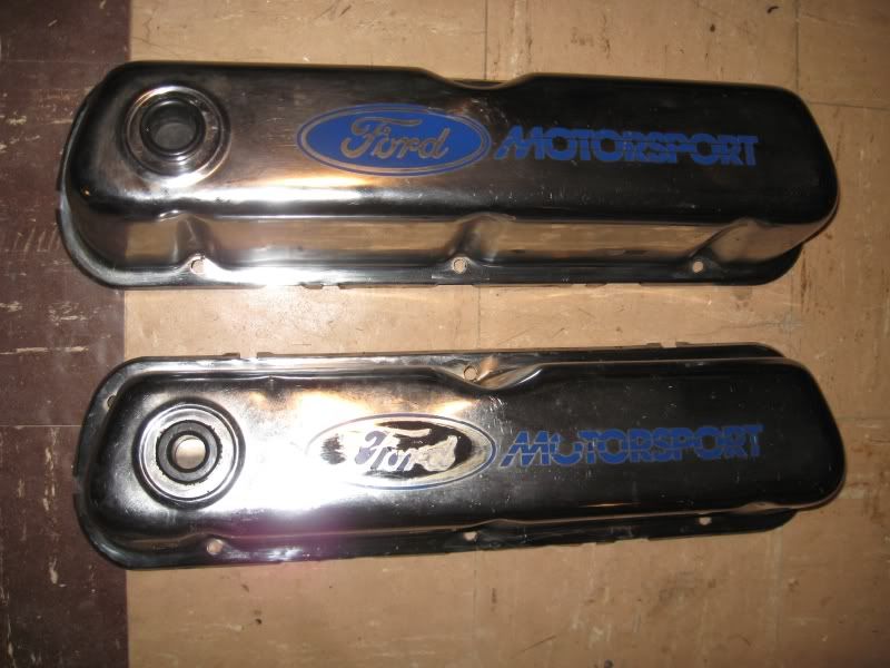

Thanks Calvin, yea I noticed someone welded that stud. My buddy told me it was the guy he got it from, they did a decent job with it and it didn't leak. A Cobra one would be a nice upgrade down the road. I was thinking of using these covers that came on the motor but the stickers are peeling. I may get some new stickers or leave them off.

You're getting allot done. Looks great too. The paint between the ribs looks good too. I see you've got your flywheel, what tooth is it?

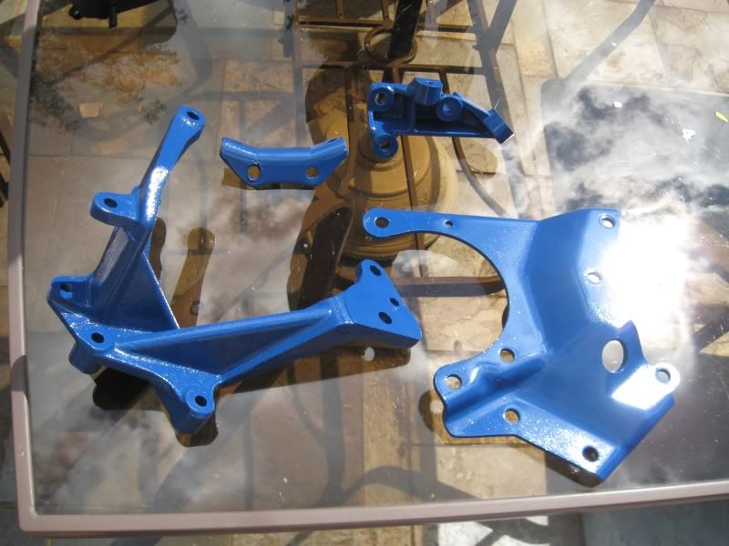

Painted up some of the brackets and the fan. Next I gotta pull the pulley off the PS pump

Parts look very good! I like the color.
