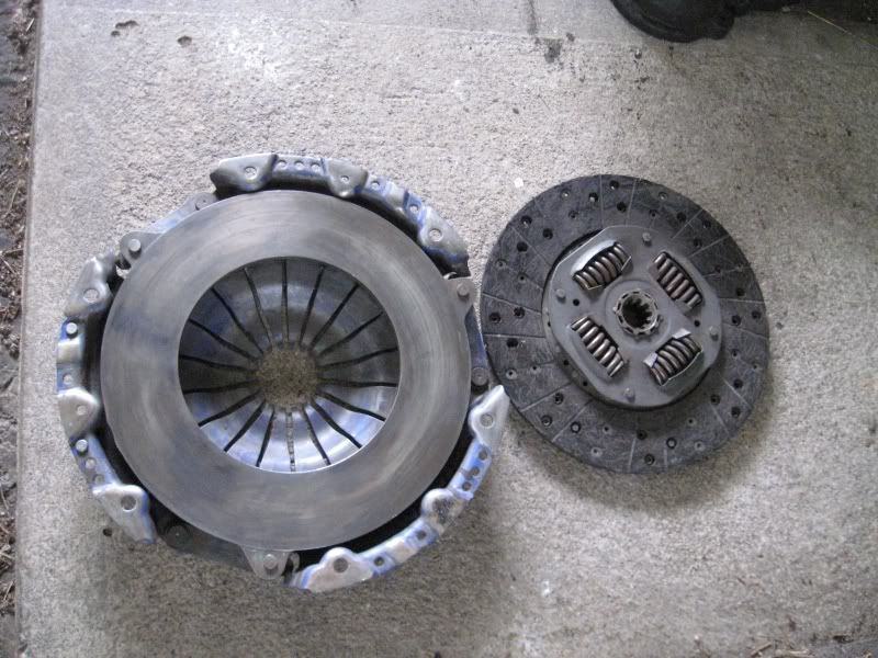

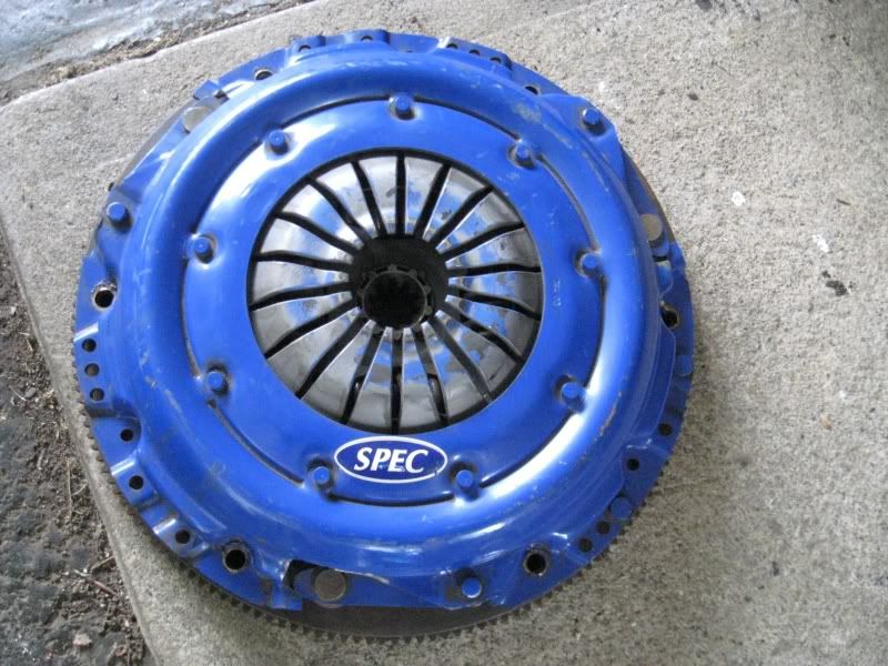

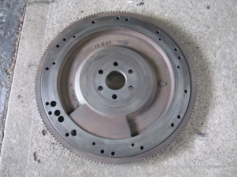

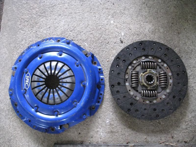

Today I went to Collis Truck Parts in Northampton, PA and I picked up the flywheel for $60 and the Ford PP and GM clutch for $40. The clutch is in great shape but I still may just get a new one. They cleaned up decent with some Brakeclean.

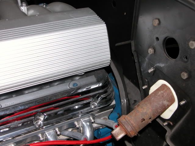

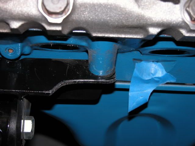

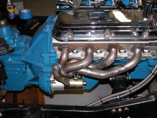

M.O.R.E. 'bomb proof' mounts. They bolt in, move the engine forward 1" and slightly 3/4" to the Driver's side. This yields clearance for the rear of the head to clear the firewall:
You may need to 'trim' them to get header clearance, depending on what you run:
You may or may not run into problems with the skidplate/crossmember alignment. I did, but others did not. I opted for an aftermarket 2pc crossmember and skidplate from TDK:
Take the flywheel to a machine shop and have it resurfaced. Trust me, you don't want to take it all apart once you put it in the CJ. I would also just spend the $$ and get a new clutch/disk/TO bearing/Pilot Bearing for the same reason. JMO.
You may run into problems with the OEM Ford clutch fork and the frame mounted combination valve. You can relocate the valve as I did, or modify the clutch arm:
The starter selection has more to do with the bellhousing/flywheel combination you are using, rather than the year. With Fords, the bellhousing/flywheel/starter must all 'match'. You've got a bellhousing for a 164t flywheel. You need to use that flywheel, and a starter for that combination. I used a PMGR style on my swap rather than the OEM style. Picked it up from a local remanufacturer for under $80 without a core. This will give you a bit more clearance for headers (depending on what you use):
