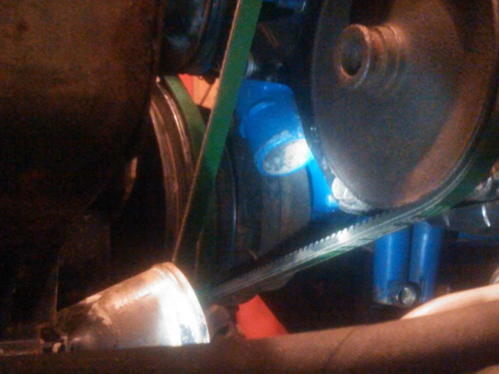

I need a lower radiator hose for my 302 in my cj, I am adding power steering and the steering pump belt is in the way of the radiator hose. There is about 5". Between the radiator pipe and the steering pump.. I have found a few part numbers online but the pictures from autozone.com dont look like they will clear the belt. Can any one help me with this?

Petey...your running a v belt....I run a serpentine belt so I could only suggest you check with the older 5.0 (classic mustang sites) for an appropriate lower hose.
Try Napa #7133
