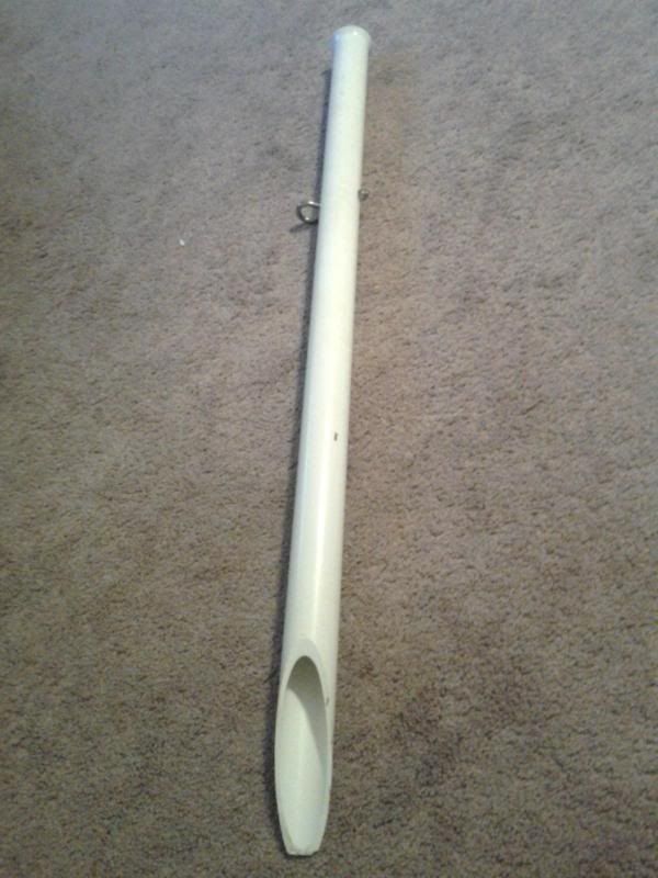

Put this drop pitman arm on last night. Its nice b/c it doesn't have the index marks which allows you to put it wherever you need it. I put it straight back with the wheels straight, so now there is plenty of meat in the sleeve.
Going surf fishing next week in Bethany Beach, DE so I made this sand spike. Any surf fishing pointers?
