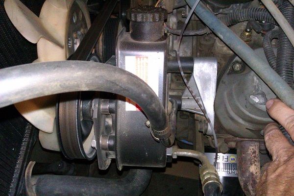

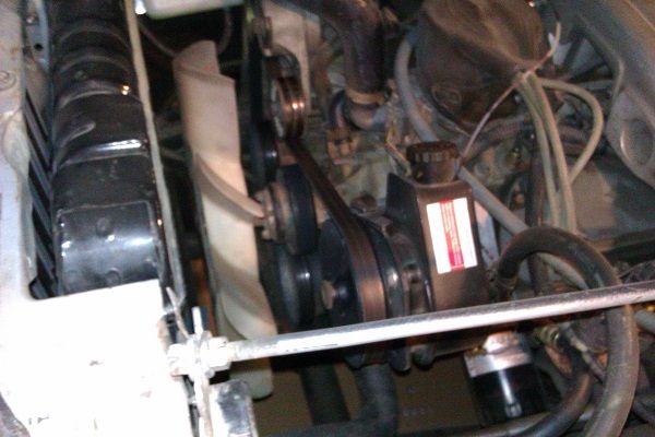

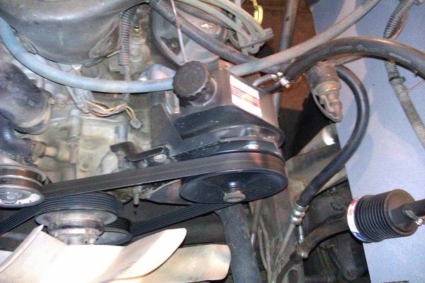

Here are a few pics of the Saginaw pump (dirty motor but that's the way I roll). Also note that I'm using an A/C eliminator bracket (Ford Racing part # M-8511-A50) so the pump sits where the A/C would normally be. Originally used the Saginaw pump with the factory A/C still installed (it works fine), but decided to pull the A/C to save a little weight;
