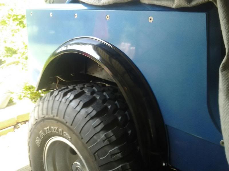

Got the rear flares on
I need 3 more of these little plastic nut things that hold the flares on. Anyone have any extras laying around? I can send $$ thru paypal, thx.

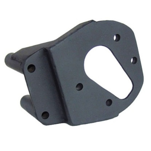

Welcome to the world of Ford power steering pumps (ear plugs are available at the door). I put up with that noise for 10 years (new pumps last 6 months if your lucky before they start to whine). They're just not upto the forces that big tires and CJ steering require. I finally got tired of people giving me the stink-eye in parking lots so I swapped in a Saginaw pump. Here is the mounting bracket I used for the conversion;
http://www.wildhorses4x4.com/product...w_pump_bracket
Thanks for the info and link. Did you have to buy their pump too or can you use any Saginaw pump with a serpentine pulley?

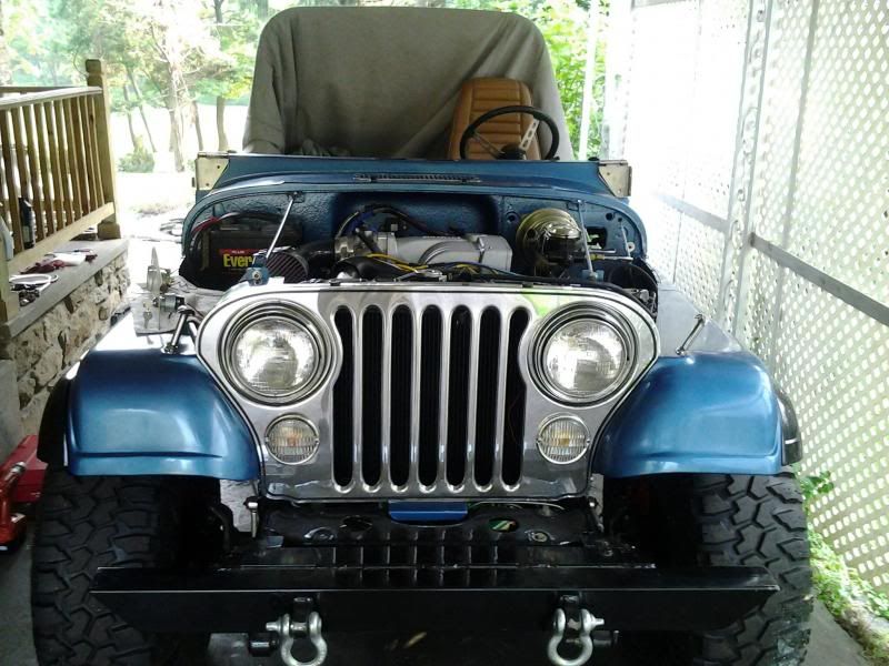

Just about wrapping up the paint work. Still need to do the other door, but I want to keep it together so I know how to assemble this one.
CJ7ROB is offline

Most any Sag pump from a truck will work, just make sure the reservoir is clocked as far toward the driver side as possible. I used a rebuilt pump for a 91 Blazer 350 (Cardone Part # 20-7940F)and a new serpentine pulley (Dorman Part # 300-020). Way cheaper than buying new pump from WH (and a lifetime warranty).
